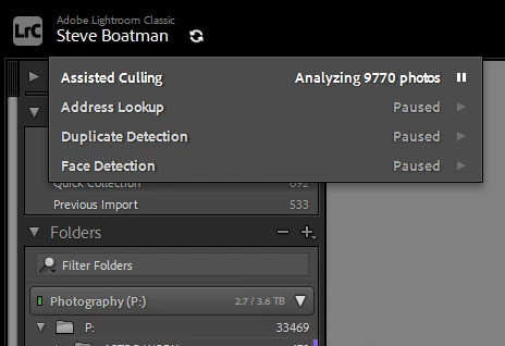

    Assisted Culling → “Automatically analyze all photos in catalog” -- is causing LRC to crash while running. I am seeing others complaining of the same issue on Reddit.
    Turning Assisted Culling → Automatically analyze all photos in catalog off for the catalog fixes this problem entirely. [Did not test Analyze selected source while panel is open.]

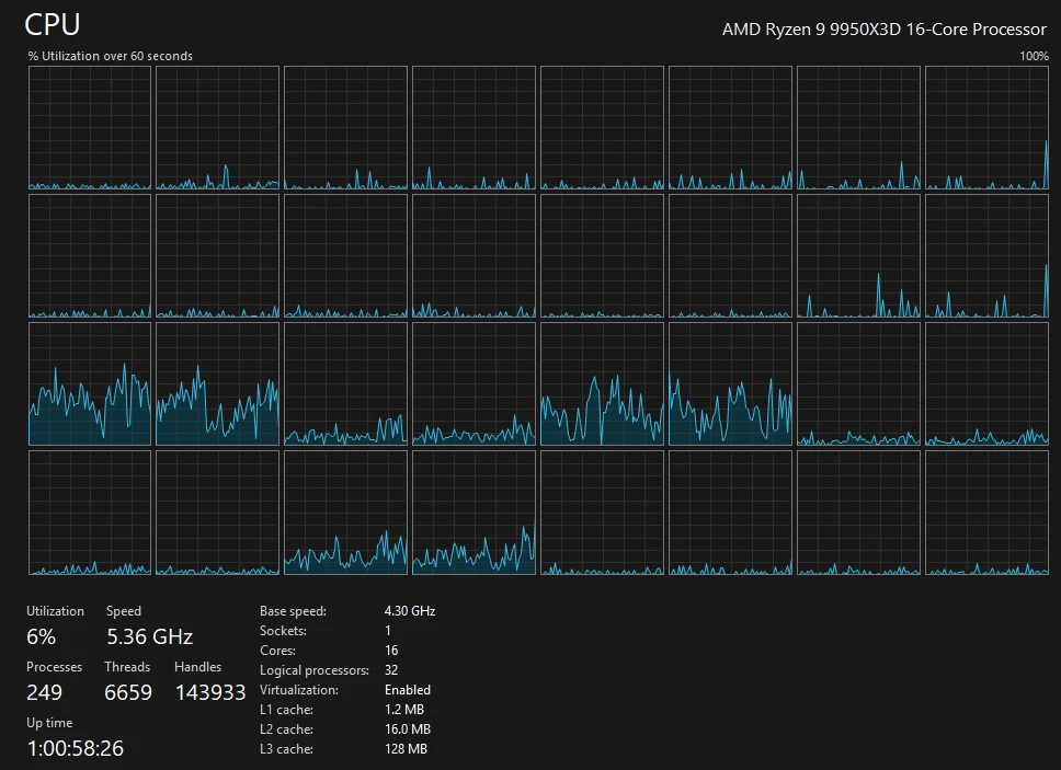

    CPU is not being leveraged heavily, and core spread is oddly minimal:
    Barely using 9950X3D, low utilization. May be due to background processing.

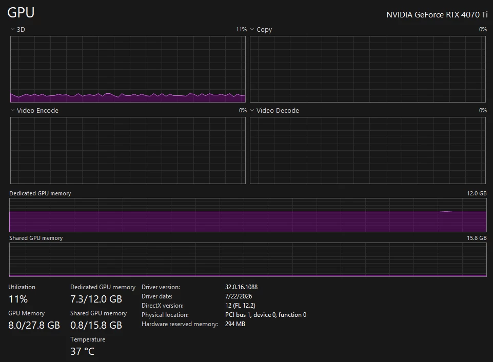

    Furthermore, not heavily taxing on GPU either:
    Low GPU utilization. Using nVidia Game Ready driver, not Studio driver. RTX 4070 Ti

    I recently enabled Assisted Culling Analysis after upgrading to 15.5, and I’m noticing silent crashes. Disabling the analysis process seems to prevent crashes. The analysis is actually making progress, as I have tens of thousands of photos, and I see the number ticking down. Sometimes LRC only lasts a couple minutes, sometimes it lasts longer (going on 10 minutes as I write). I also noticed that my GPU spins up just a little (not 100%) in cases where a crash ultimately comes (though it also spins up other times without issue). I would guess that this behavior might be consistent with a specific media item triggering the crash.
    Nvidia 4090 on Windows 11.
