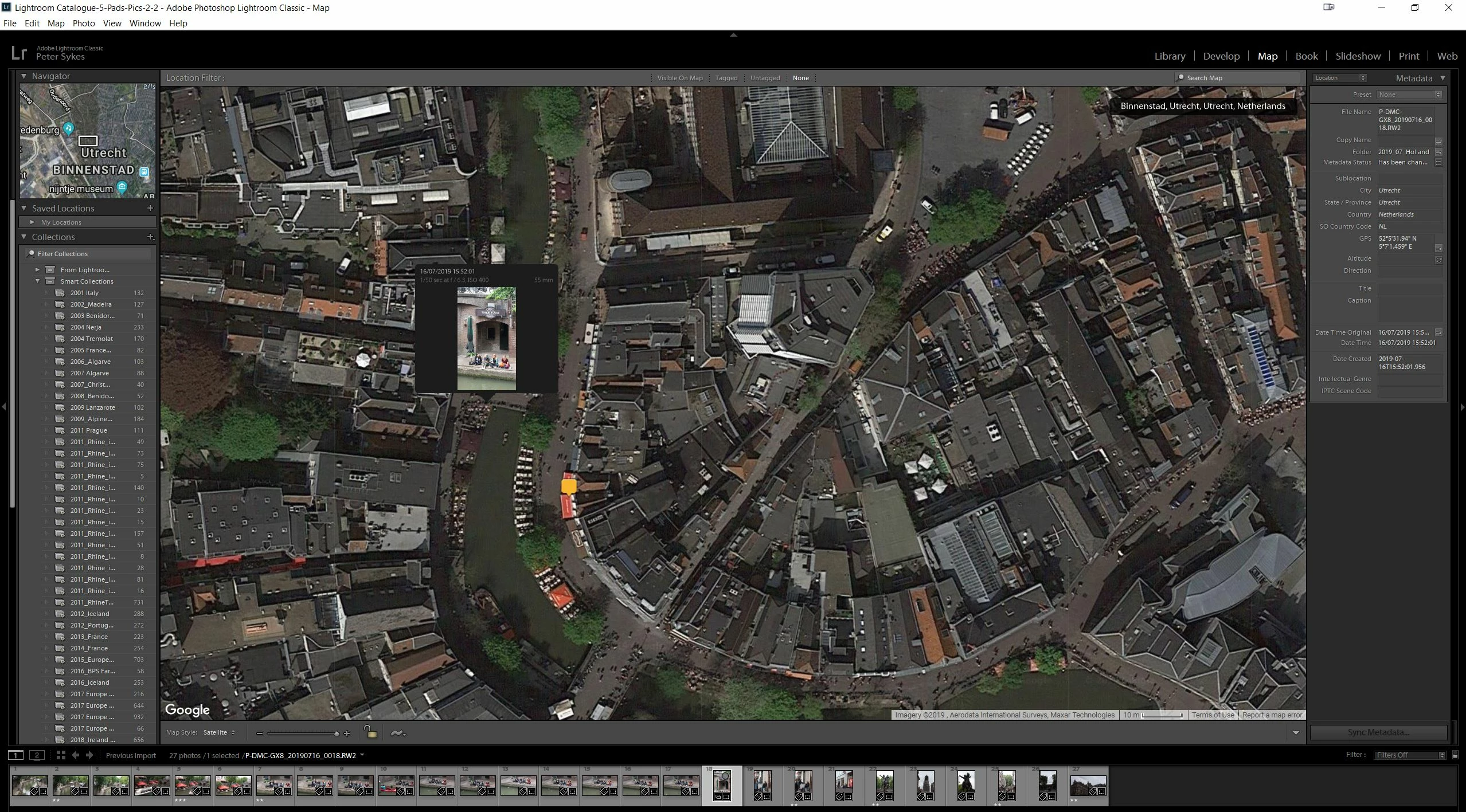

Aug 14, 2019 3:07 PM UTC
This is the same as -- Label shifted in Map Module in Lr Classic version 8.4
Which was posted after mine. I have insert a screen shot.
Peter
