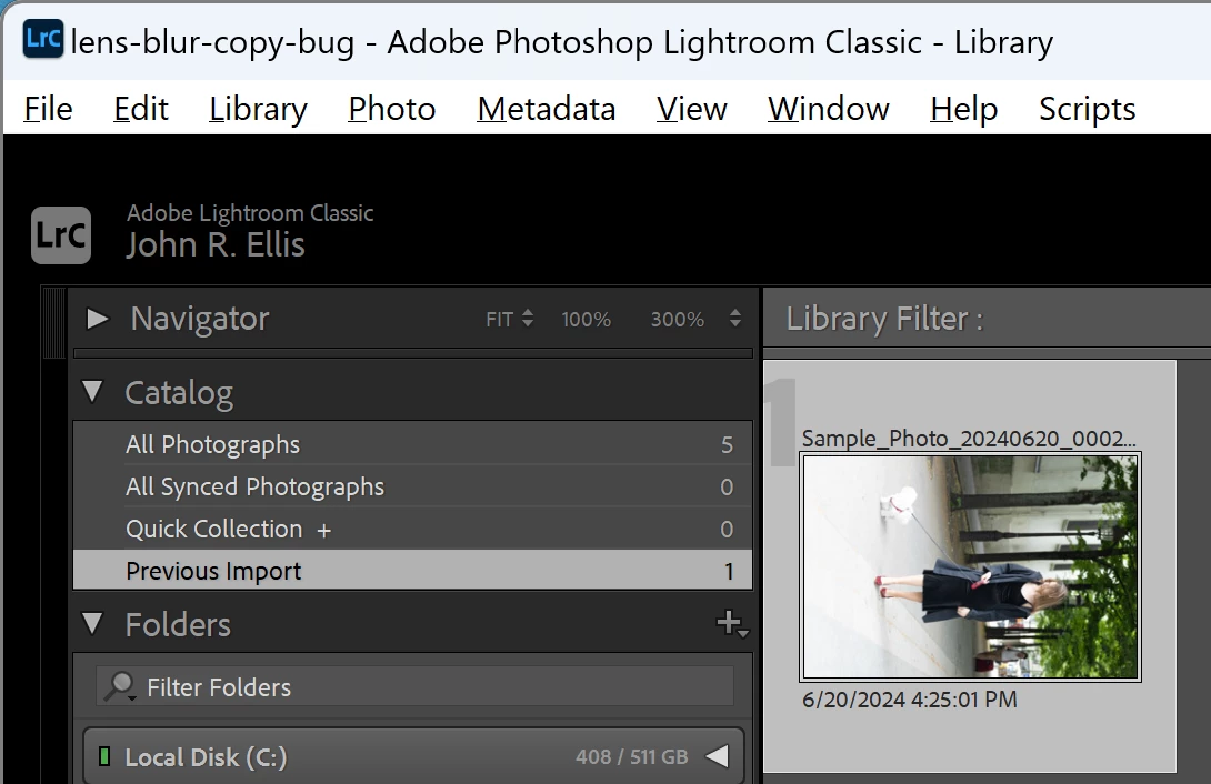

Brush strokes made with the Remove tool appear in the wrong place on a portrait image, rotated 90 degrees counter-clockwise. This occurs in LR 13.4 / Windows 11, but it doesn't occur on Mac OS 14.5.
To reproduce:
1. Download and import this photo:
https://www.dropbox.com/s/ko89pejpmicyqie/rotated-remove-brush-bug.2024.07.01.CR3?dl=0
 Observe that it hasn't been rotated to portrait mode :
2. With Exiftool, observe that the camera has recorded landscape orientation:
[EXIF] Orientation : Horizontal (normal)
3. Do Photo > Rotate Left.
4. In Develop, open the Remove tool and select Remove mode.
5. Brush anywhere on the photo and observe that the brush strokes appear on the wrong place on the iamge, rotated 90 degrees counter-clockwise.  See the attached screen recording.
6. Select the other modes (Heal, Clone) and observe similar misbehavior.

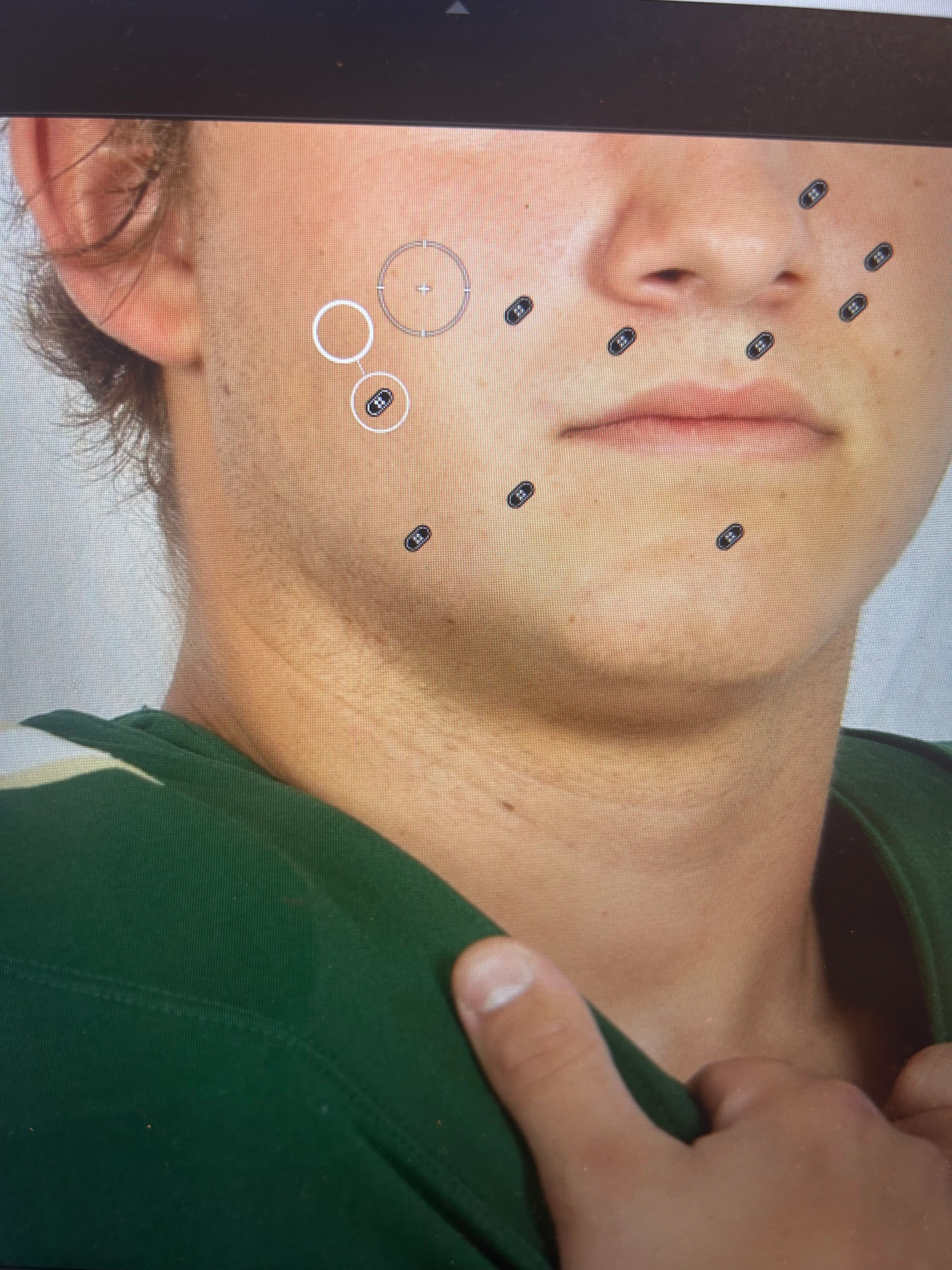

Okay, a quick update. I just worked through 20 photos of football players and what I discovered is that as I moved from one photo to the next, the cursor radius increases from the size I had on the previous photo, but the actual size that is sampled is smaller than the cursor indicates (it was whatever size I had on the last sample of the last photo). If I rotate my mouse wheel one notch, it reduces the cursor radius to one notch smaller than the size I just sampled on the last photo. From that point, it stays the correct size for the rest of the time I am working on that picture, even if I change the size (again, using the mouse wheel). Below is a screen shot to illustrate. You can see that the cursor size is larger than the most recent spot that was "healed," but that is the size that it was when I clicked to heal that spot. Once I resize the cursor, it stays the correct size until I move to the next photo, and then I have to resize it again to get the cursor and the actual sample size to be the same. It's definitely better than it was before, but still not ideal. Note: all of these photos are rotated because they were photographed vertically.

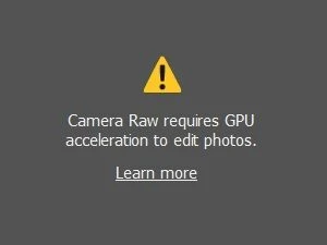

I have an old graphics card. "Intel HD Graphics Family" on . I have the following message when I try to open in CameraRaw. Is there still a way  to try your fix?
By @TwistedRealm
I think you are asking about Adobe Camera RAW as used in Photoshop. Can you verify if you get this issue in Photoshop, or were you using Lightroom Classic.
Also, your issue is in no way related to the subject of this posting, this Bug report.
Please create your own posting. I would recommend that you post it as a Discussion. In the Photoshop community if you are using Photoshop. In the Lightroom Classic community if it is actually Lightroom Classic.
You might want to view:
When you create your post, please include as a minimum:
  • Adobe Product and Version Number
  • Operating System in version number
  • Your error message
  • Computer hardware information, CPU, RAM, GPU make/model, VRAM, GPU Driver number
  • Any additional screenshots that might describe the issue
Oh, and for that Dell Inspiron 7537, looking at on-line Tech Specs. It appears it should have an Integrated Video controller, Intel HD Graphics 4400, and a Discrete GPU NVIDIA GeForce GT 750M. Can you verify. The error message is probably about the Integrated video controller.
