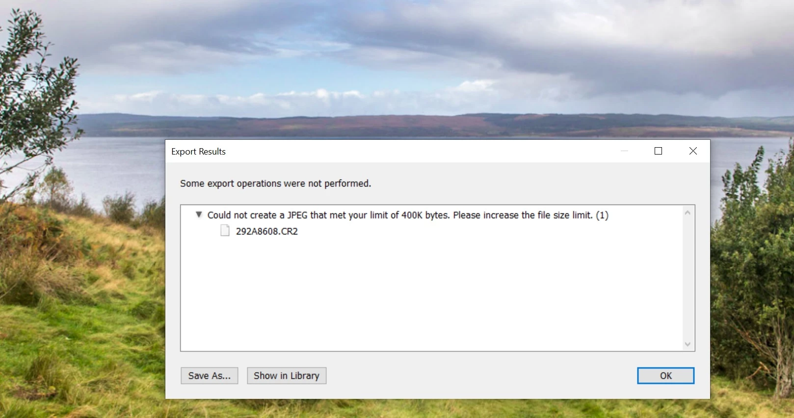

I've been asked to report this as a bug in Lightroom Classic v11
When a Select Sky mask is added, and 'All Metadata' is selected for export, an error message is generated, screenshot attached. This forces the user to choose a larger file size that may be desired in the circumstances. If a different Metadata setting is chosen, the problem does not occur.
It seems that Select Sky and All Metadata have a compatability issue.

Fixed for me too for several tested file sizes down to about 200k, which is fine - thanks!
Rikk Flohr-Retired
Adobe Employee
December 16, 2021
Fixed in 11.1

This should have been fixed in the 11.1 update released earlier this week. Can anyone here confirm that you are no longer seeing the issue?
