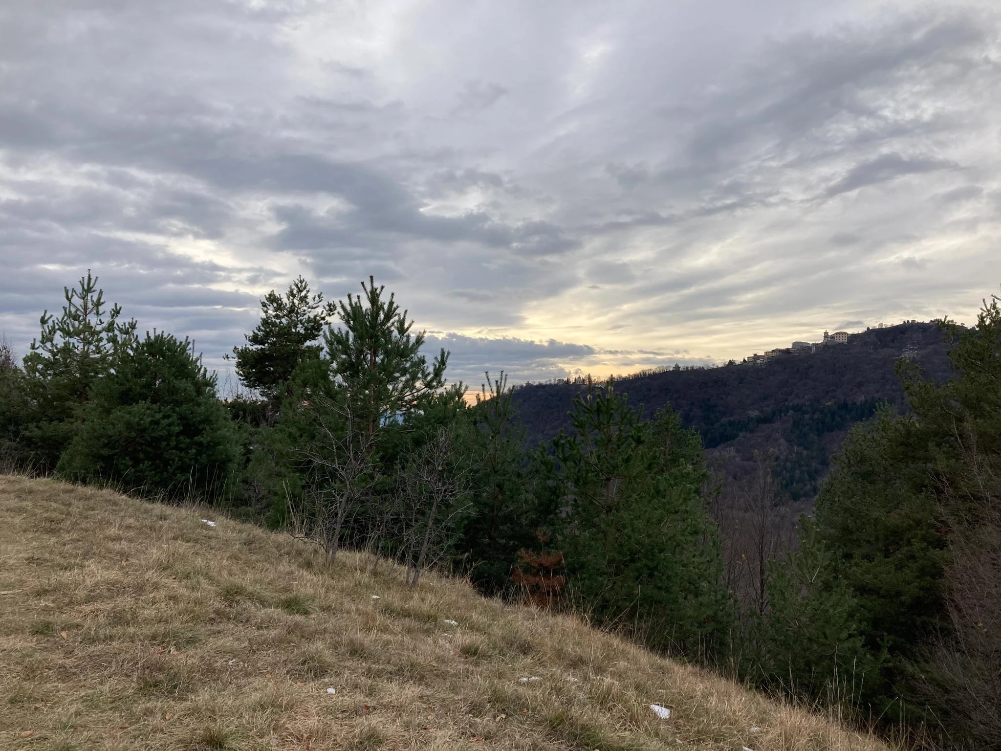

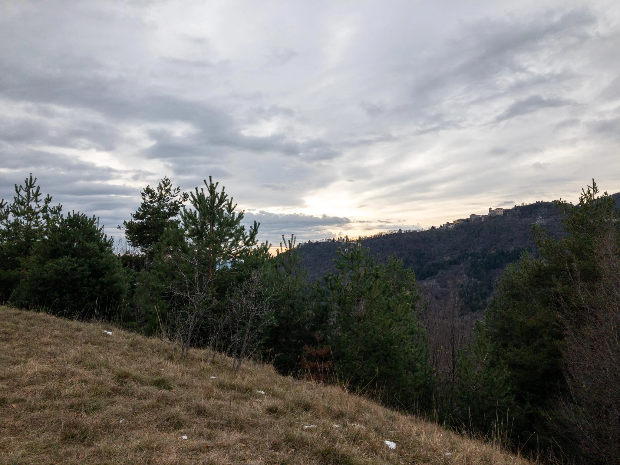

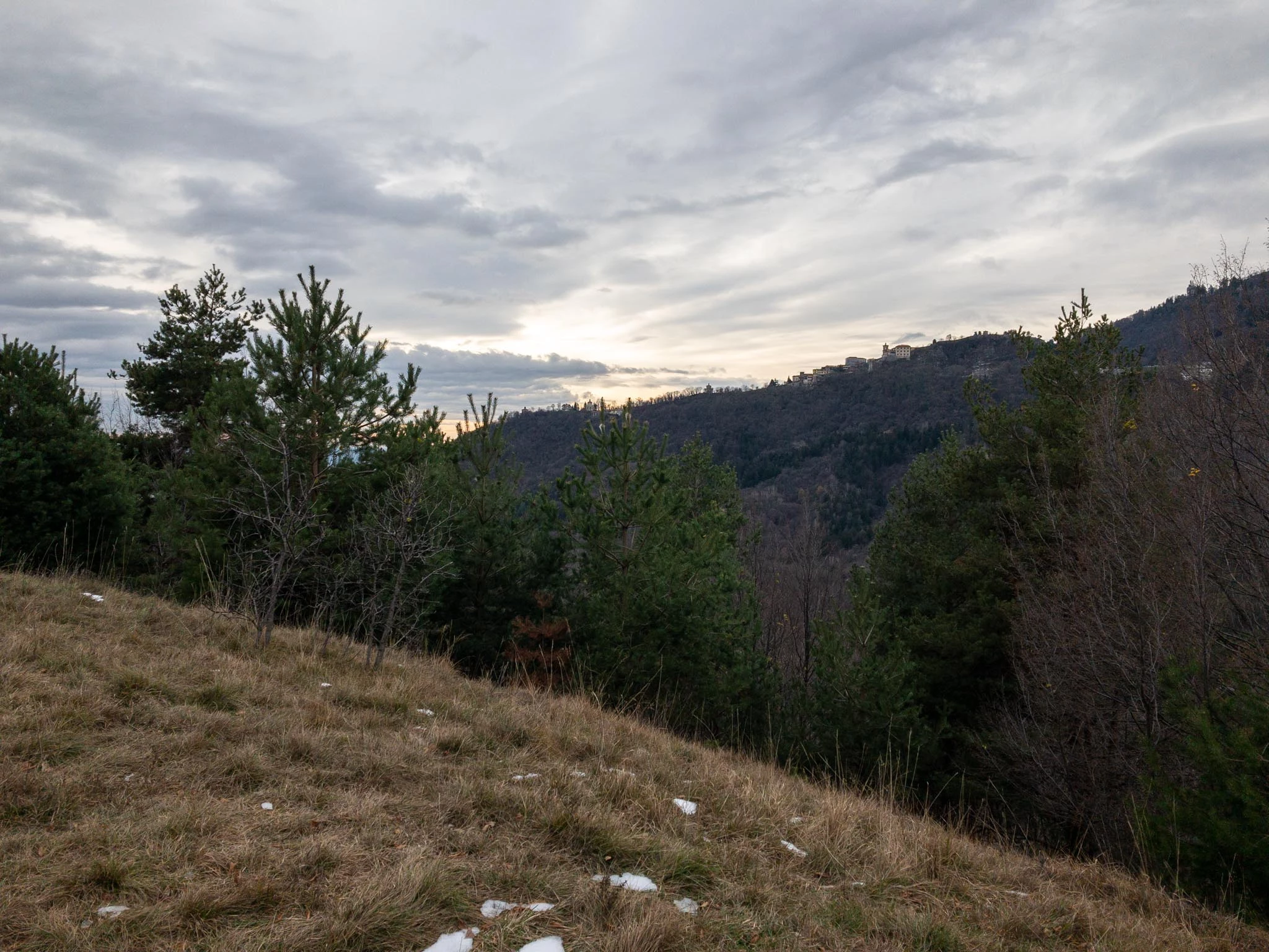

Hi Charlie,
A short follow up.
Please see the attached files:
- APC_0129 Lr camera, uncorrect geolocalisation
- IMG_0053 iOS native camera, geolocalisation OK
- APC_0130 Lr camera. geolocalisation OK
The photos were taken in a quick sequence. Metadata included.
- IMG_0054 is the screenshot of the compass, same location as above photos, a few seconds after the sequence was taken. BTW, as you can see, the cellular connection wasn't weak, but no data connection.
iOS 15.1, Lr 7.0.2, iPhone SE 2nd generation
Lr Pro mode, non HDR.
iPhone native camera auto mode.
Thank you for your help.

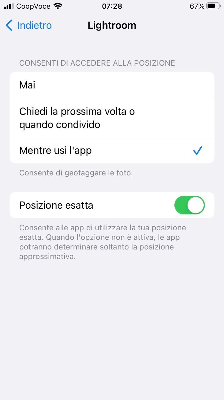

Nov 21, 2021 11:24 PM UTC
Please check iOS Settings > Lightroom > Location, and confirm is "While Using" is enabled.
Nov 22, 2021 6:32 AM UTC
Yes, it is.
