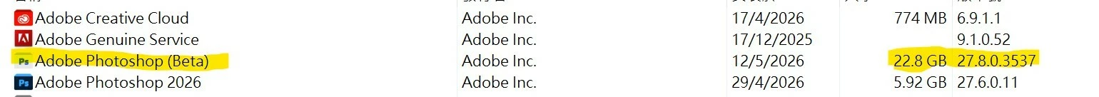

    hoi_man_1313
    hoi_man_1313作成者
    May 12, 2026
    Dear Cory,
    I’ve uninstalled and reinstalled the beta version as you said, but the device option still remain dimmed even the remove tool advanced components are being added, please find below screen. Wonder if any other solutions can be provided ?  Thanks

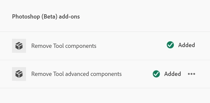

    Thank you for the info ​@hoi_man_1313  here are a few things to check:
    • Let’s update to the latest NVIDIA driver — the feature requires driver version ≥ 32.0.15.2800, and launch drivers for new GPUs sometimes don't pass the internal version string check.
    • The on-device model (~4-6 GB) must download successfully — if it stalled or failed, Device mode stays dimmed. Check disk space and restart Ps.
    Let us know if any of this solves the issue for you.

    hoi_man_1313
    hoi_man_1313作成者
    May 7, 2026
    Dear Cory, the drivers I used is the most updated and also have enough HD space but the device mode still dimmed, please advise if there is some other solutions ?
