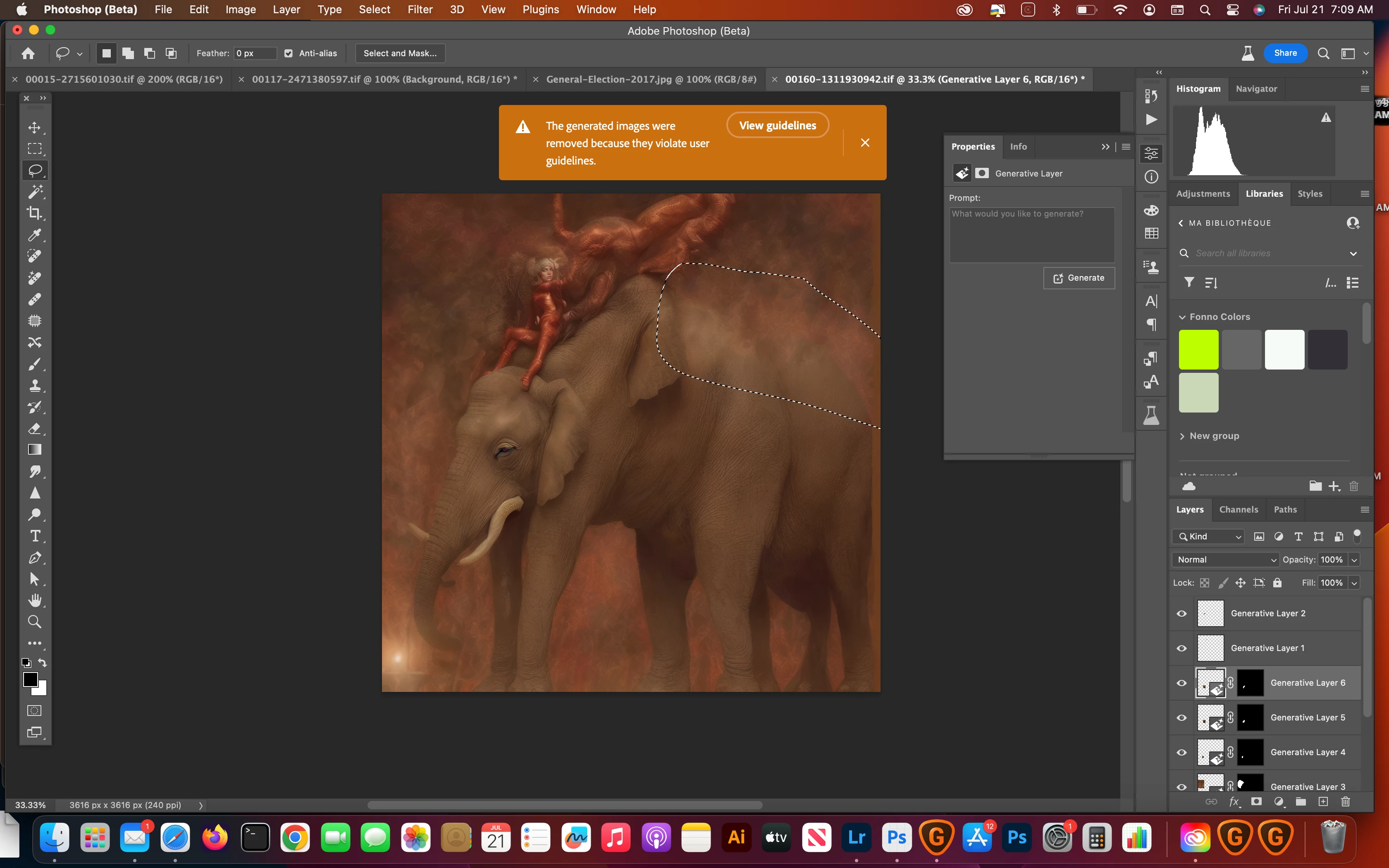

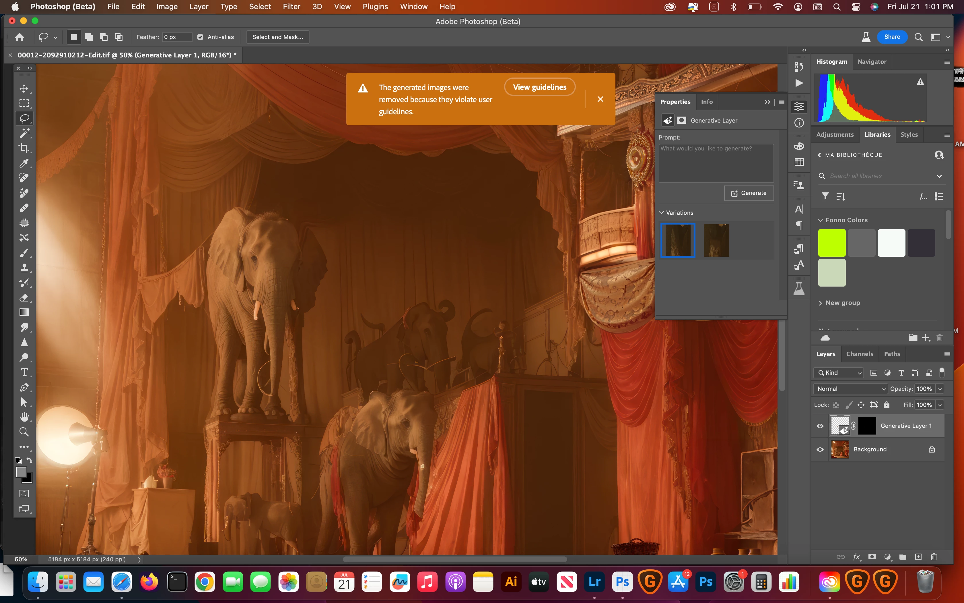

Sorry for being blunt, I will try to channel that into more constructive dialog.  You have to understand how maddening it can get trying to work with Gen Fill at this point.  Last night 100% of the time if I selected something and left it blank it wouldn't render.  That is unaccepatble.  My tone is always very direct though and I feel the need to be so with the response.  The point of all of this is to use it and not have a ridiculous thing impede workflow.  I can appreciate that things worked for you but it doesn't work for me.  The larger point is that somehting is broken in the Gen Fill code that is causing really bad amateur type errors.  Please look at this through the end users eyes.  Why does it most of the time if I leave it blank, give me guidlines window?  It shouldn't do that even in beta software.  I hope you guys are taking it seriously and not just going,"Well, it worked for me so it isn't a problem."
Jul 21, 2023 6:04 PM UTC
Ooops, spoke too soon.  Literally my first render upon opening the project.  Left it blank and selected a tusk and got the window
Gonna be a long day....

Hi @Preston29196145tevi first - please keep things civil.
Second, as with any AI there is going to be a learning curve for users to write effective prompts that can give you the best results.
In your first examples, as documented heavily in here - leaving a prompt blank leads to false violations.
I took that example and entered "smooth skin" I did not get a violation and had some good results - no violations.
In your second post it's most likely in your case it is the word "henna" - the Generative Fill AI is using English only words at this time. I was able to take your example and create a result with "ornate gold tattoo" and again got results with no violations.
Keep in mind if you find this process so frustrating to the point of ranting on a forum, perhaps take a break and don't participate in a beta test for a bit.

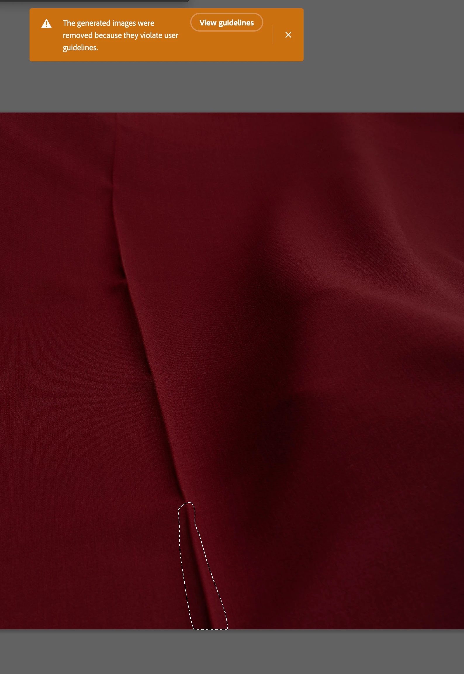

@georger2369527 this has been well documented in here that leaving the prompt blank is a known issue that can cause false flags. Adding even a period to the prompt improves results.
Jul 21, 2023 3:17 PM UTC
It appears that this might be a bug, rather than a "violation".  Restarting PS enables generation without error.
But even simpler, is typing a fullstop/period ( . ) in the 'What would you like to generate' box.  Voila!  No error message.

georger2369527
Jul 21, 2023 8:01 AM UTC
I keep getting the guidelines violations warning when i try to use generative fill (without a prompt) even though i'm only working on a picture of a piece of fabric
