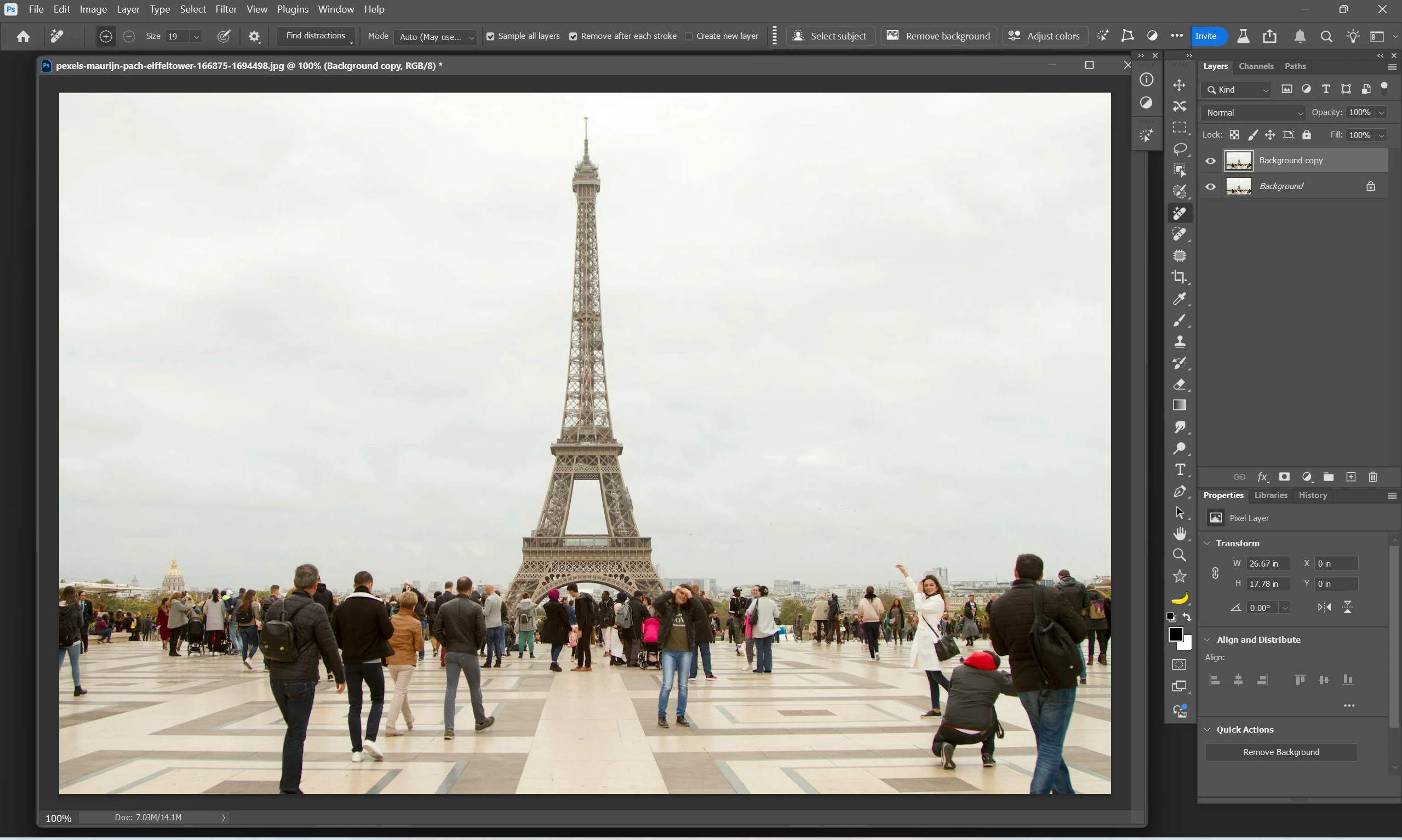

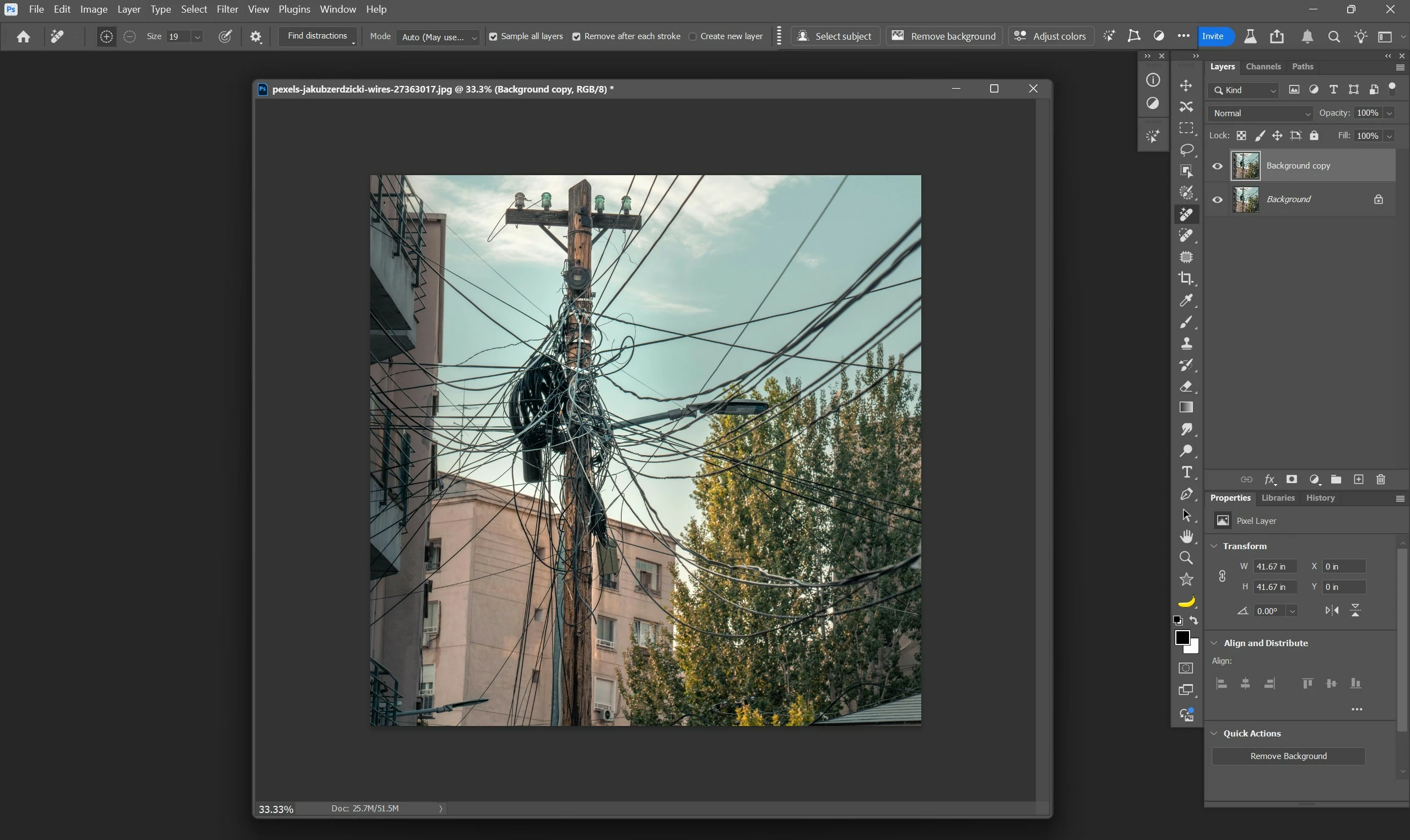

Here's how my test images for #3-4 appeared with the Remove Tool active and my having clicked on each of the respective Distractions categories in the Options Bar. Nada. No overlay auto appears:

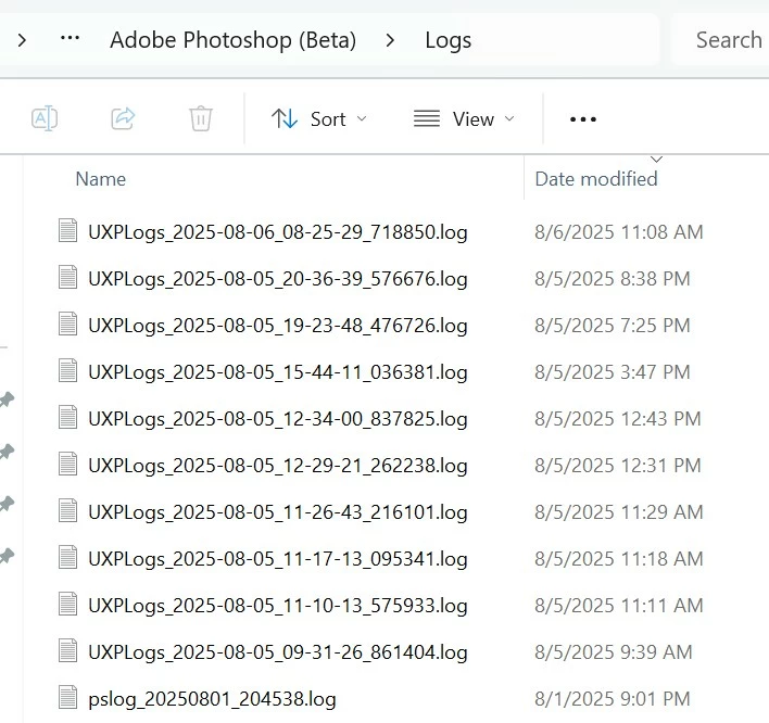

At the C: appdata > roaming > adobe path I see a variety of Logs types since my Aug. 1 update from 26.6 beta rel. (in which Remove Tool worked with my implementation - plugins, etc.) to the 26.10 beta rel. (in which Remove funcs. fail - as they did in 26.8-9 also). Some prefixes are UXPLogs as well as the one pslog_  See snip. To clarify - you're only interested in the 8/1 "pslog_"? Or, most recent UXPLogs_?  Thx.
=========== Pls see email reply. When the error occurs, two logs are generated... a pslog and an uxplog. I sent both to be safe.

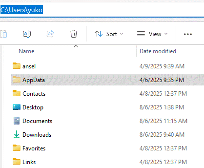

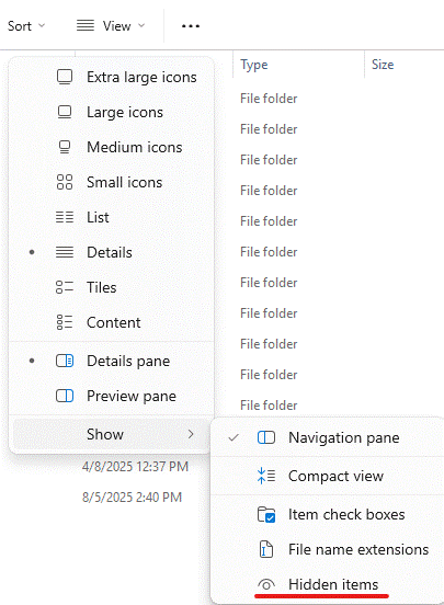

1. Navigate to C:\Users\<User>\
If you don't see the "AppData" folder, go to the View menu and select Show > Hidden items.

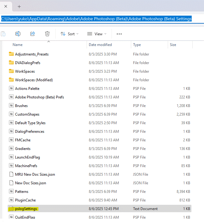

2. Navigate to
C:\Users\<USER>\AppData\Roaming\Adobe\Adobe Photoshop (Beta)\Adobe Photoshop (Beta) Settings
3. Place the pslogSettings.txt in the folder. I sent to your email.
4. Launch Photoshop (Beta).

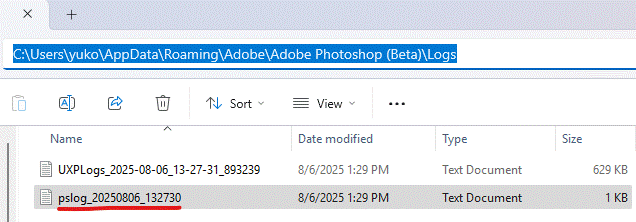

5. Open a file and perform the Remove Tool that triggers the program error. Exit Photoshop.
6. Navigate to
C:\Users\<USER>\AppData\Roaming\Adobe\Adobe Photoshop (Beta)\Logs
You will see the files begin with "pslog_" and send the pslog text files to ykagita@adobe.com

3. If the program error still occurs, open an image with some wires and try Wire Removal by opening the [Find distractions] in the Remove Tool option bar and clicking [Wires and cables]. Does it remove the wires without the error?
4. Open an image with many people and try People distractor removal by opening the [Find distractions] in the Remove Tool option bar and clicking [People]. Does it highlight the destructive people without the error?
