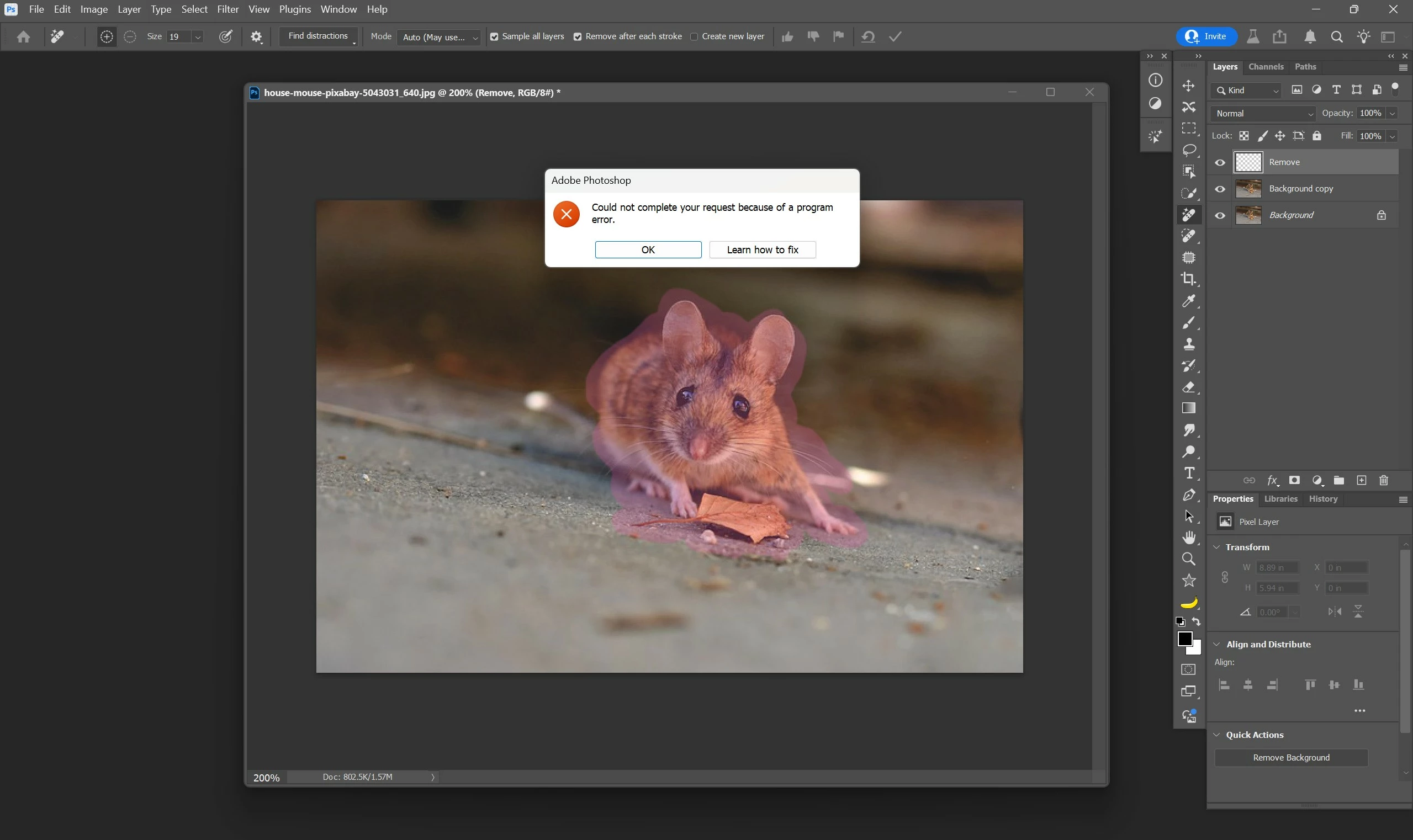

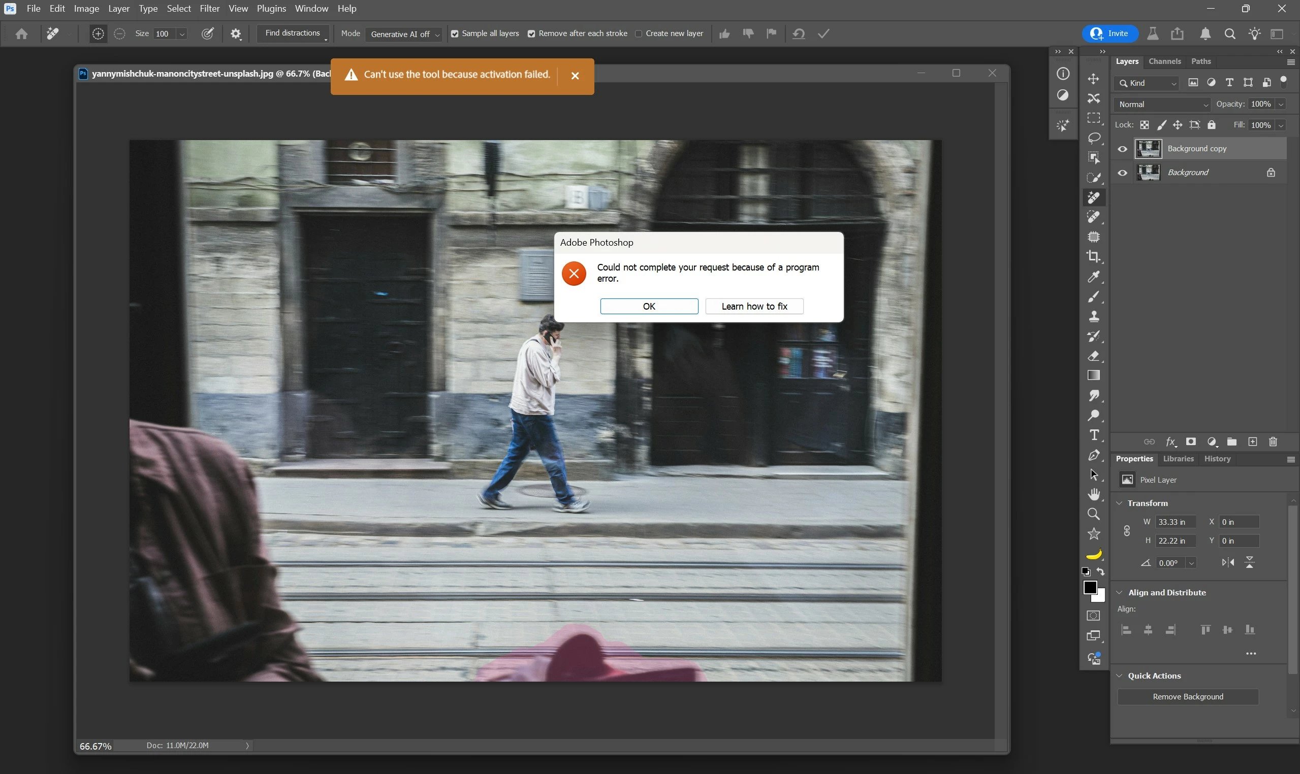

charmander4444
May 14, 2025 8:12 PM UTC
Released
P: Remove Tool Completely Broken
Photoshop Beta 26.8.0
Windows 11
When attempting to brush a remove area or using the Contextual Task Bar it results in an Error.
Error Report:
Photoshop Error information
Code: -1
Text: because of a program error
Message: Could not complete your request because of a program error.
Stack:
{"load":[{"Photoshop.exe":"00007FF7BF620000"},{"KERNEL32.DLL":"00007FFBC0040000"},{"ntdll.dll":"00007FFBC1EA0000"}],"offsets":[{"Photoshop.exe":[106113490,106025768,58253852,58227850,58213690,95642852,95640265,95640249,95734973,58084050,58099319,58097491,58852582,67541581,67232780,67379917,86975492,67247437,100828722]},{"KERNEL32.DLL":[190679]},{"ntdll.dll":[726268]}]}
33 replies

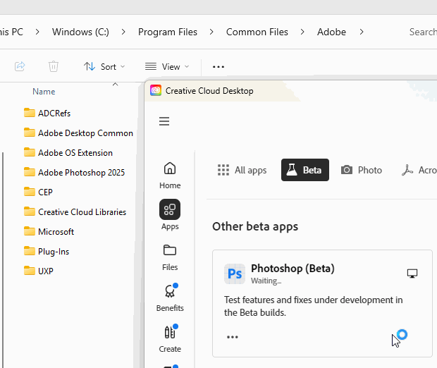

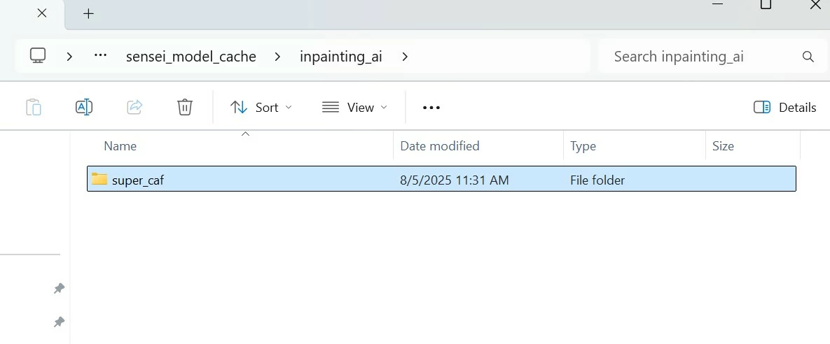

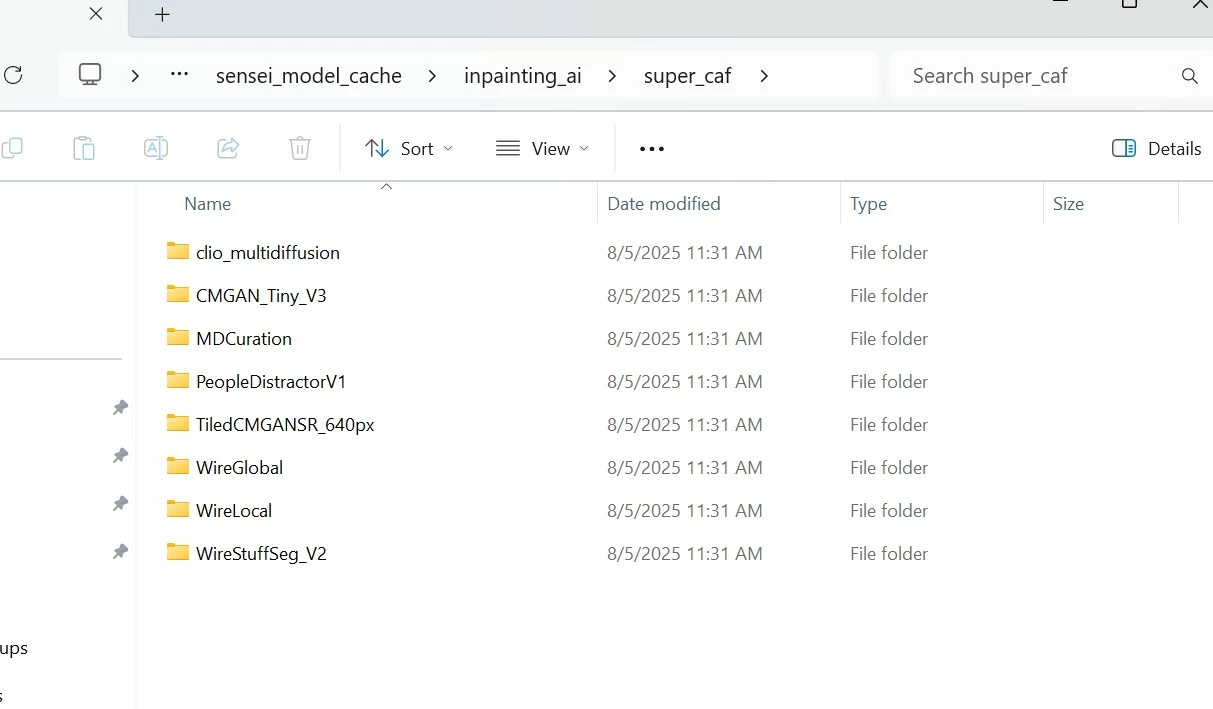

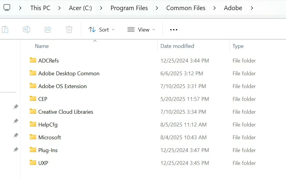

Aug 5, 2025 10:52 PM UTC
Hi Yuko,
This is what I see in the folder path where the Remove Tool is supposed to be - per your note. I'll attach a snip (from Win 11 Explorer) of the folder and what's in the expanded folder. I still get the Error Msg that the program is unable to use the Remove Tool (another snip of that below using a different image too). Thx.
Adobe Employee

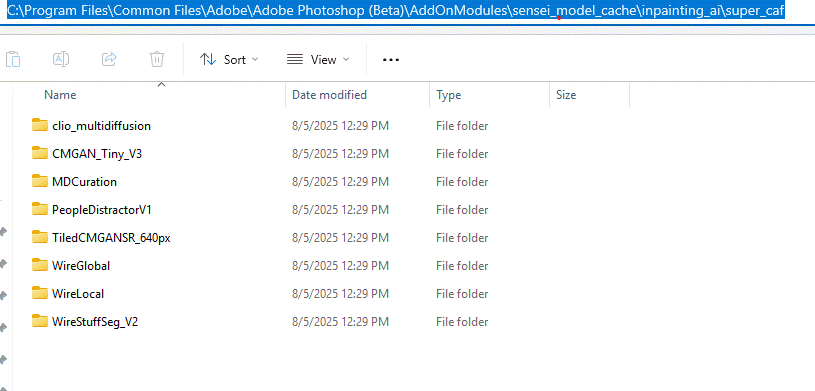

Aug 5, 2025 9:13 PM UTC
@Fotomaker01RA
Thank you for sharing the screenshots. They are very helpful. Oddly, the Remove Tool components are marked installed in Add-Ons, but the Adobe Photoshop (Beta) folder is entirely missing in the following directory.
C:\Program Files\Common Files\Adobe
Can you completely uninstall the Adobe Photoshop (Beta) app so that we start from the same point? When asked if you want to keep Photoshop (Beta) preferences, make sure to click the [Remove] button.
Then try installing the Beta app again.
After the installation, ensure the Remove Tool components are installed in the following directory.
C:\Program Files\Common Files\Adobe\Adobe Photoshop (Beta)\AddOnModules\sensei_model_cache\inpainting_ai\super_caf
Let me know if you still see the error messages when you use Remove Tool.
Thank you for your patience!
Yuko

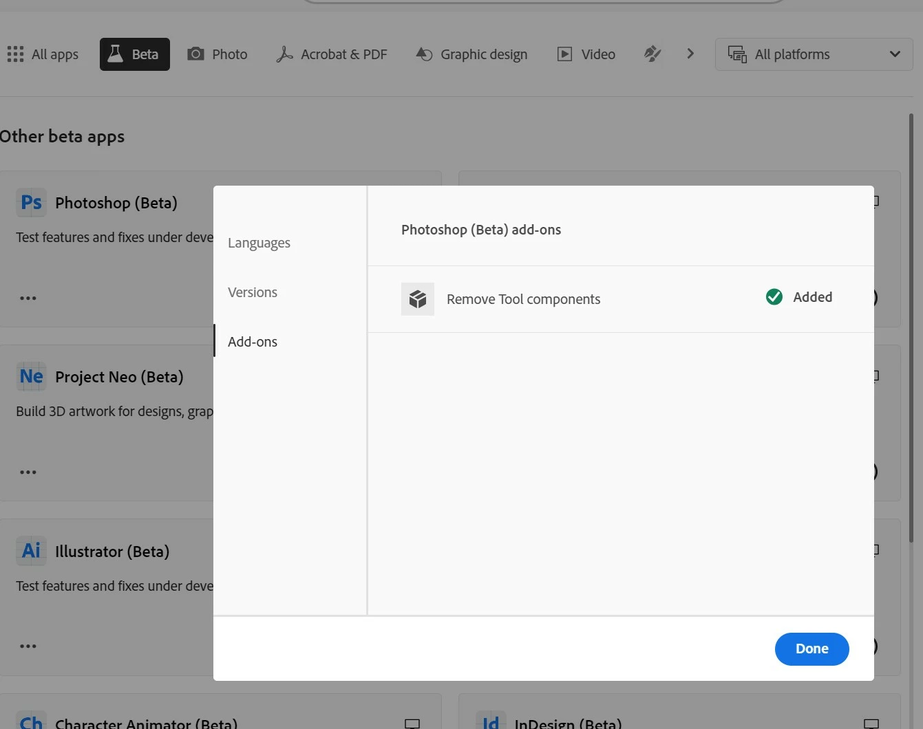

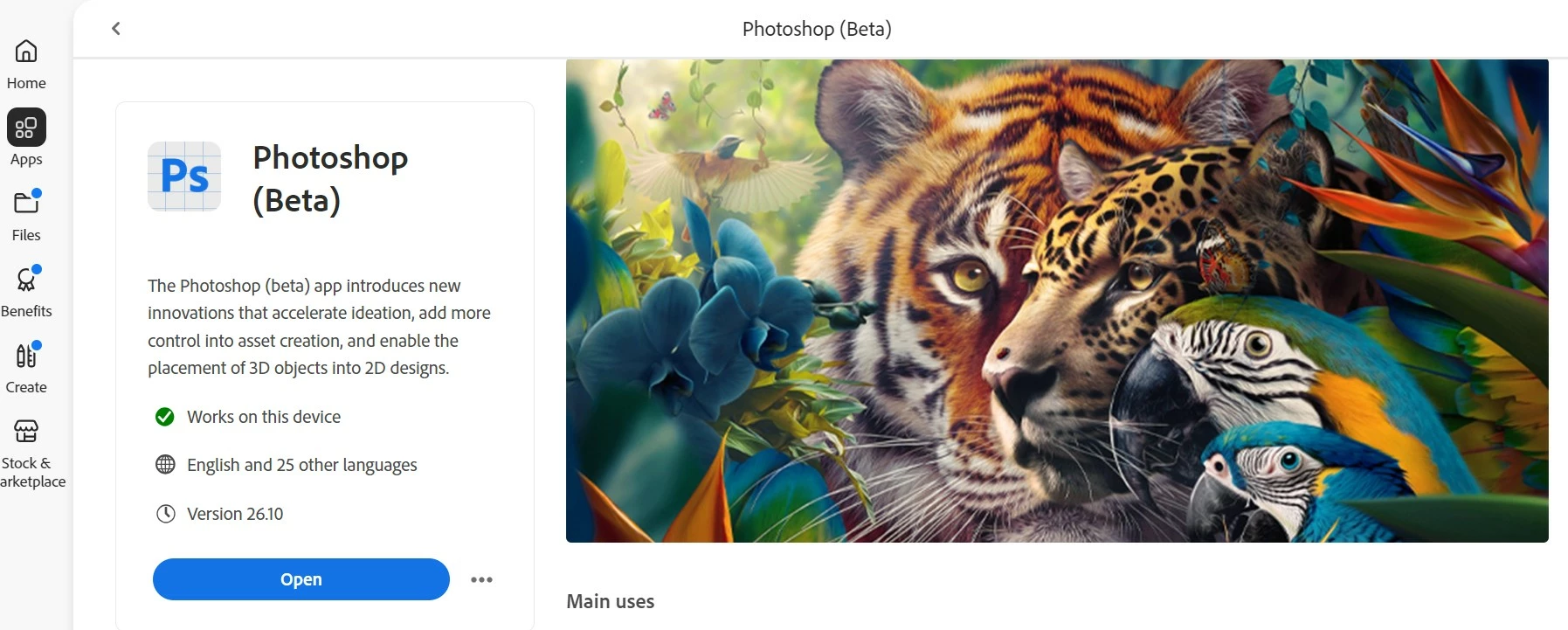

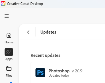

Aug 5, 2025 6:56 PM UTC
Cory,
I just (8/5/25 @17110578:30 am PDT) tried your suggestion & deleted the Adobe Ps beta folder in the path:   C: Program Files > Common Files > Adobe > Adobe Ps beta
It did not help. The Remove Tool is still inaccessible.
Here's what I did in more depth:
- After I deleted that folder - per the link from the forums you pointed me to, I reinstalled Ps beta rel. 26.10 using the CC dashboard (see snip below that shows it installed and compatible with my Win 11 laptop)
- On the CC beta dashboard it shows the Remove Tool Components as added. Snip attached for that too below.
- I launched the Ps beta 26.10 & attempt to use the Remove Tool. I get the same bhvr noted above - i.e., I can draw a selection overlay on the area I want to remove until the selection closes - then I immediately get an Error Msg. But ---- this time it is a different error msg that says the "folder that's needed to use the tool is missing" (see snip of that below also).
- Bottom Line - the Remove Tool still isn't usable and the reinstall of a Ps beta does Not re-populate an Adobe Ps Beta folder into the Program Files > Common Files > Adobe >     folder.
Questions:
- What else can be done to correct this?
- When I expand that Adobe Ps beta folder that was under the Program Files > Common Files, should I see a file or folder that explicitly says "Remove Tool" somewhere?
- For those running Win 11 who do have a working Remove Tool in rel. 26.10 Ps beta, is there a visible listing of the Remove Tool in the component files?
- Is there someone who can view my system remotely to see if they can figure out what's what? It doesn't seem like something for someone who's reading from a script to try to diagnose whether the code "hooks" the tool in the UI needs to connect with the correct ops code are missing.
Snips Referenced Above:
Thanks. I'm feeling pretty discouraged...

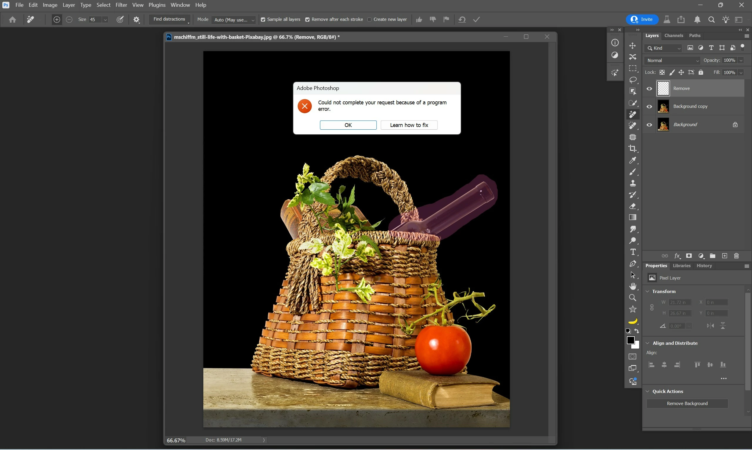

Aug 5, 2025 12:33 AM UTC
Hi Cory -
Here's what I've done after your reply this morning (Mon., Aug. 4, 2025) with my Win 11 laptop (NVIDIA 4090, Intel i9 14th gen) running only Ps beta (not production rel.):
- Rolled back to Ps beta 26.8 - Tested the Remove Tool there. It doesn't work there either. I'd also tried 26.9 and that didn't work either...
- Reinstalled Ps beta 26.10 - using whichever installer was available today on the CC beta apps page. Remove Tool still generated the same error msgs I posted snips of above. I already noted all the ways I'd tried to get it to work with Prefs., Option bar settings, working on Content vs Transparent layers, etc.
- Downloaded/installed latest (Jy 25, 2025) NVIDIA 4090 laptop Studio driver. Rebooted the laptop.
- Restored my saved Ps beta Settings (so my UI looks and works the way I like...).
- Launched Ps beta 26.10. It launches with no issues. I can open images. I can select the Remove Tool and draw around an object to be removed and see the overlay color/opacity I've set. As soon as I close the Remove area selection, then I immediately get the error msg that the Program is missing the info it needs for the tool to operate. I'll attach my snip from moments ago for you to see...
- I revisited the YouTube videos of the well-known Ps evangelists (Colin Smith, Morganti, Glyn Dewis, etc.) who promote new features for Ps and Ps beta - to see what they said/showed wrt the Remove Tool. What they all had in common - they were all demo'ing the features on Apple computers (not, Win 11 like I'm using...).
- Here's the snip I promised of the error msg from moments ago (I don't know where you're located, but I'm 20 mins from San Jose so on the same time as there).
Also, just saw your note about someone looking in Program Files > Common Files for the Ps beta folder there. I only have one Ps beta folder there. The date next to it is:  6/6/25 @ 6:23pm. Is that what should appear there if I've only been installing the latest Ps beta since Aug. 1? Is that date the date of the release or the install date?
Thx!  Methinks the Remove Tool code has gone incognito.

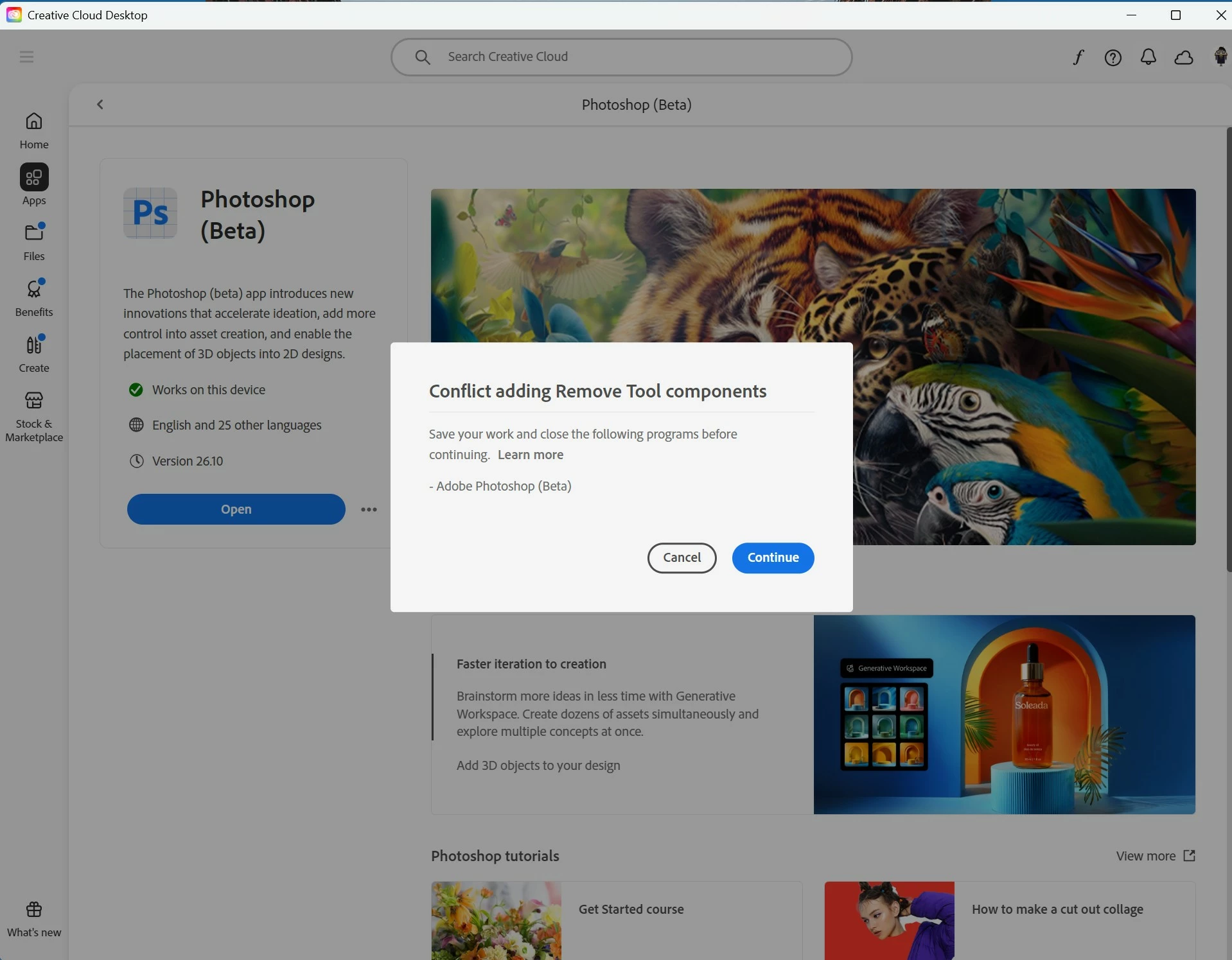

CShubert
Aug 4, 2025 10:33 PM UTC
@Fotomaker01RA curious if this works?
"I found a fix for my issue. Turned out there was an existing/old "Adobe Photoshop (Beta) folder" that wouldn't let me overwrite it, under C:\Program Files\Common Files\Adobe\Adobe Photoshop (Beta). Deleting this folder helped resolved it and I could then the Remove Tool add-on."
Cory - Photoshop Product Manager
Aug 4, 2025 4:48 PM UTC
Hi Cory,  I do have the most current beta as of last nite (Aug 3rd) and had the same experiences as noted in my beta rpt from Aug 1st.
I can't use the 2 prior beta releases (incl. 26.8) b/c they either wouldn't launch at all or had the same Remove Tool issues. Now I'm kicking myself that I updated... but I was curious to try Harmonize because I do quite a bit of compositing.
I keep Ps beta (Win 11 laptop) & Ps production (Win 11 desktop) release on different computers.  I can't risk anything going screwy on my production release because I regularly produce Ps 'how to' videos for my YouTube channel each month. I'm on an older production release b/c I saw the beta issues with Remove and could not risk it porting to my YouTube recording production version of Ps...unless me demo'ing the bugs is okay.
I will check the RTX 4090 Studio driver for my laptop but have read dicey reviews about later versions. A lot of Adobe users are experiencing this Ps Remove bug. Are they all using the same 2024 NVIDIA driver? Have the devs been able to isolate how to fix the bug? The Spot Healing Brush can't do for me what the Remove Tool can.
My viewers on YT have been requesting I show comparisons of Ps & alternatives. I just hate the idea of showing a Remove Tool bug & error msgs when trying to tout the wonders of Ps.
Thx for your reply!
