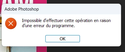

Jul 15, 2025 6:26 PM UTC
When using the remove tool about half way through processing, I get an Orange message " Service is not available, check internet connection. Try again later. Internet is fine and I have tried later.  Adobe Photoshop Version: 26.9.0 20250713.m.3147 5b6ea2d x64 (dev: PublicBeta)

May 16, 2025 2:43 PM UTC
Bonjour ,
Depuis l'installation de la version 26.8 de photoshop Beta mon outil supprimé ne fonctionne plus. un message apparait
