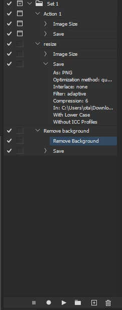

I appreciate your effort to help, but as I mentioned, none of my actions seem to be working anymore. Removing the background was just one example of the issues I’m encountering. I’ve attached an image for reference—thank you for taking the time to assist. Perhaps resolving this will help address the other problems as well. The video I posted was simply to show you my exact process.

MisotaAuthor
Sep 18, 2024 8:13 PM UTC
This is all there is to it. There aren't any scripts. It is a very basic action
Sep 18, 2024 7:41 PM UTC
That doesn't help in the least. Please post what I asked for, the expanded actions panel, any scripts, plus your layers panel.

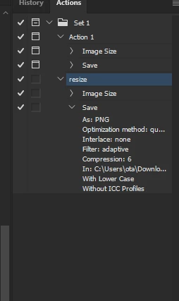

MisotaAuthor
Sep 18, 2024 7:06 PM UTC
MisotaAuthor
