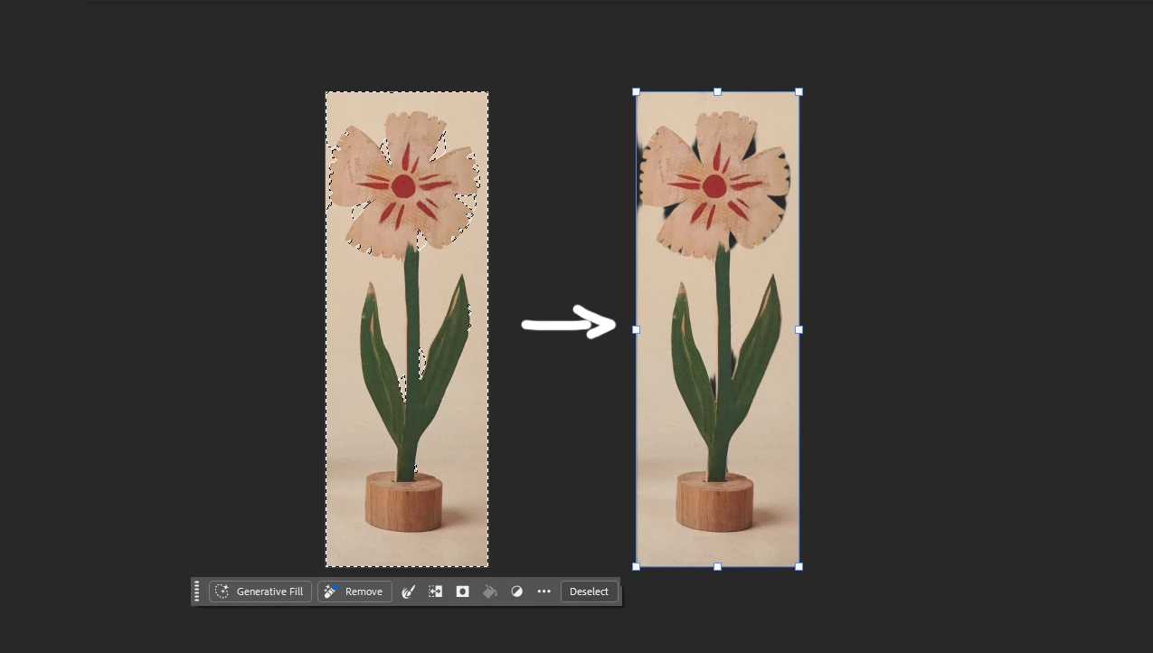

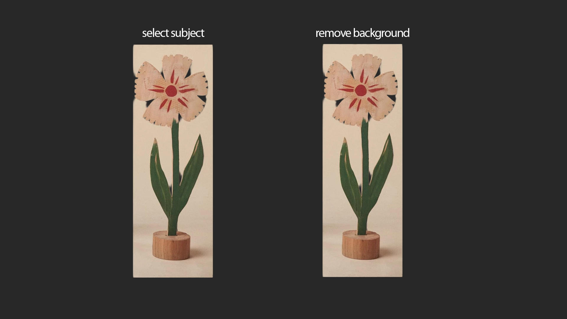

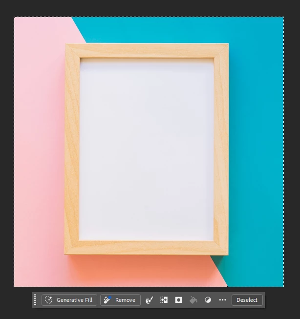

Here is an example of the weird selection it made on non-generated image as a smart object layer, i used both SS and RB and then created a mask. Also an example of a image that it only selected the outer bounds when using SS and RB.

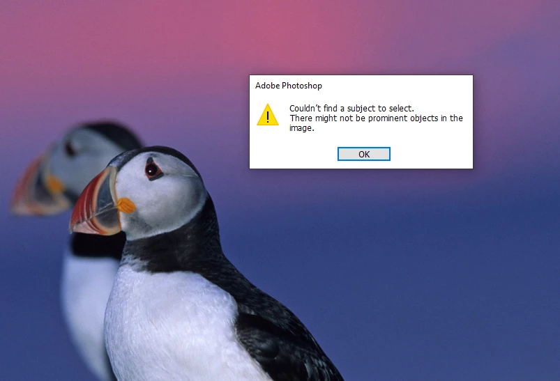

Yeah, I have cloud enabled. I also never got a message saying it couldn't find a subject, it just selected in a weird way.

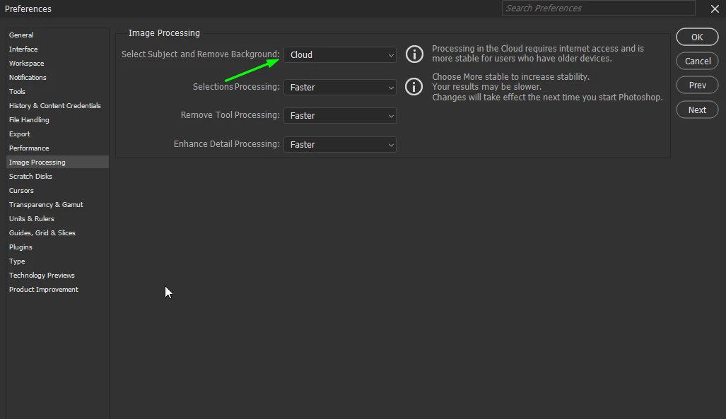

@LokoPost25629671z1yq what setting are you using in the preferences, cloud or device, I was getting this when I had device selected, changing it to cloud seems to work though
With device option enabled
With the cloud option enabled
