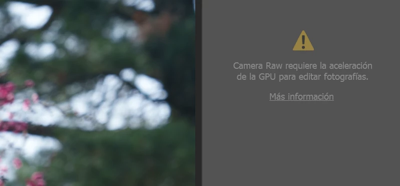

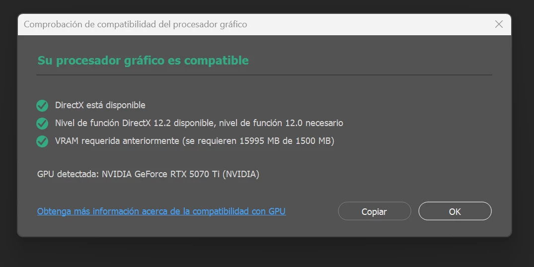

    Compatibility is OK
    first message when trying to open camera raw

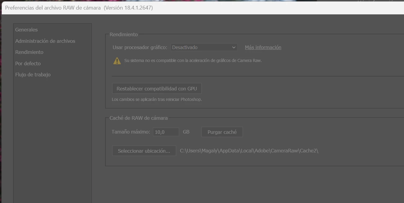

    Second message in Camera Raw options: System not supported (only and exclusively for Camera Raw; all other software works without problems, including Lightroom)

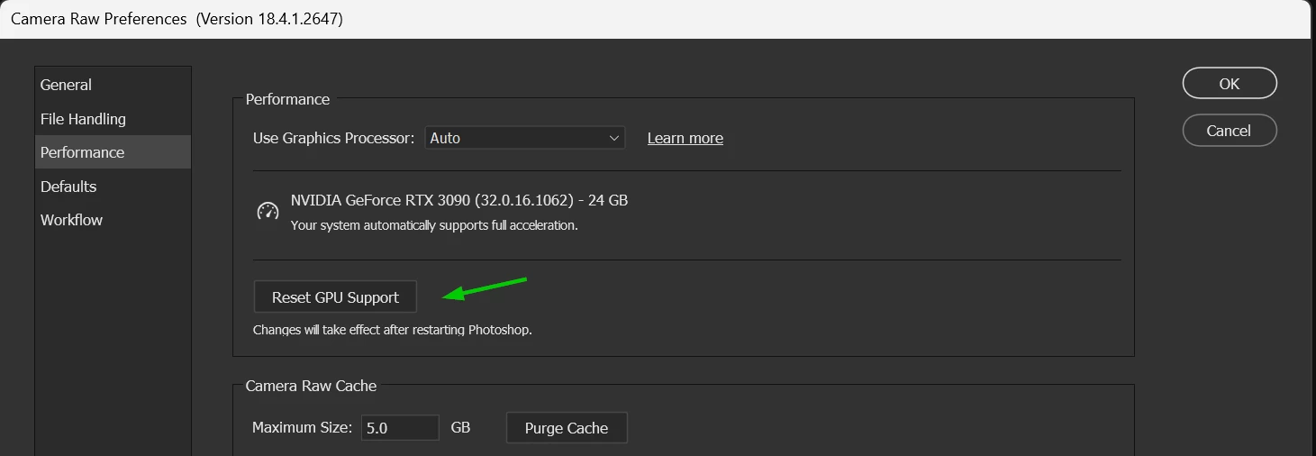

    Ged_Traynor
    July 17, 2026
    @magobar have a look at the ACR troubleshooting steps here
    https://helpx.adobe.com/ie/camera-raw/kb/acr-gpu-faq.html#troubleshoot
    Scroll down to this bit
    7. Check and delete the TempDisableGPU3 or TempDisableGPU2 files

    Hi Ged_Traynord:
    I already did it, well, actually I didn't because I don't have those files.
    As a temporary solution, I installed CR version 18.3.1 so I could open the files (how strange... so much has changed from 18.3 to 18.4 for my graphics card to be so bad... could it be an Adobe bug?)
    Thank you very much for your reply, but I'm still having the same problem (those files aren't in the GPU folder; I've tried searching for them in C:/).
    Kind regards
    Ged_Traynor
    July 17, 2026
    It’s working fine on my system with an RTX 3090, I wasn’t able to locate them files either, have to tried resetting the GPU support
