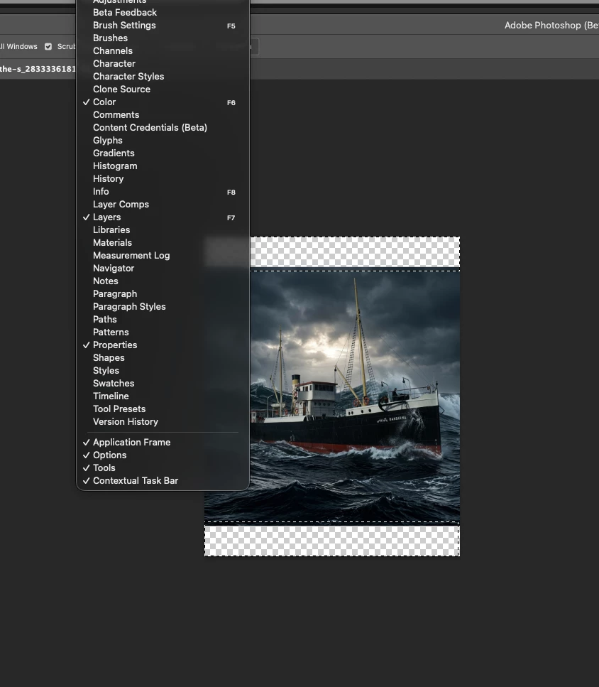

Contexual Task Bar Disappeared
Even though it is checked and has to be seen on the PSD screen and even though I uninstall the photoshop and resinstall it, even though I use the beat too, contexual task bar seems to be some else that I can not reach now :) Is there a solution for that?

    ​@Saygın Mehmet looks like you’re using the Beta version of Photoshop, you’d be better off reporting the issue on the Photoshop Beta forum.
    FYI, professional people don’t use Beta apps for a reason.
