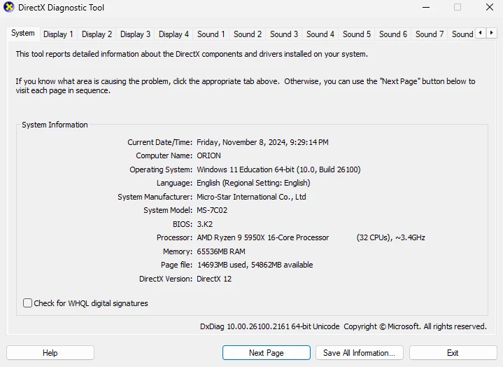

Below I've attached the DxDiag info.

If I may... @diosimos , have you tried to dial down RAM to the nominal speed? Overclocking RAM is never a good idea, and it serves no sensible purpose.

Also, the crash report and the system info suggest you're working on Photoshop 2021 (v22.2.0). Please share the info while using Photoshop 26.0 or Photoshop (beta) 26.1.
Thanks!

@Sameer K
SYSTEM INFO
Below you may find attached the system specs (it wouldn't allow me to attach an rtf or txt file)
Adobe Photoshop Version: 22.2.0 20210202.r.183 2021/02/02: a176e5849fa  x64
Number of Launches: 196
Operating System: Windows 10 64-bit
Version: 10 or greater 10.0.26100.2161
System architecture: AMD CPU Family:15, Model:1, Stepping:2 with MMX, SSE Integer, SSE FP, SSE2, SSE3, SSE4.1, SSE4.2, AVX, AVX2, HyperThreading
Physical processor count: 16
Logical processor count: 32
Processor speed: 3400 MHz
Built-in memory: 65461 MB

Hey @Sameer K , thank you for taking the time to investigate the issue.
To my knowledge, I'm only overclocking my RAM at 3600Mhz, as advised by a more tech savvy friend of mine. No GPU and CPU overclocking.
I'll be experimenting and pushing some things on the Web version, and let you know how that goes.

From the event viewer, at the most recent instance I find nothing related to Photoshop, and all the other events near the time of the crash are incomprehensible jargon to me. Drivers, warnings and other things failing to load, things of that sort.

Hey, @diosimos. Thanks for sharing all the details you have. Before Photoshop crashes, please share the system info from Photoshop Help > System info > Copy and paste into a text document > Upload and attach here.
Apart from this, a hard system crash is highly unlikely to be related with Photoshop. The details you've in the initial WRER log and in the follow-up also add to what I am speculating.
Check the Event viewer > Windows Logs > Application Logs at the crash even to find any faulting module that relates to Photoshop.
Are there any overclocking of the CPU, GPU or RAM in place? Try booting the device in safe mode and check if Photoshop behaves as expected.
A totally different test you can do is to use Photoshop Web (https://adobe.ly/3NYNShc).
