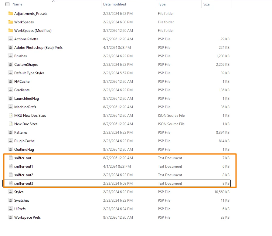

    • Share the GPU Sniffer file: This file is generated every time Photoshop launches and contains the raw data about how Photoshop detected your graphics card. On Windows, you'll find it here:
      C:\Users\[your username]\AppData\Roaming\Adobe\Adobe Photoshop 2026\Adobe Photoshop 2026 Settings\sniffer-out.txt
      (Note: AppData is a hidden folder, you can paste the path directly into File Explorer's address bar, or type %appdata% to jump to the Roaming folder.)
