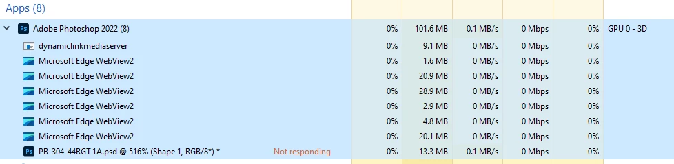

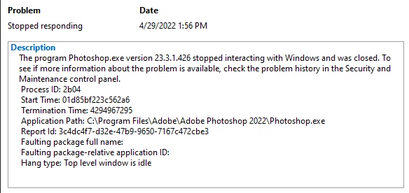

Photoshop does not provide a method to disable neural filters.
I have some problem of stability I isolated everything but network.
Photoshop (all version) constantly freezing with W... - Adobe Support Community - 12826935
I observed photoshop constantly communicating with amazonaws, I am pretty sure that it got stuck because some firewall setup on the main server that prevent an anwser from the outside that should trigger some whateve event.
I don't use neurfal filters and therfore I do not need them, I do not want constantly photoshop sending telemetry to whateve who knows, without my consent.
Please provide a method to disable neural filters and-opt out telemetry.

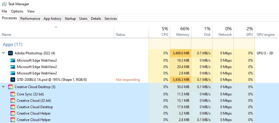

Apr 29, 2022 6:35 PM UTC
I have been testing with and without GPU, it happens the same, no matter what the GPU (Intel or Nvdia):
It is not hardware related since we have three identical PC, the difference between mine and the other two is that I keep up with the Windows Updates, therefore is an interaction between the Windows and Photoshop the cause of the issue. Also the hardware is pretty standard: Dell-Precision-Tower-3000-Series-3420-Spec-Sheet.pdf I exclude any specific hardware related issue.
I am also working with fairly light files, that are mostly pictures, since I stressed out Photoshop by any means and the issue still continues, the only aspect where I do not have control is the network; if Photoshop needs constantly to communicate to any Amazon AWS server waiting for whatever answer in order to work and if the office firewall is blocking it then I might have found why suddenly Photoshop got frozen.

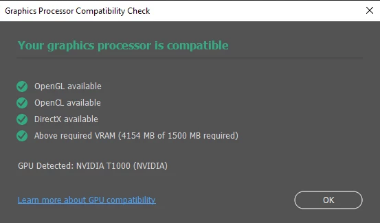

Apr 29, 2022 2:43 PM UTC
Unfortunately, this issue appears to be system/hardware specific.
Let's eliminate the GPU entirely:
First quit Photoshop. Then install the attached file (PSUserConfig.txt) in your Photoshop Settings folder:
Windows:
[Installation Drive]:\Users\[User Name]\AppData\Roaming\Adobe\[Photoshop_version]\[Photoshop_version]Settings\
Run just Photoshop by itself, without InDesign or Illustrator. Does the problem still occur.
The other thing to try is booting into safemode to disable system utilities: https://helpx.adobe.com/photoshop/kb/basic-troubleshooting.html#safemode
Apr 29, 2022 2:19 PM UTC
I switched the graphic adapter to a newer one (Nvidia T1000 4G); uninstall completely each adobe bits and cleaned up all the settings across users and shared folders; I updted the Nvidia Drivers to the lastest one: 512.59; and still continue to have the (mainly) Photoshop, Illustrator and even InDesign with constant and unexplicable frozen screen completely unresponsive.
I tried to offer all the information I could but no one in this forum is attending nobody, the worst customer support I have ever seen so far.
I hope for someone that for pity will be helping me:
GPU Test: PASSED
