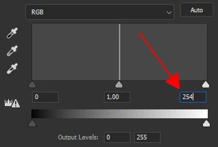

Workaround (with some losses):
We want to calculate: for layers A and B create the layer C with pixel values of:
"50% gray" + ((A - "50% gray") + (B - "50% gray")) (clipped at 100% black and white)
1) For layers A and B, shift the correct 50% gray point (16384) to the incorrect one (16448) using the Levels adjustment (NOT the Adjustment layer!) with "input white = 254". We are loosing some data.

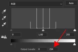

3) Convert the result to the correct 50% gray point (16384) using the Levels Adjustment Layer, with "output white = 254".
We fall one short of all values near 50% gray (for example we get 16383 instead of 16384 for 50% gray), so we have to add "+1" to all pixel values in 16-bit mode. Tricky. Create a Fill Layer, Mode: Linear Dodge (Add), Opacity: 1%, Fill: 50%, Color #010101.
