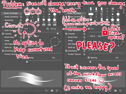

P: Brush Size Lock
Having to change the size of your brush to the one you are using EVERY TIME you change brushes is incredibly hectic and time consuming when working. If you switch brushes, the size of the brush will change to the preset of that brush that you selected.
A Brush Size Lock to give the user the choice to avoid size switch with every brush preset switch would be an amazing time saver.
Alternatively, an option to save the size (or not) of a brush when creating a new preset would be also be a dream.
I am confused as to why the "Soft Brush" set of 3 that comes with Photoshop allows you to switch between them without altering the size of a brush, but this is not offered to any other brushes, to my knowledge.
If there's a way to do this it would be greatly appreciated, if somebody could shed some light on the topic. Otherwise I haven't found anything online.
Thank you! 🙂

Hi Georgina,
Thanks for the suggestion! Love that you included the screenshot with direction -- that's super helpful 🙂
I filed a case with the request. It's under consideration.
When you refer to switching between brushes, are you mostly referring to switching between brushes that ship with Photoshop?Those presets can't be edited, but you might consider making a custom set of the brushes you use regularly. When you create a custom brush preset don't check the box that says to capture size (to keep them size agnostic).
Would love to hear why or why not this might work for you in your workflow.
Thanks!
Hannah
