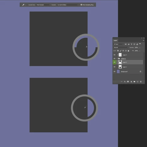

P: Color Picker ignores current layer inside group with clipping mask
For this issue, the color picker has to be set to "Current & Below", or "Current & Below, No Adjustments."
The problem is if you try and color pick your current layer inside a group that has any kind of layer clipped to it, it will ignore your current layer and only pick underneath it. In some areas, it sometimes picks the proper color, but typically it just ignores the current layer.
The only way to resolve this is to unclip the layer from the group, turning it off doesn't help. This has been verified as a bug in CC 2015.5 and CC 2017, all versions, by both me and a colleague on separate machines, both PC. I haven't tested any other CC versions, but it is NOT an issue in CS6.
Interestingly, on lower resolution files, it sometimes goes away, but it's persistent on higher res files. Also, in SOME documents, changing the sample to 3x3 rather than point, it will pick up the proper color in more areas, but is still glitchy. I wonder if the cache levels on the document might have something to do with it. Also, I removed any plugins and preferences from Photoshop to verify it was not an outside issue.
Provided here is a link to my test file, but it can be recreated easily.
https://dl.dropboxusercontent.com/u/25549920/ColorPickerTest.psd
Does anyone have experience with this, is there any kind of fix? I work within groups of this nature all the time, and it's very much a problem.
Thanks for any help!
https://dl.dropboxusercontent.com/u/25549920/ColorPickerError.jpg

Yes, i can 100% reproduce. The error occurs when clipping a layer to a group. Layers which are underneath and within the group will sample colors above or below the selected layer depending on the visibility of the surrounding layers.
Jeff, i also noticed an additional rendering bug when trying to repro this issue. I'll make a report for the new one...
September 9, 2019
Here. To reproduce the bug i need: a group with a clipping layer on top set into any blending mode. I'm also on 20.0.6

Clipping a layer to a group with multiple layers is the first step, to break the color picking behavior set the blending mode of any of the groups child layers to a mode other than normal. Now the current layer will always be ignored by the color picker and depending on the order of the layer with a blending mode set I've found different color picking behaviors.
Here's a repro file showing the grouped and ungrouped behavior. https://www.dropbox.com/s/0hkgrfoebeld1p0/colorpickerbug.psd?dl=0
