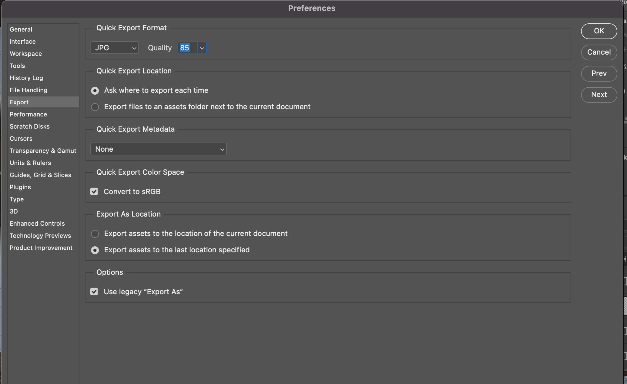

I updated to MacOS 11.6.2 this morning, and now my photoshop Export As is showing blank fields and gives the error message "No valid Asset to Export." I've tried on multiple files which exported before. I'm using Photoshop 23.1.0. Note: I was able to set the Export Preferences to "Use Legacy Export As" and that is working.

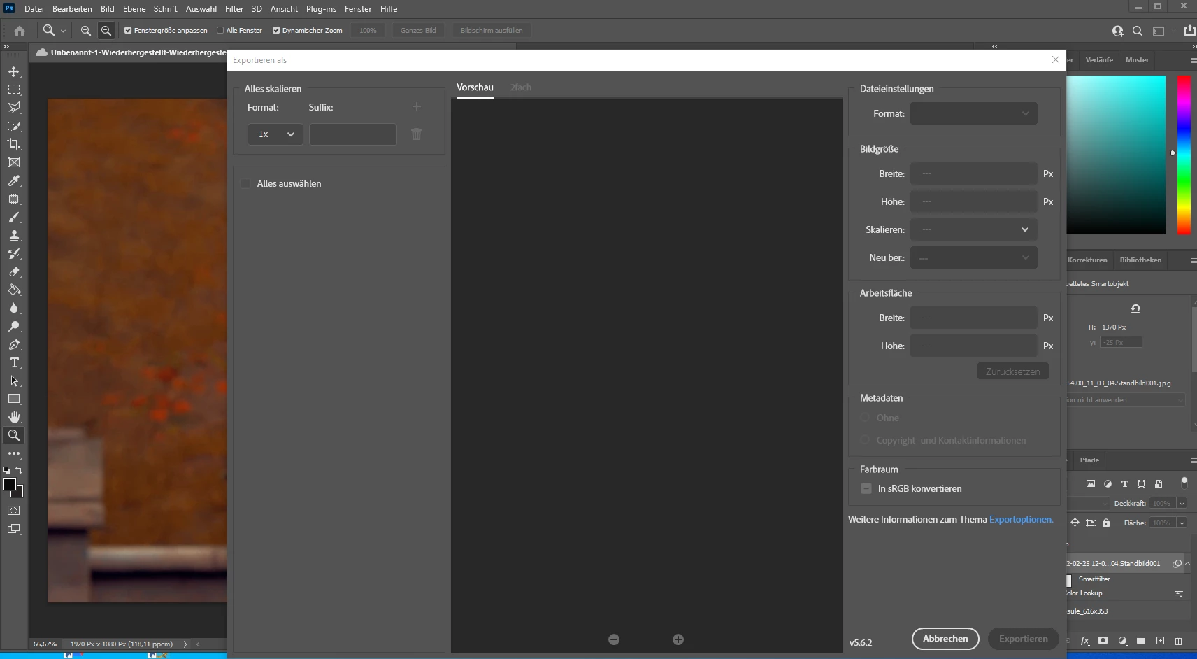

Hello guys,
 I recently has this issue where i cannot use the "file > export > export as" menu. The window shows up, but nothing is clickable except for 'cancel'
I've tried to :
• Update photoshop
• Uninstall photoshop
• Switched an older version of photohsop which i'm using right now (23.1.0)
Has anyone encountered this and has an idea how to fix it ?

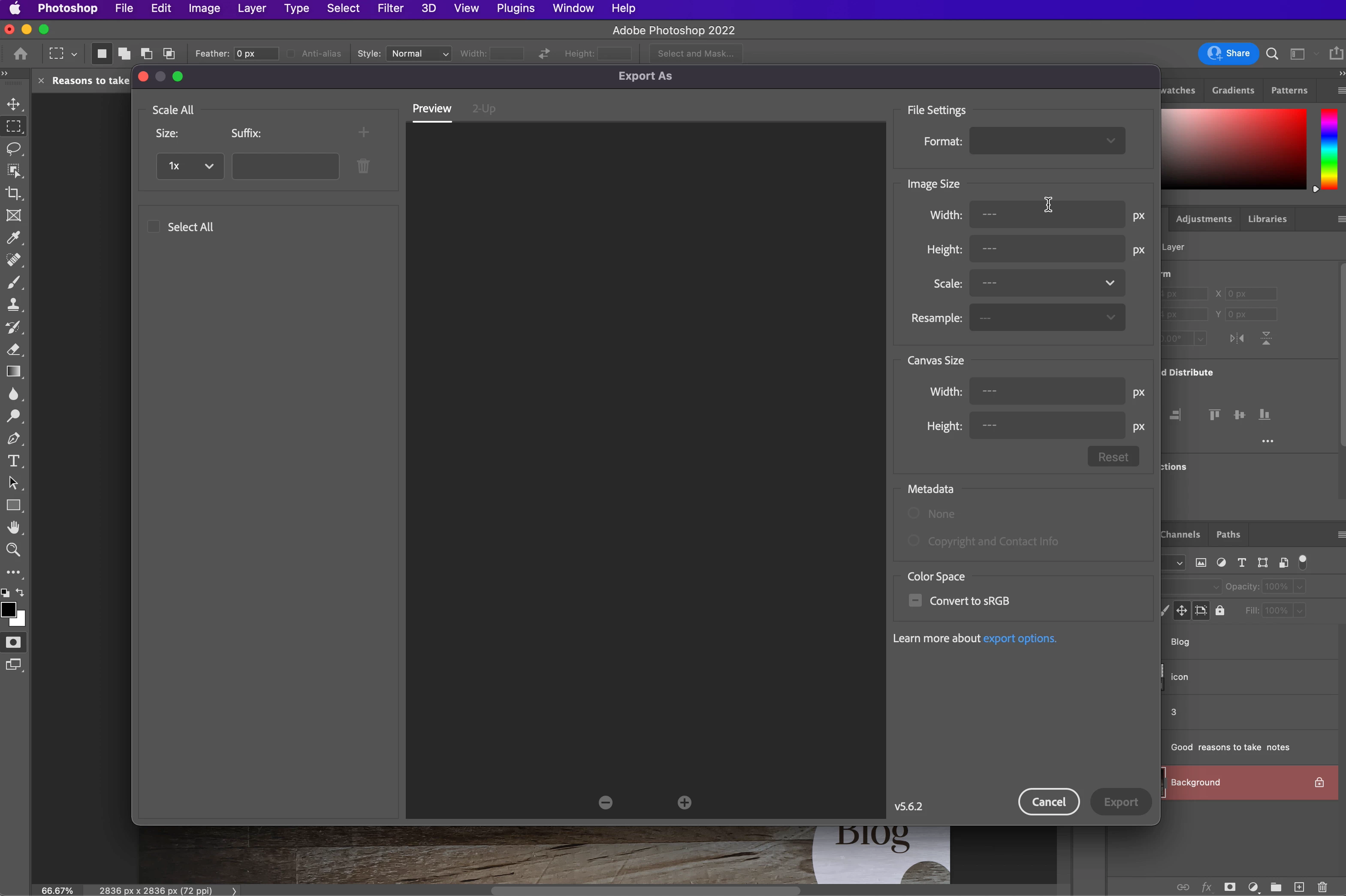

I'm having the issue where my Export doesn't work. Export As doesn't load the graphic, Quick PNG Export does nothing - neither give any error message nor any never-ending load screen.
I've tried the pref reset, Cmd-Opt-Shft while loading Photoshop. No change to the issue.

@defaultl21823xajrr1 This is a workaround not a fix.
Whenever you use a "Legacy" option, you are switching to an older codebase within Photoshop (which may contain bugs that won't be fixed, performance issues, or other problems). For Export As specifically, you are switching from the UXP (current, under development code-base) to CEP (the old, on the way out code-base). While the dialogs look similar, they are completely different (like changing from one version of Photoshop to another). This option gets you around the problem, but the problem remains and may lead to future issues.
The current fix for this behavior is remove the damaged pref.txt file. We're working internally on a more robust solution for a future update.

I went to preference> export> use legacy export. That fixed it,

Recently my Export As window has not been working, every time i click export as, it pops up and the ui apears but nothing is there and I cant export anything. I can how ever quick export which is the odd thing. I have tried everything including updateing photoshop to its current settings but the issue still persists. I have found one fix but I belive its a compromise, I can export only if I am using the legacy export settings, which im fine with but I asume they are not as good since they are labeled as legacy.
