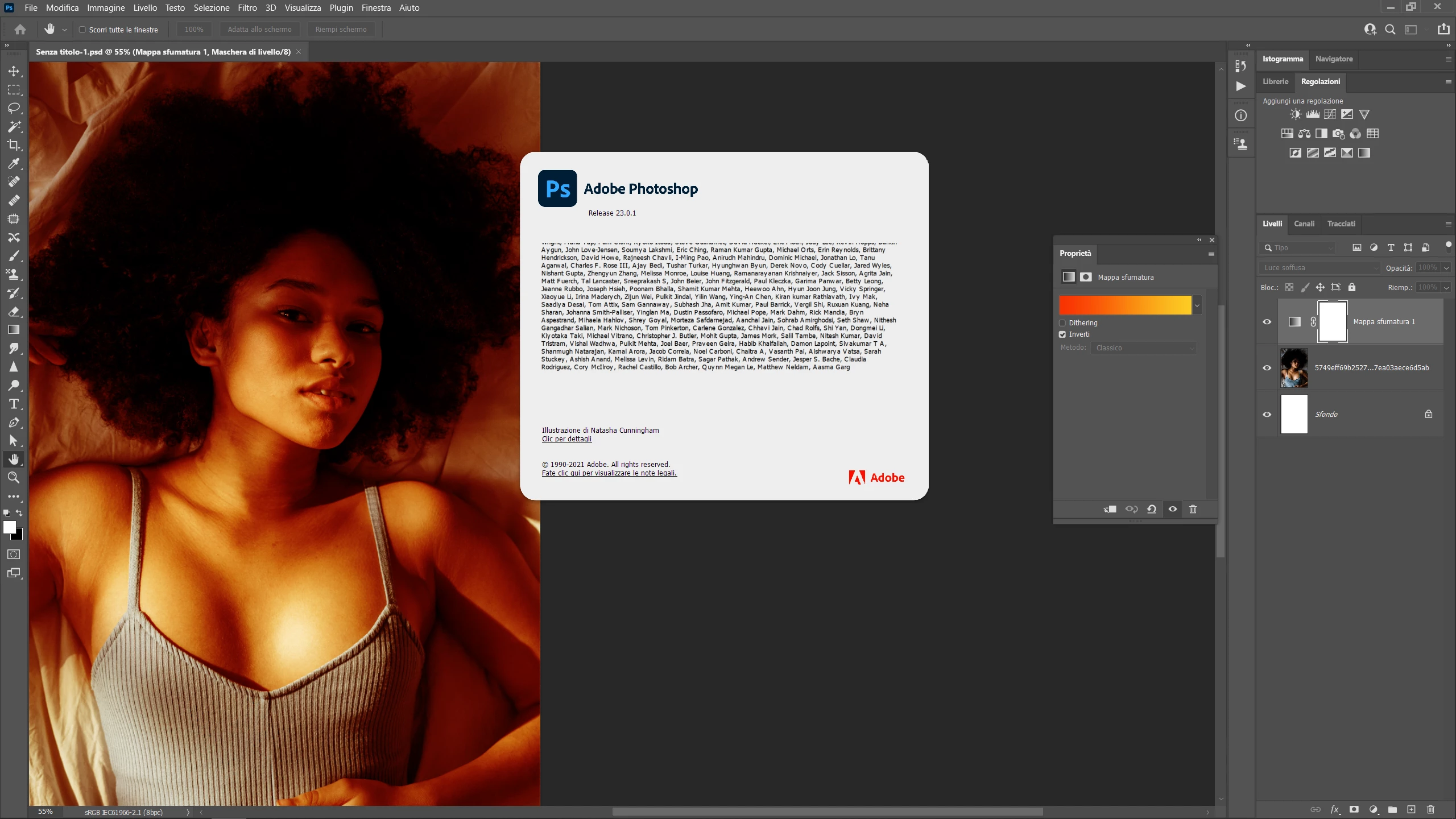

In this one you can see that the gradient map is in classic method

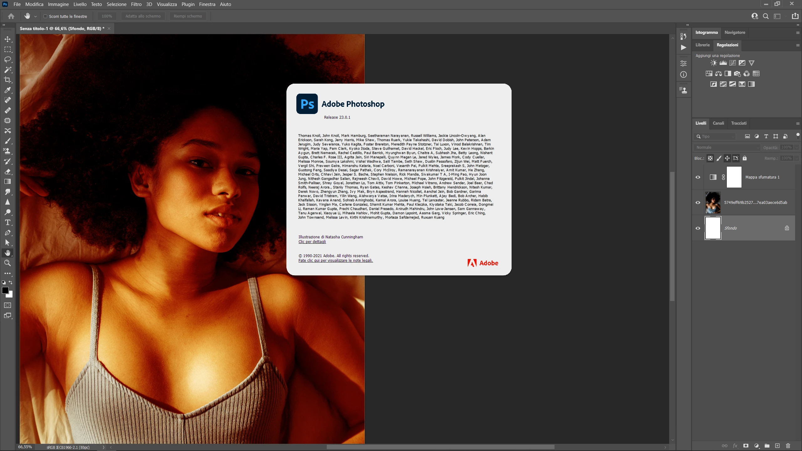

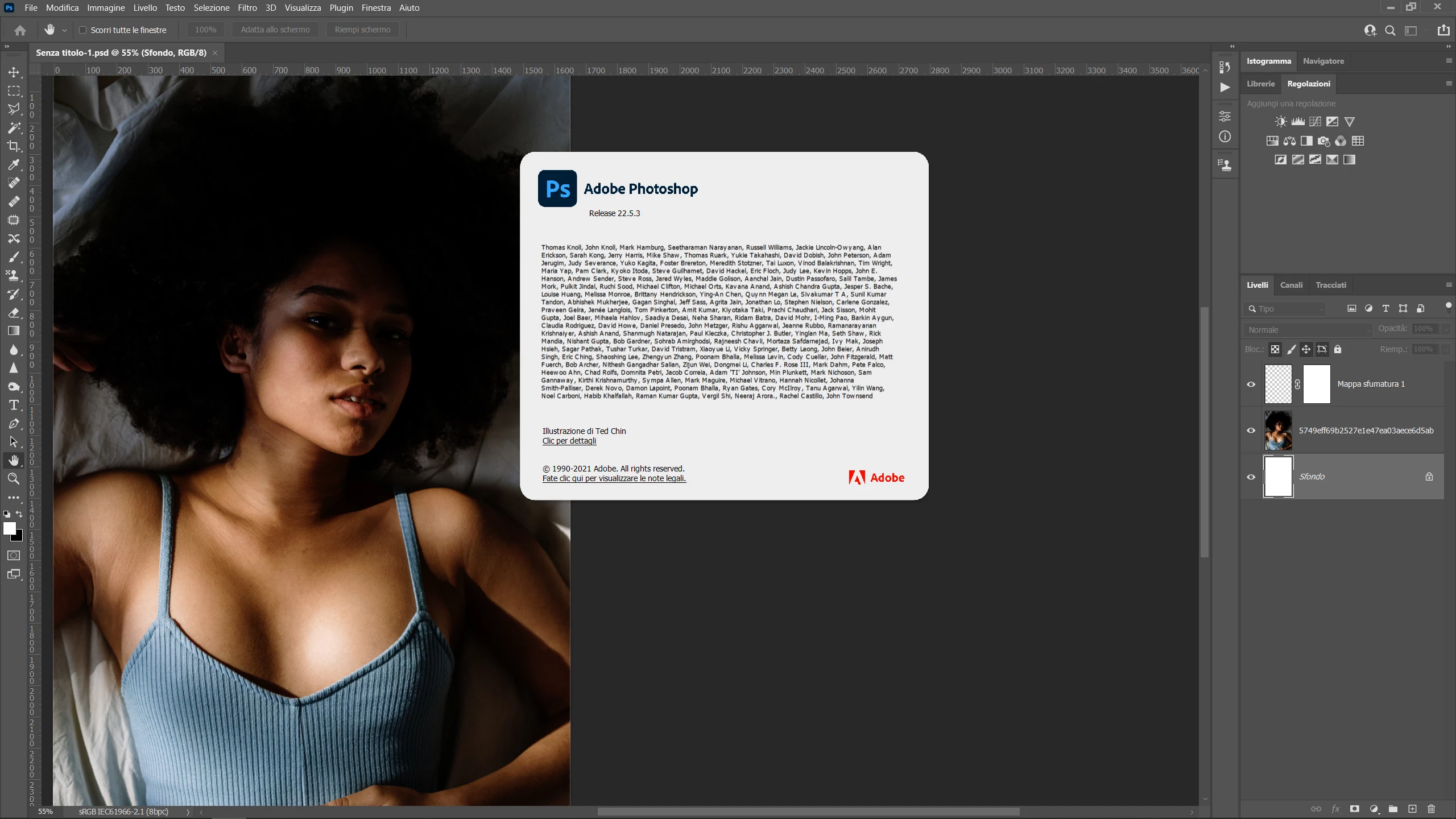

Not in my Photoshop and, as said by other users, I'm not the only one. I leave you two screenshots just in case may help. My App versions are in italian.
