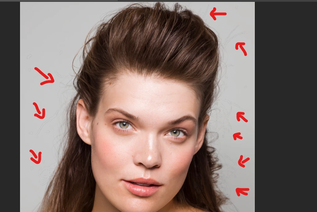

P: Healing brush pixel artifacts
Just upgraded to PS 24.1.1 on an M1 Pro MacBook Pro and am seeing some pixel edge artifacts with the healing brush (see attached). Legacy brush doesn't seem to be affected and I'm not experiencing any problems with the clone stamp. Anyone have some ideas?

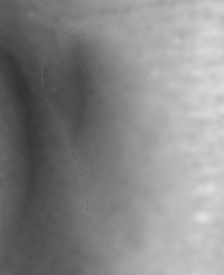

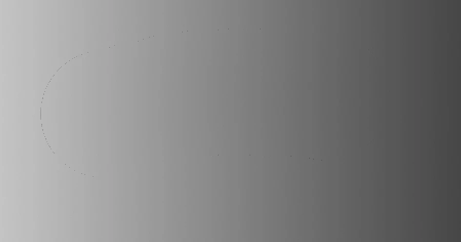

February 14, 2023
Not a problem @CShubert I appreciate the help. To answer your questions, yes it appears in exported files (see attached), and it occurs regardless of whether I use the healing brush on the pixel layer or on another layer with Sample set to Current & Below or All Layers.

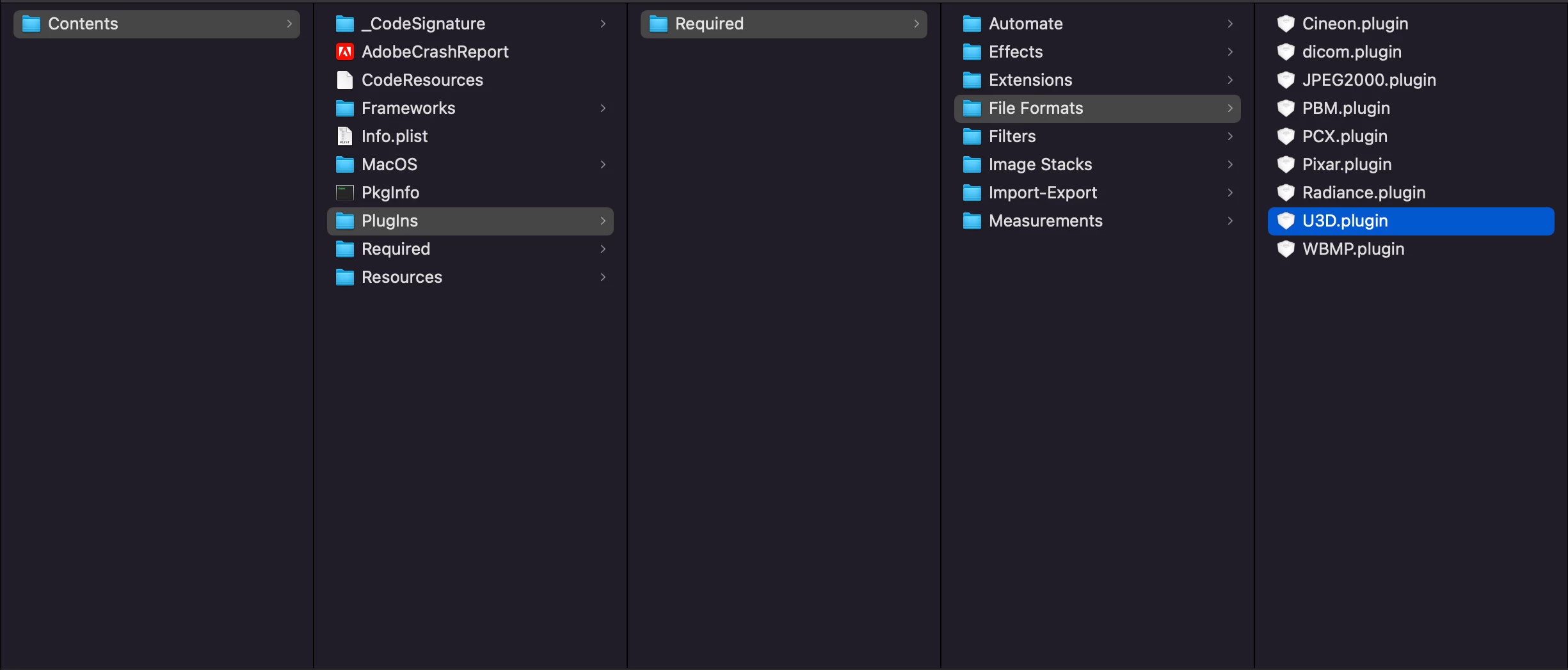

February 14, 2023
@CShubert
Thanks for the link however, these instructions are intended for situations where their customer installed this plugin. This isn't a plug-in that I installed. It's location inside the app bundle suggests it ships as part of Photoshop.
/Applications/Adobe Photoshop 2023/Adobe Photoshop 2023.app/Contents/PlugIns/Required/File Formats/U3D.plugin/
CShubert
February 14, 2023
February 14, 2023
@CShubert That plugin is located inside the Photoshop app bundle. How would you suggest disabling it?
