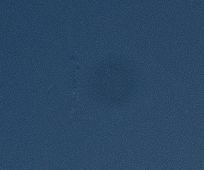

What happened was very frustrating, yesterday after an hour with a patient agent trying in every way to resolve this healing malfunction, checking and unchecking several checkboxes in the advanced settings with no solution, he suggested that I do a chat with advanced specialists. After 3 chats with 3 experts working on the machine remotely, one of them had the courage to tell me that the best way to fix the CCD dirt spots would be to use another tool. Let's face it, the tool worked perfectly in previous versions, why now after so much evolution are we seeing so many problems? There is no point in advancing with generative or artificial intelligence tools and giving up the basic functionalities that were perfect. I hope Adobe can resolve this issue as soon as possible in the next update. Let it be quick.

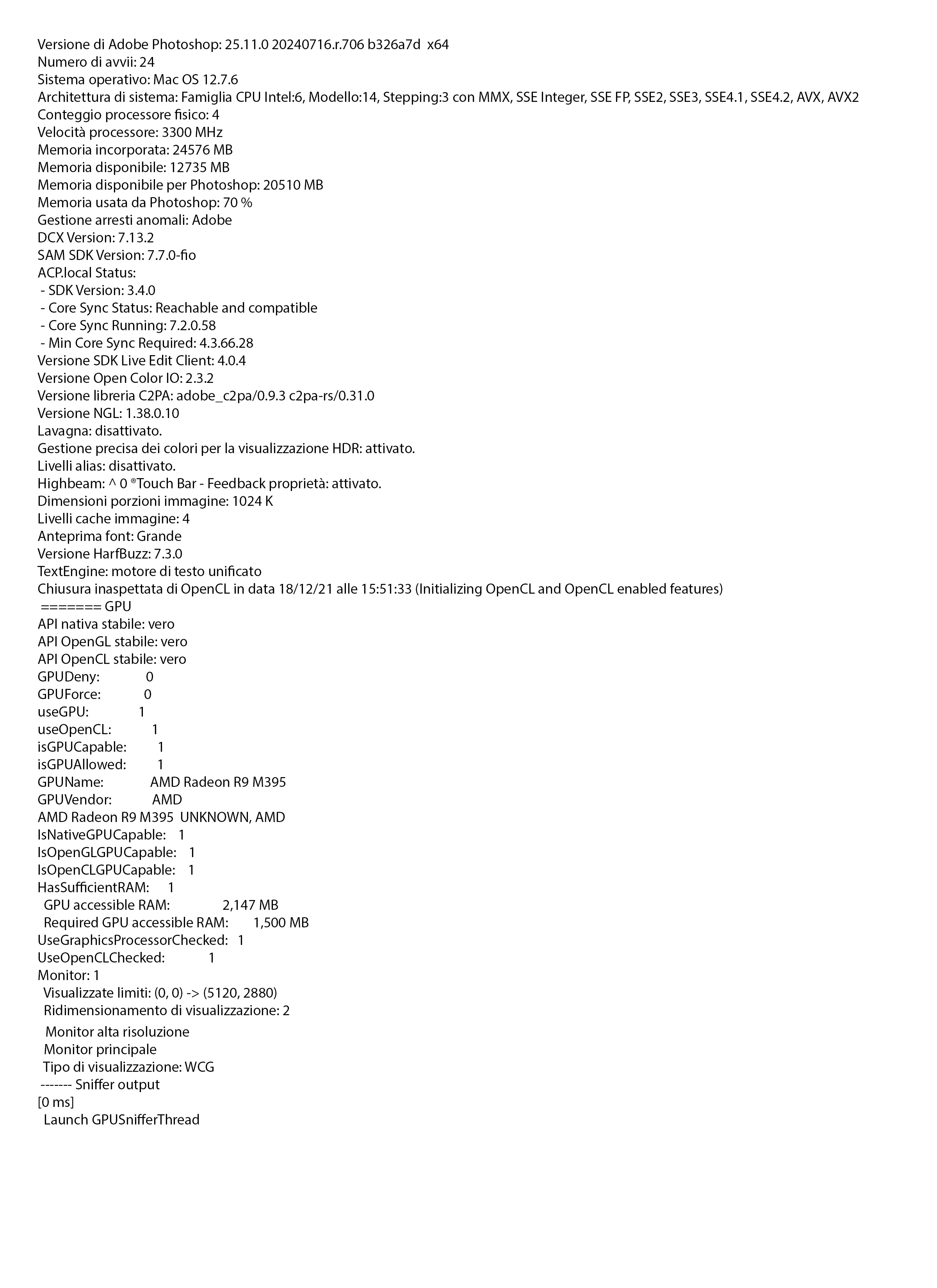

Photoshop 25.11.0
macOS Sonoma 14.6.1

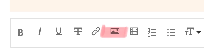

@Gabor Lenart  wrote: How do I attach a file here in a comment?
Tap the Insert Image button in a Reply window. Don't reply by email, as the forum software strips out attachments in email replies.
