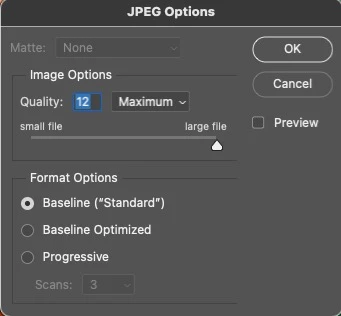

Quick Export of 7 is not the same as Save As 100%
100% of what? When saving a TIFF (as an example) to JPEG using Save AS... , I can set the highest quality to 12.
Indeed, on this end, Save As.... 12 (setting above) and Quick Export (7 in preferences) aren't the same.
But Save for Web (Legacy set to 100) and Save As.... (set for 100) are the same.
So there are no less than these four options, there is Quick Export, Export As, Legacy Save for Web where 100 IS an option, and Save As... What you wrote above was "Save As".
So what's what here?

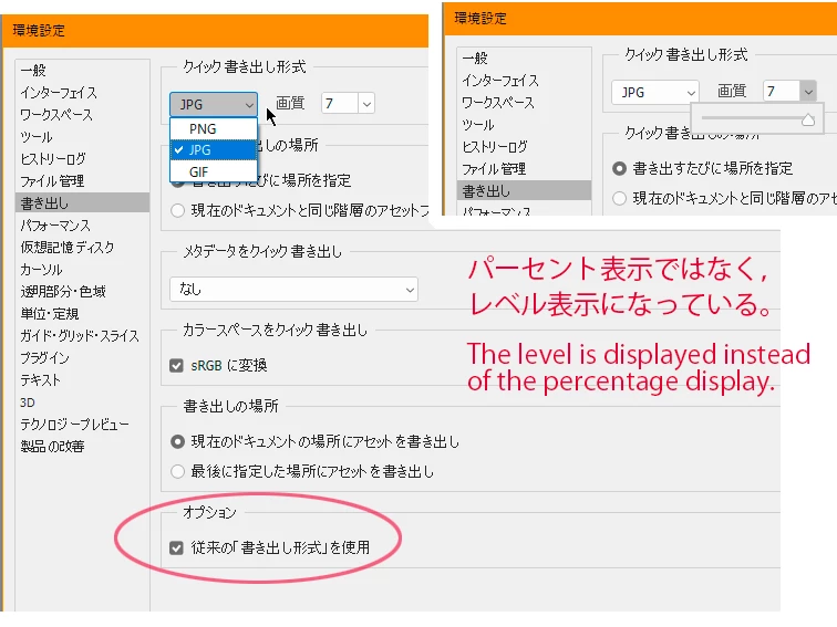

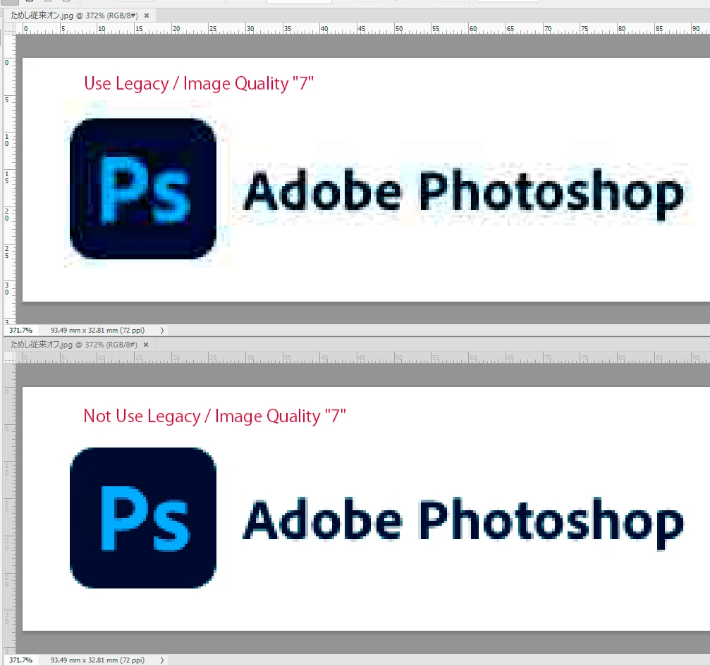

「クイック書き出し」のJPGフォーマットについてです。
Photoshop v23.3 では,環境設定で「従来の「書き出し形式」を使用」にチェックが入っていると,「クイック書き出し」したJPG画像のクオリティが著しく低い。
画質レベル「7」,つまり,最高画質にしても汚い画像しか書き出せないので,改善してほしい。
また,画質レベル「1 - 7」で設定するのではなく,v23.2.2 のように「1% - 100%」で設定できるようにしてほしい。
(Windows10)
katayanagi51
Apr 17, 2022 4:25 AM UTC
んー。マージされてしまいましたが、問題としているのはそういうことではないので、不本意です。
23.3では最高画質に設定しても「従来の「書き出し形式」を使用」にチェックを入れていると使い物にならないJPGしかクイック書き出しできないので、23.2.2の状態に戻してほしいのですよ。

@katayanagi51, the recent changes to Export As regarding JPG quality are discussed in this thread and this seems the appropriate place to continue this same discusion, which is why the post was merged.
A while back, we changed the default method of using Export As to working with the new UXP-based method. The older CEP-based method (which used to be the default) is now activated by enabling the "Use Legacy" option in Preferences.
One of the big differneces between the two methods is the Quality setting for JPG files. In CEP, it used a API which allowed for a 1-100% quality scale, which is similar to the one used by Save For Web. UXP has an API which only allows for a scale of 1-7, which is similar to what is used in Save As. This scale is equivalent to approximately 15-20% jumps on the old scale. So 7 on the new scale is the same as 100% on the old, 6 is around 80%, and so on. Unfortunately, this is not something we can readily change, we are reliant on another piece of technology for this feature and are currently restrained by its limitations.
The 1-7 scale is a more recent UI change, from the old descriptors scale (Poor, Good, Great, etc). We only changed these labels to numbers, to make it easier to understand. We didn't change anything at all about the underlying JPG compression: 7 is exactly the same as Great and so on.
In your screen shots, we see exactly what we expect to see: 7 (from a scale of 1-7) in the new UXP settings ("Legacy" setting is off) is high quality. But 7 using (from a scale of 1-100) in the old CEP settings (Legacy is on) is low quality.
