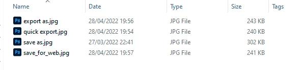

clifton, there is something wrong with your settings somewhere. I'd recommend a preferences reset.
All four methods produce the same sizes at maximum quality (whatever that happens to be):
The only slight difference is Save As, which is slightly larger - perhaps due to metadata, which the other three strip. Note the original date is retained.

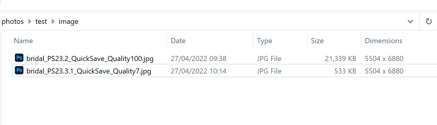

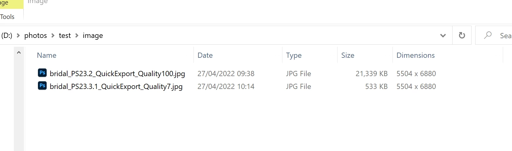

Instead, today, I installed PS version 23.2 and used the Quick Export maximum settings there, then re-installed 23.3.1, and used the Quick Export maximum setting there. Below are the results.

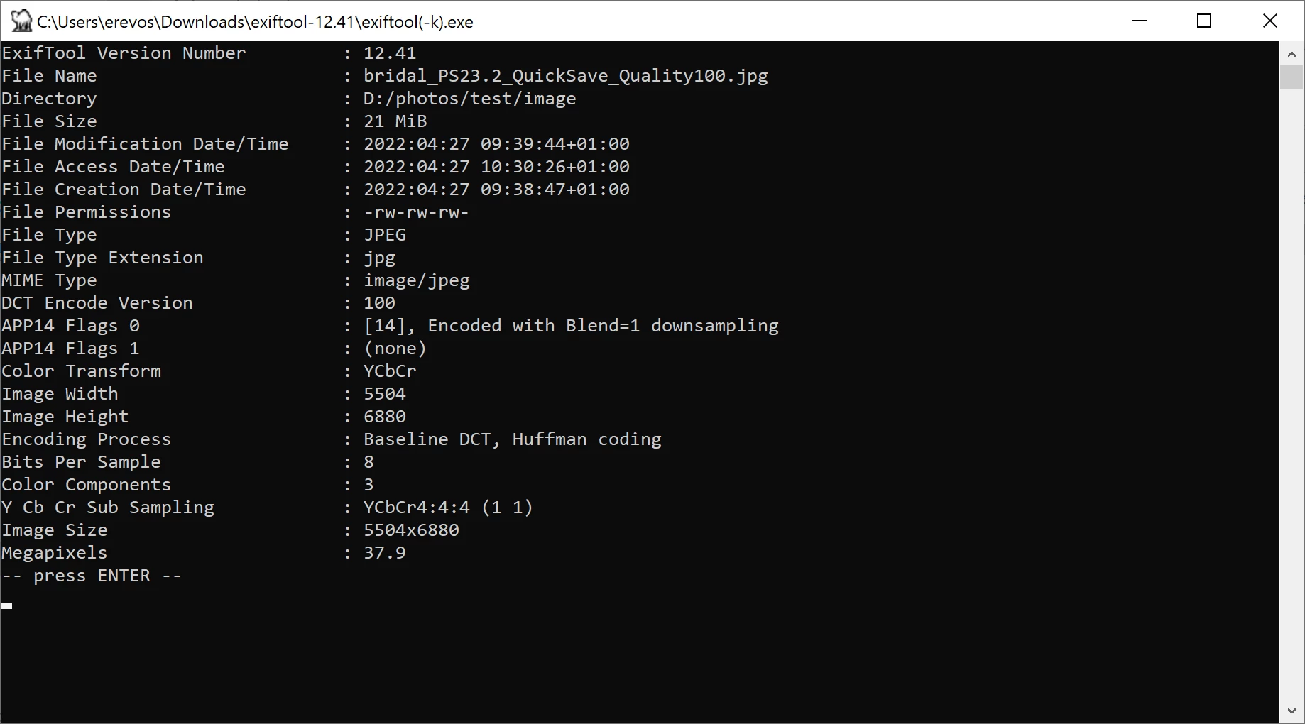

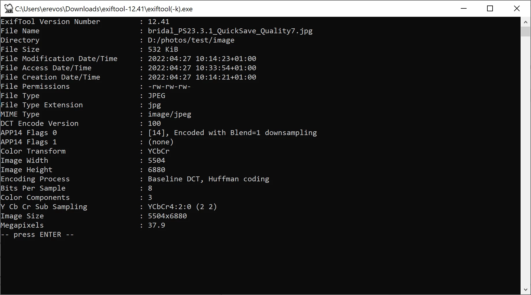

And here is the exif of each one:

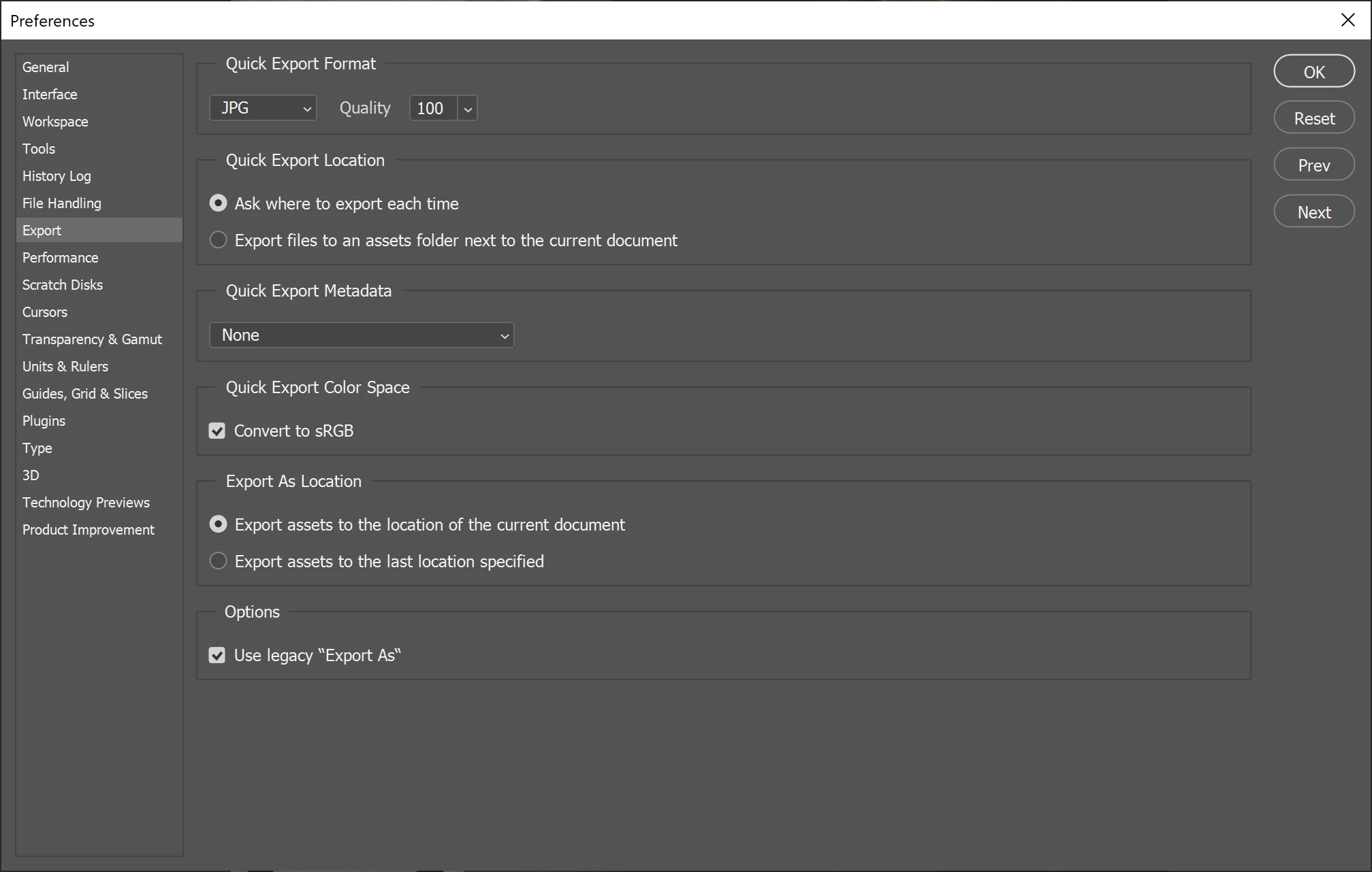

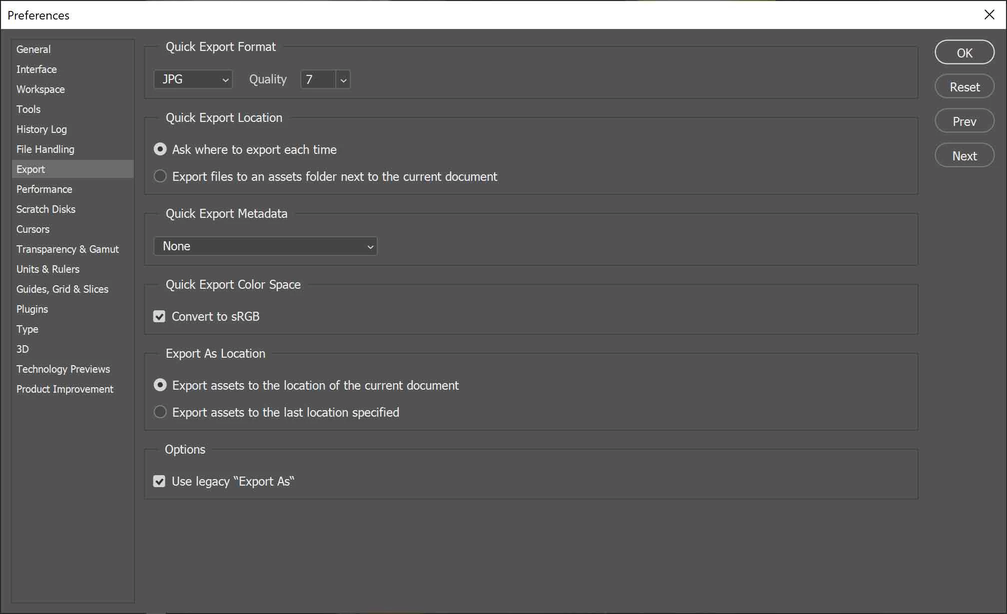

Also, here are the settings used. First 23.2 at maximum (100), second 23.3.1 at maximum (7):

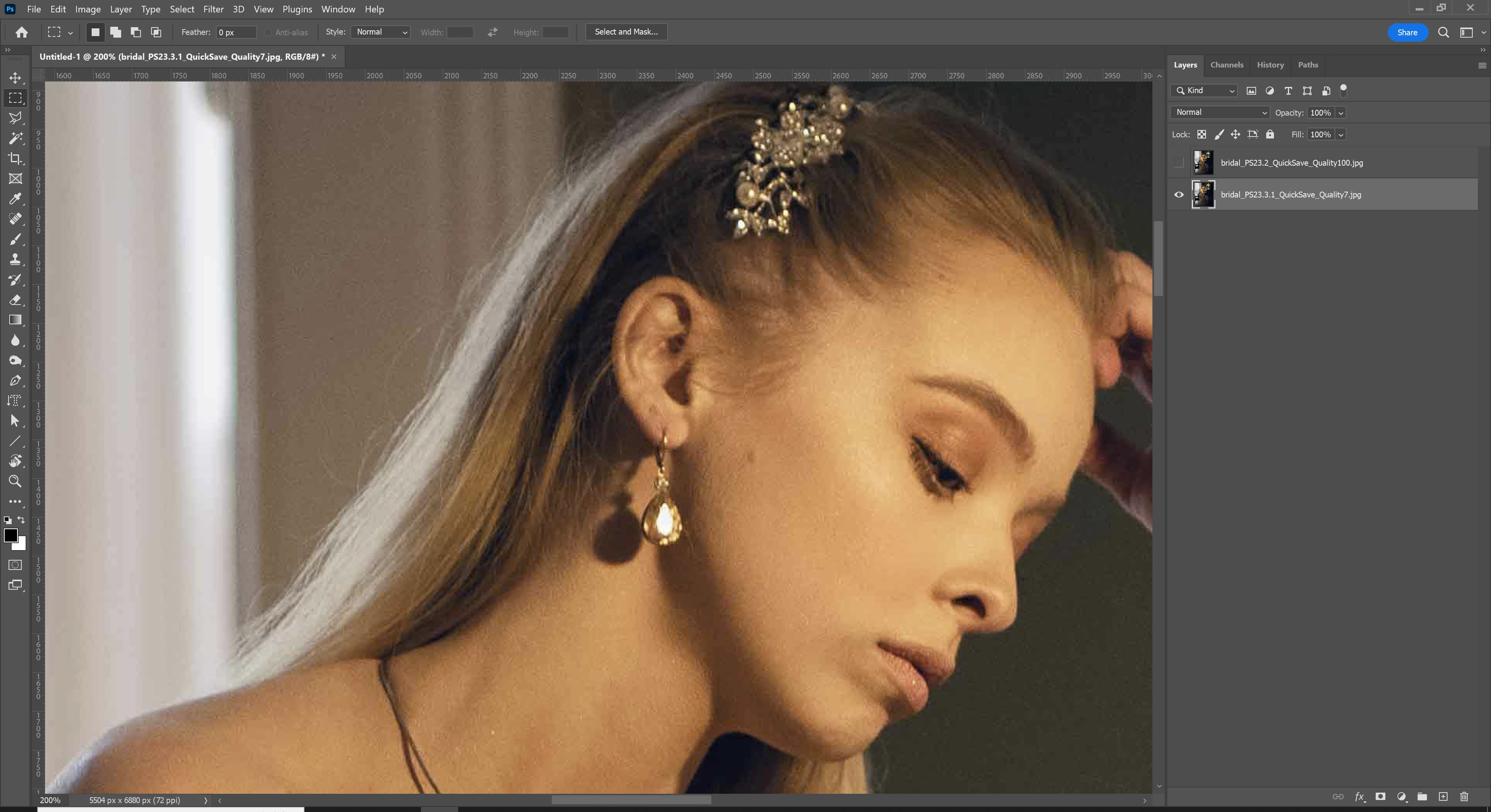

Okay, and the visual evidence. First, PS23.2 version, Quick Export 100 (maximum):
Second, PS23.3.1 version, Quick Export 7 (maximum):
Its obvious that the second is much more lossy than the first, as one would expect from a file so much smaller than the first.

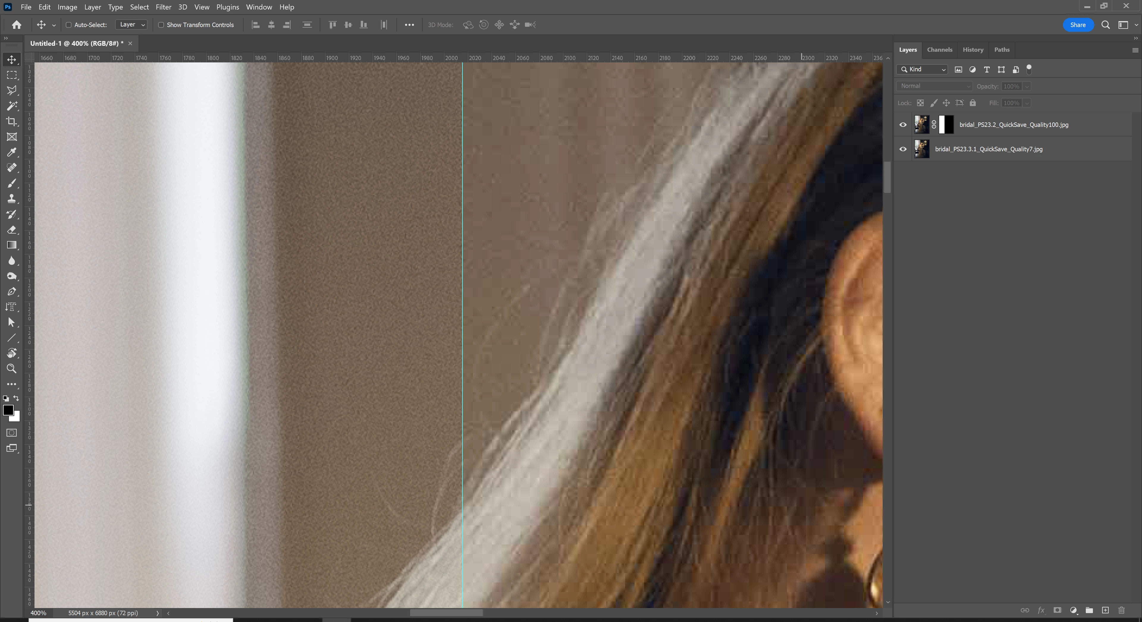

Here is a close-up if these are not obvious enough. As you can see from the layer name, the left is Quick Export 23.2 maximum, the right is Quick Export 23.3.1 maximum.
In summary, I propose that Quick Export maximum settings in PS 23.2 should look exactly the same as in PS 23.3.1. Instead, Quick Export in 23.3 and later, is much lossier at maximum than previously, as also indicated in the much smaller file size. I figure this must be unintentional, which is why I suggested it was a bug.
Of course, the work around is to use Export As legacy, at 100% to achieve the same quality as Quick Export 100% in previous versions.
