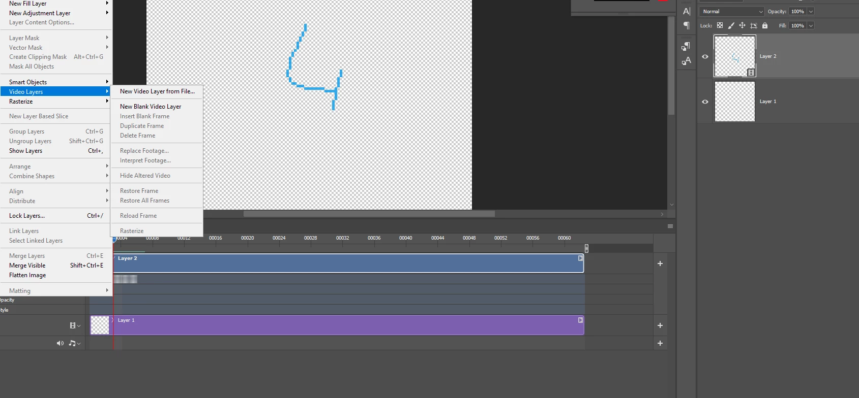

Also, I noticed that most menu items from Layer > Video Layers are blanked out if you only select the layer in Timeline tab - although the layer appears selected in both Timeline and Layers tab.
It works once you select the layer from the Layers tab (see image below).
I can't tell if that's specific to some setting on my side.
