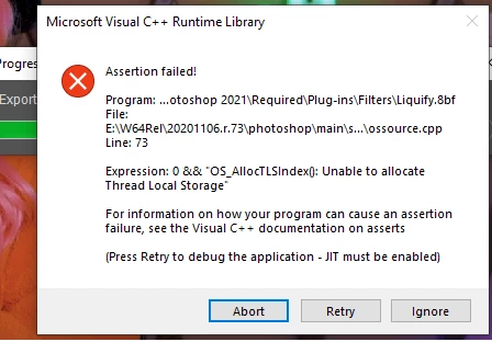

P: Liquify on video crashes on export / render video.
I have a 37 sec, 1080p, 60fps video that I applied smart filter on with liquify settings.
My pc spec: ryzen 9 3900x, rtx 2060 6GB, 64gb ram.
When export/rendering it after a while it crashes. As for now, I have latest photoshop and nvidia drivers.
It also crashes on my second computer.
BTW, I don't have E: disk, so no idea what that error refers to.
It doesn't crash when I just export the video without liquify.

Hi, yes, after recent update it is fixed, thanks.

Hi Kamil,
Could you please confirm that you are using the 22.1 build if not can you please update to the latest build and then try this issue as we upgraded the DLMS version in 22.1 and I am not able to reproduce this one on the 22.1 build but I could reproduce this on 22.0.1

December 1, 2020
So I have divided the video to 5 second chunks and if I load 5 second clip, run liquify, CLOSE PHOTOSHOP, OPEN PHOTOSHOP, load next 5 second clip it works. If I don't restart photoshop, it crashes in more or less the same place.
