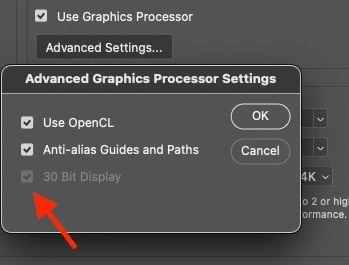

Even though I have this 10-bit test on my Mac, I tried downloading it from Dropbox to make sure nothing funny happened to it (like maybe somehow I uploaded a JPEG etc). Well, it looks as expected on my SpectraView in the latest version of PS on macOS 13.0.1 at 100% zoom.
The 30-bit check box is grayed out, and more importantly, there's a check mark.

The comment about checked and grayed out was interesting. I'd be happy with that, but to be paranoid I confirmed that in PS23, it is still grayed out and not checked.

I have an M1 mini and that 30-bit box is checked and greyed out. I do not have a 30-bit display. How are you connecting- USB-C or HDMI?
