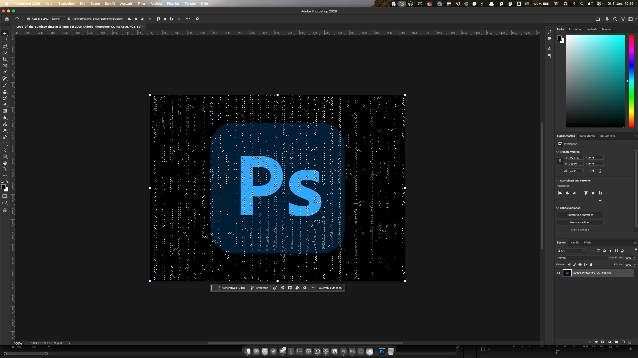

P: MacOS 26.3 (Beta) PS 27.2 Select Subject failures & Remove background creates artifacts
  • January 4, 2026
  • 19 replies
  • 697 views

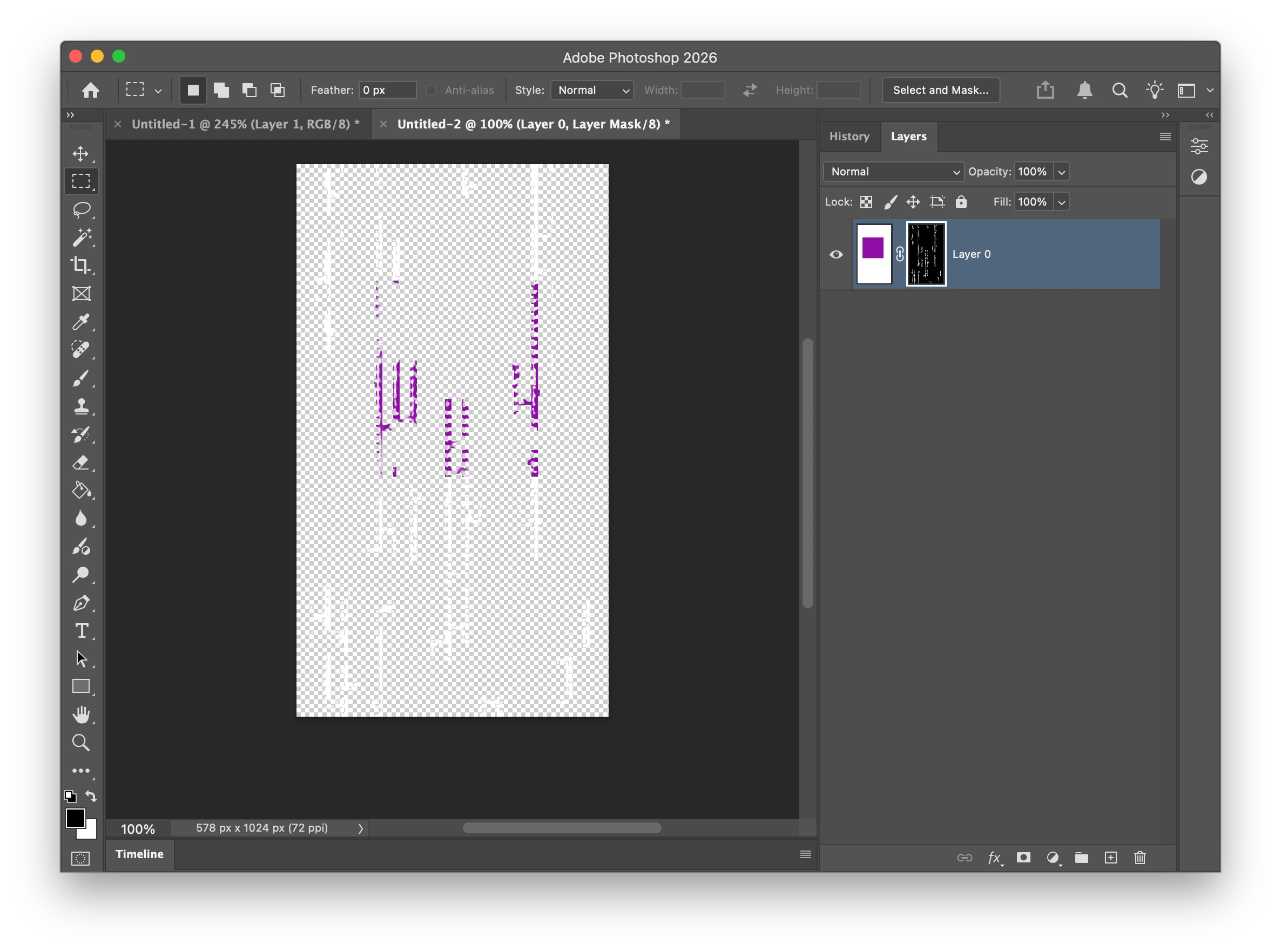

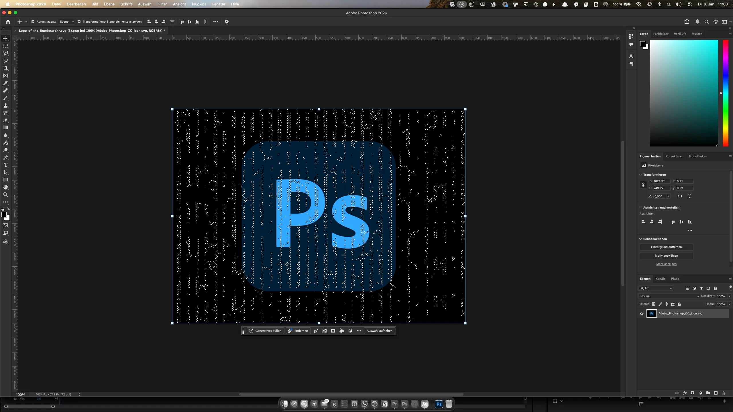

When removing the background, this happens with every photo.
The same error appears when using Object Removal as well.
19 replies

This is happening with any image I remove the background from. Any ideas why?

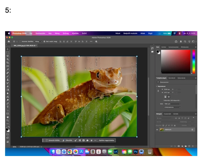

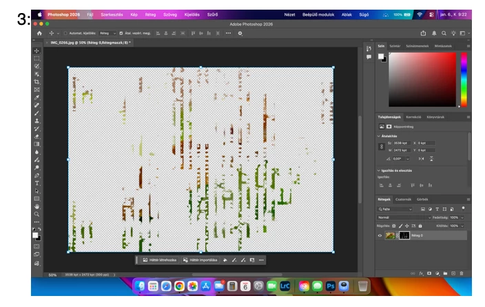

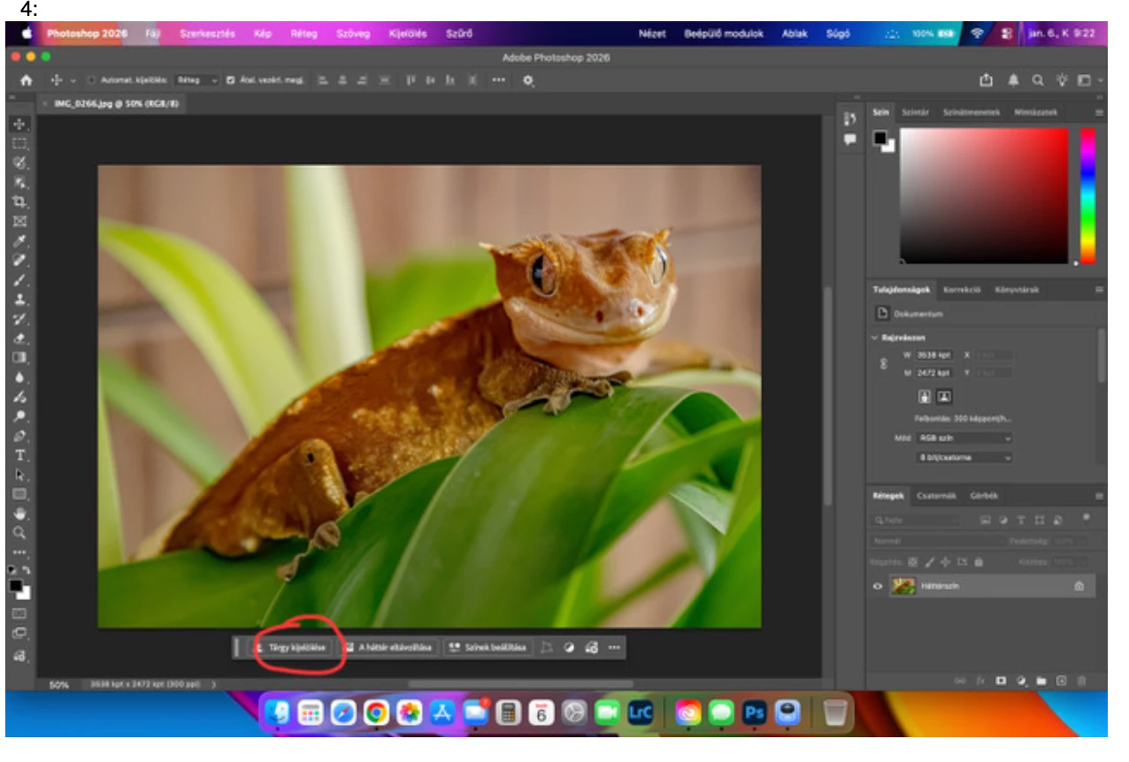

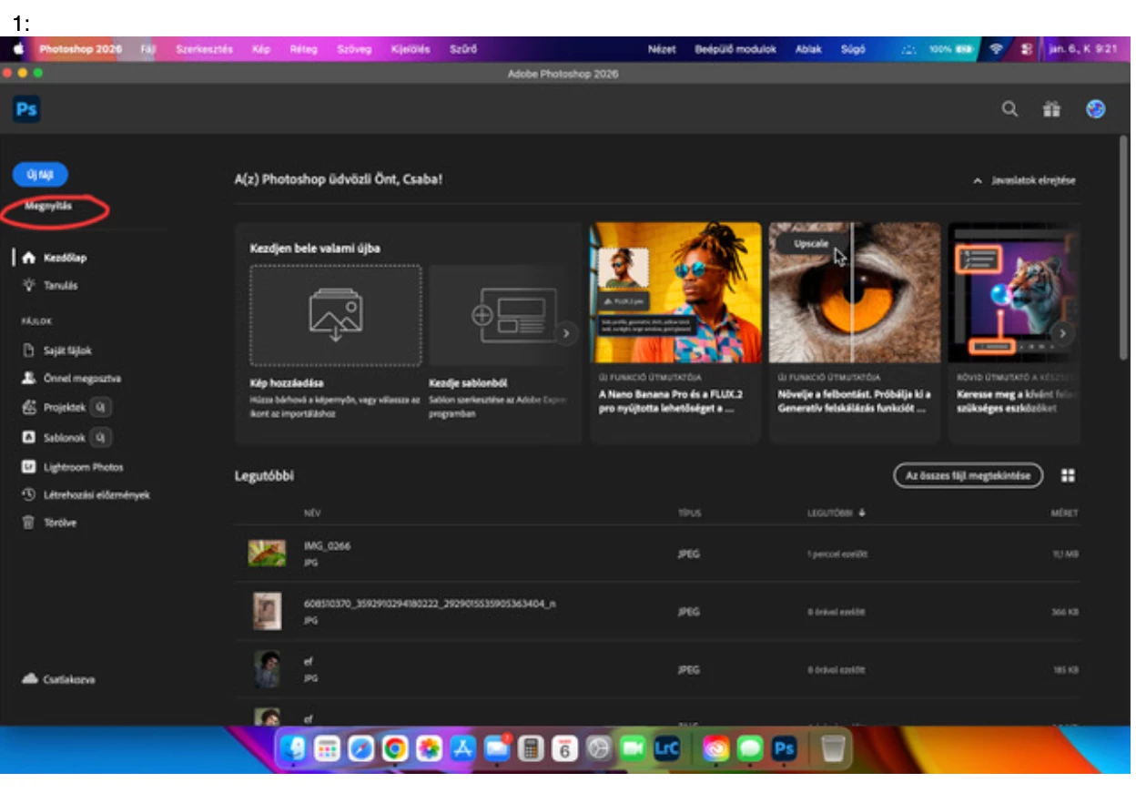

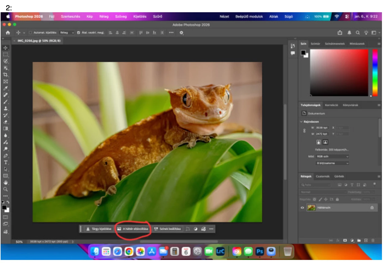

Hi everyone,
I’m having an issue with Select Subject in Photoshop.
When I click Select > Subject, Photoshop doesn’t select the actual subject.
Instead, it selects a completely wrong area, as shown in the attached screenshot.
What I’ve already tried:
Cleared Photoshop cache
Cleared Photoshop AI cache
Cleared Camera Raw cache
Deleted preferences
Completely uninstalled Photoshop (without keeping presets)
Fresh reinstall
Unfortunately, none of this helped. The behavior stays the same.
Has anyone else experienced this issue recently?
Or does anyone know what might cause Select Subject to behave like this?
Any insight would be appreciated.
Thanks!
