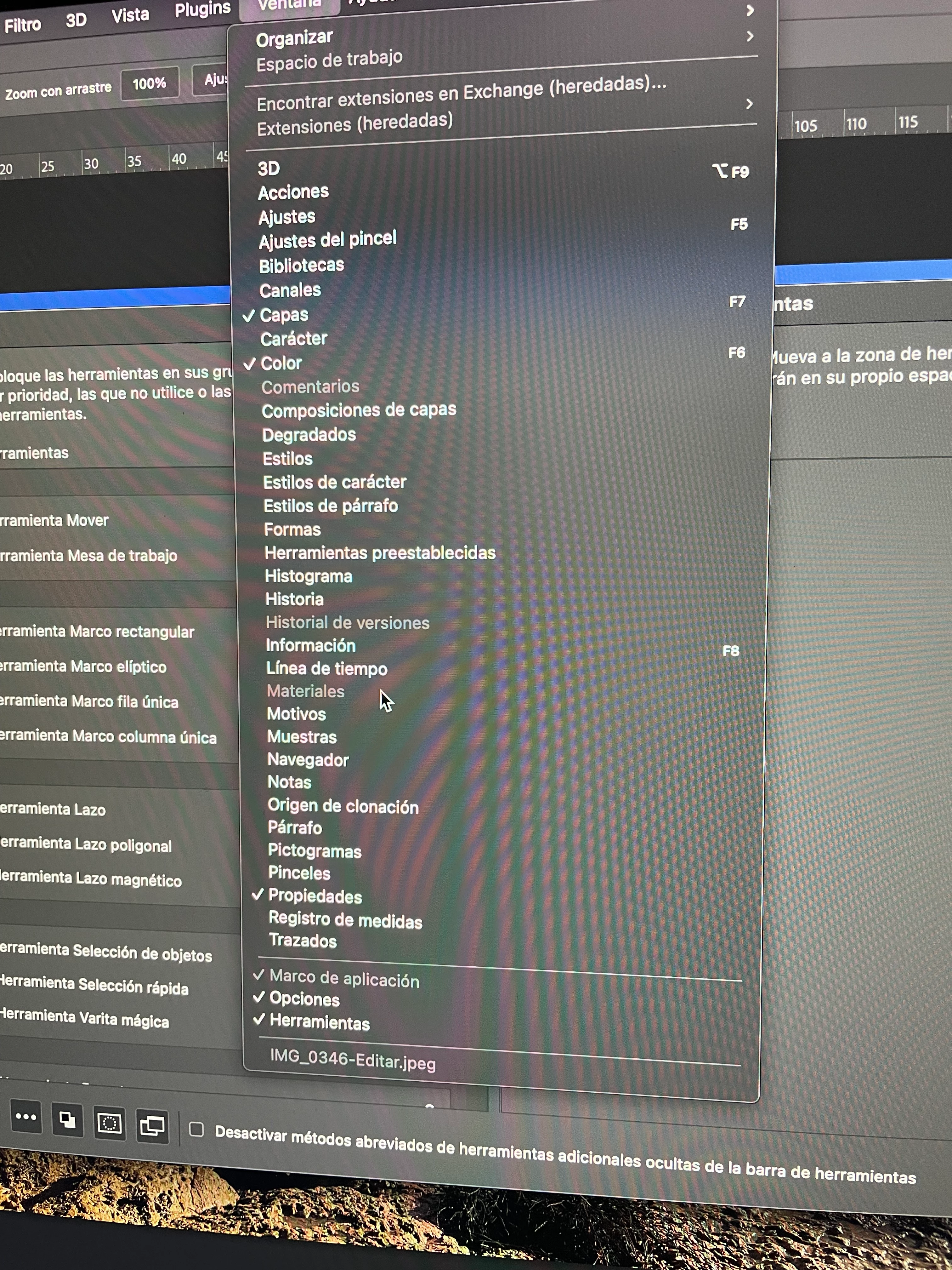

fernandoe82119474
January 19, 2023
estaba esperando la actualizacion a 24.1 de photoshop y veo que siguen los mismos erros .
los materiales no funcionan
que desastre
estoy pagando una licencia y no funciona
que tengo que hacer ?
mi sistema operativo es Mac os.
davescm
January 19, 2023
The fix for the materials panel is rolling out with v 24.1.1. Not everyone has that yet as it is being rolled gradually over a day or so. I don't work for Adobe but I assume that is to avoid overloading the servers.
The version with the fix, which is working here, is 24.1.1 20230112.r.238 (you can check in Help >System info to see which version you have at present)
https://helpx.adobe.com/photoshop/kb/fixed-issues.html   (Take the US option if you are given a choice as the help document for some regional sites, including UK are not yet updated)
