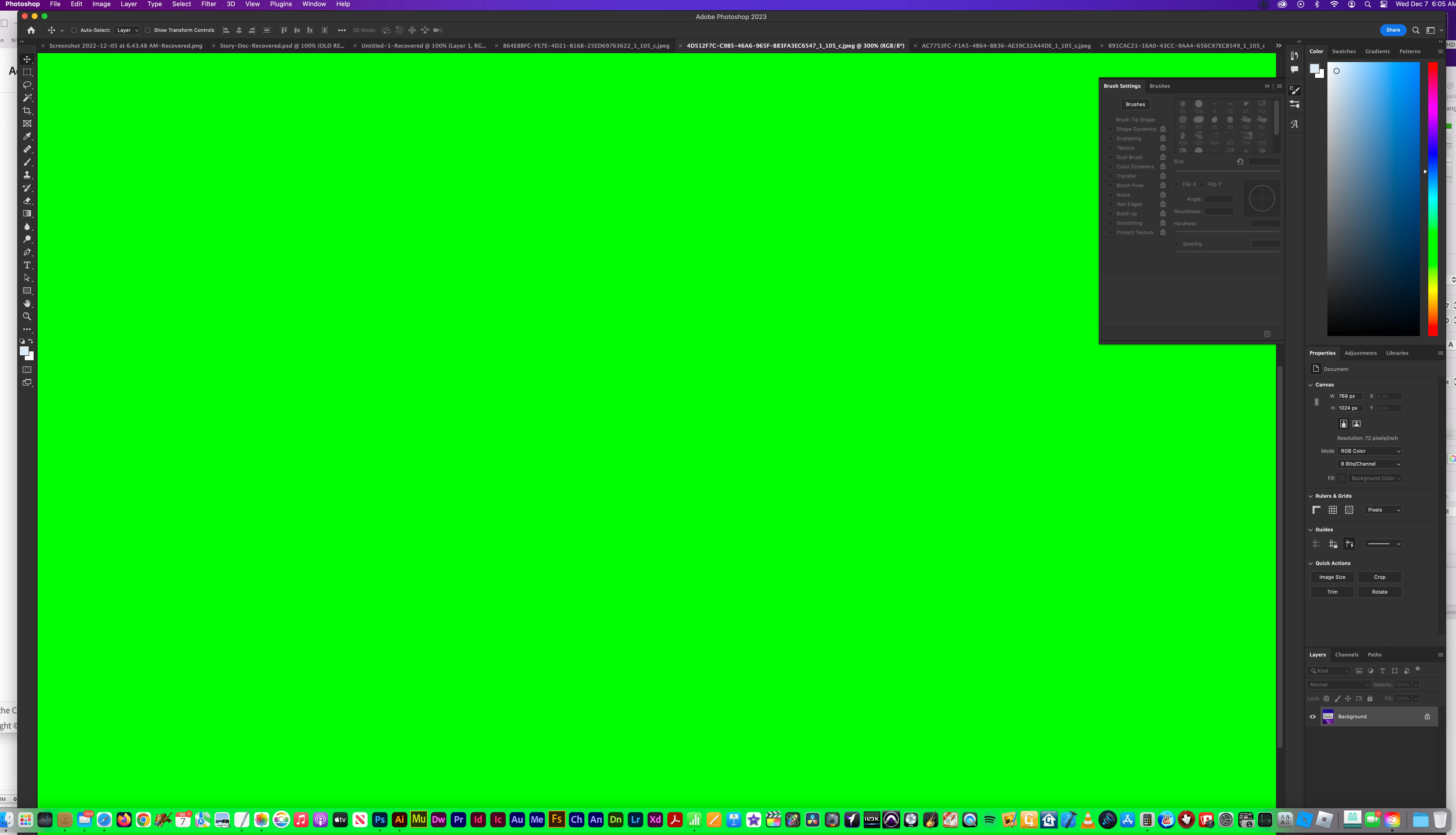

P: Moving Around Workspace causing screen glitching & green background on macOS
So I just downloaded the new 2023 version of Photoshop. Photoshop told me that if I did not have the latest version of MacOS there could be some performance issues, so I made sure everything was up to date and downloaded the latest MacOS. However, now whenever I move around my workspace in Photoshop my screen glitches and I get weird green flashes that make it next to impossible to work.
Zooming in and out using the trackpad/mouse causes this, as well as just moving left, right, up, and down. I purged my cache and still the same issue. Restarted Photshop and my computer, still the same issue.
Someone please help as I have a lot of work to do!

Dec 8, 2022 3:33 PM UTC
We're working with Apple to resolve this issue.
To workaround this issue, click the green dot on the app frame to resize the application frame to fit the new monitor.
Or, go to Preferences > Technology Previews... and check "Disable Native Canvas" - then restart Photoshop.
This occurs when the application frame is larger than the monitor it is being displayed on. This can happen when you're running Photoshop on an external monitor that is larger than the monitor on a laptop. When you disconnect the larger monitor, the app frame is hanging off the edge of the screen.

Oct 25, 2022 4:45 PM UTC
Did the upgrade to 2023 because older version was a little slow. Now, I can't even work. The PS screen/workspace flickers with every mouse movement. Workspace screen doesn't stay on unless I mouse over and then it flickers. Should I uninstall and go install an older version? Running on Mac BigSur 11.7.1
Oct 25, 2022 5:25 PM UTC
In newest Photoshop version 24.0 you have an option in Preferences > Technology Previews > Older GPU mode (Pre 2016). Check that option if you have older graphics card. Restart Photoshop for changes to take effect.
If this doesn't help try to disable the option to "Use Graphics Procesor" from Photoshop by going to Preferences, then Performance. Once done, quit & relaunch Photoshop to check if that helps.
If it helps, you can check out the steps suggested here:  https://helpx.adobe.com/photoshop/kb/troubleshoot-gpu-graphics-card.html
If the issue persists, you can try to reset the preferences of Photoshop using the steps described here:
Preferences in Photoshop (adobe.com)
Please backup your settings before resetting the preferences. You can check:
Migrate presets, actions, and settings (adobe.com)
Another try it to turning on the option »Deactivate Native Canvas« (Photoshop > Preferences > Technology Previews) and restarting Photoshop.
