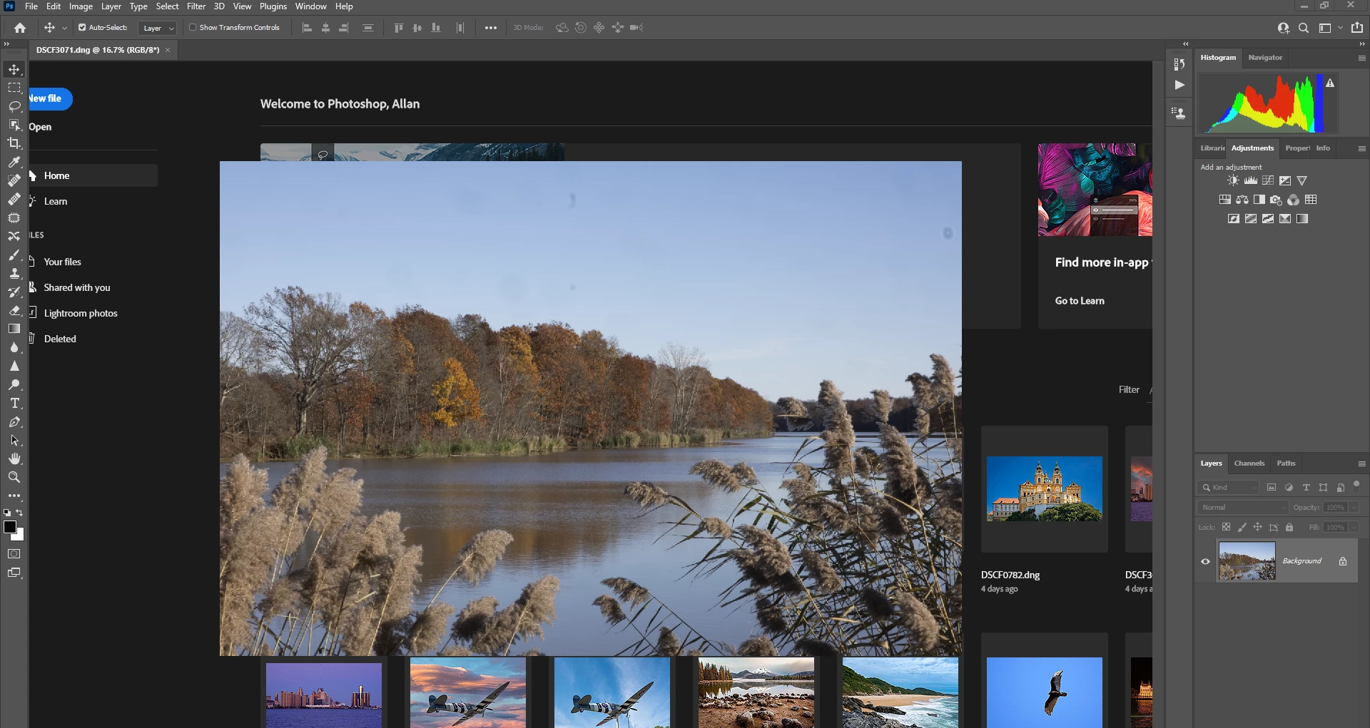

December 9, 2021
Well that didn't work!
I opened a photo, made a few changes in Camera Raw, then applied a Neural
filter (Landscape mixer-Winter scene). It would not allow me to undo the
change and when I chose Cancel l I got the screenshot attached - both the
original photo and the one with the winter scene showed. I was able to
close the photo.
The only thing that seems to work is when the GPU is disabled in Camera Raw
preferences -Performance. Then I can use any Neural filter and undo many
times with no errors.
