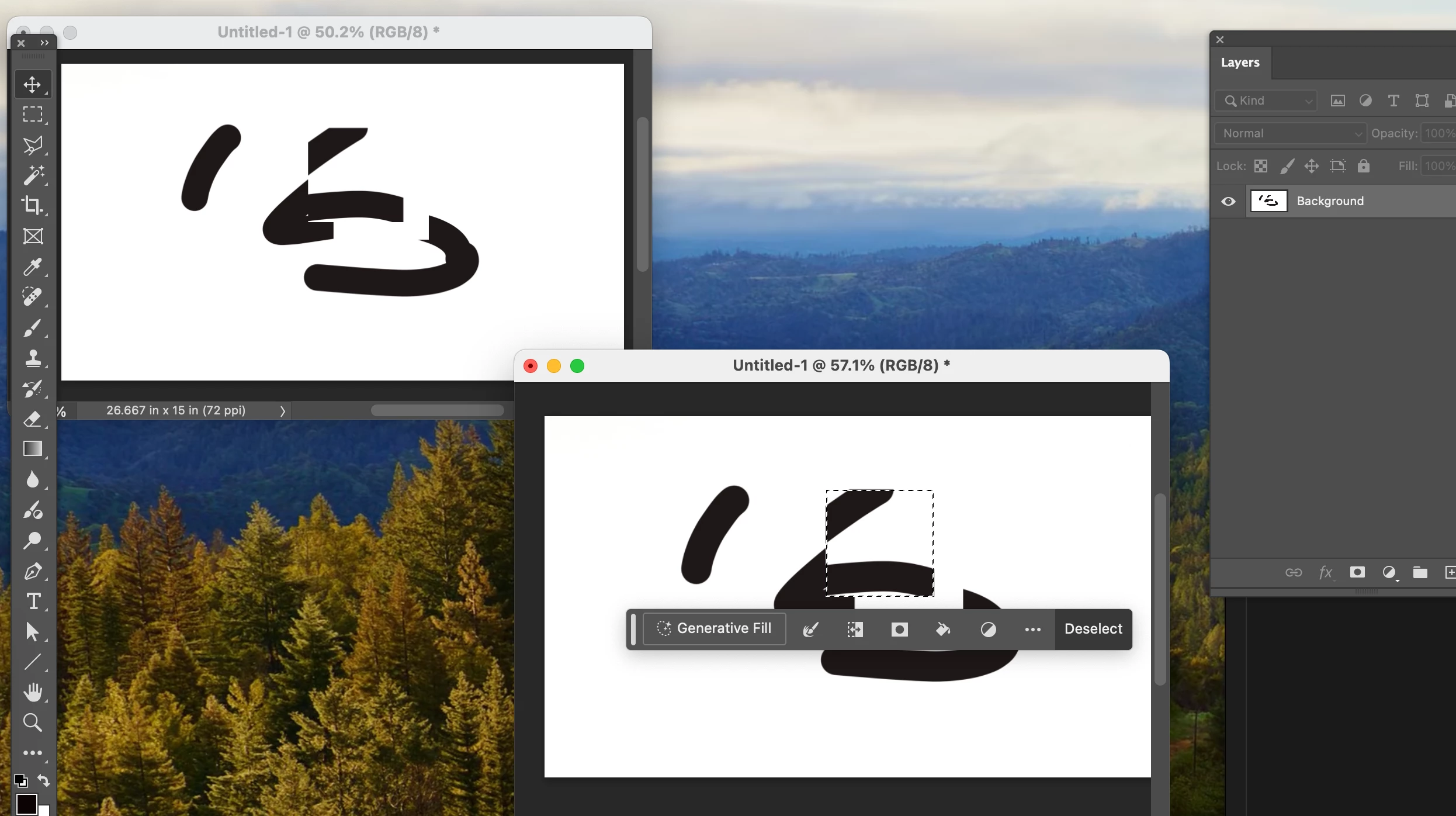

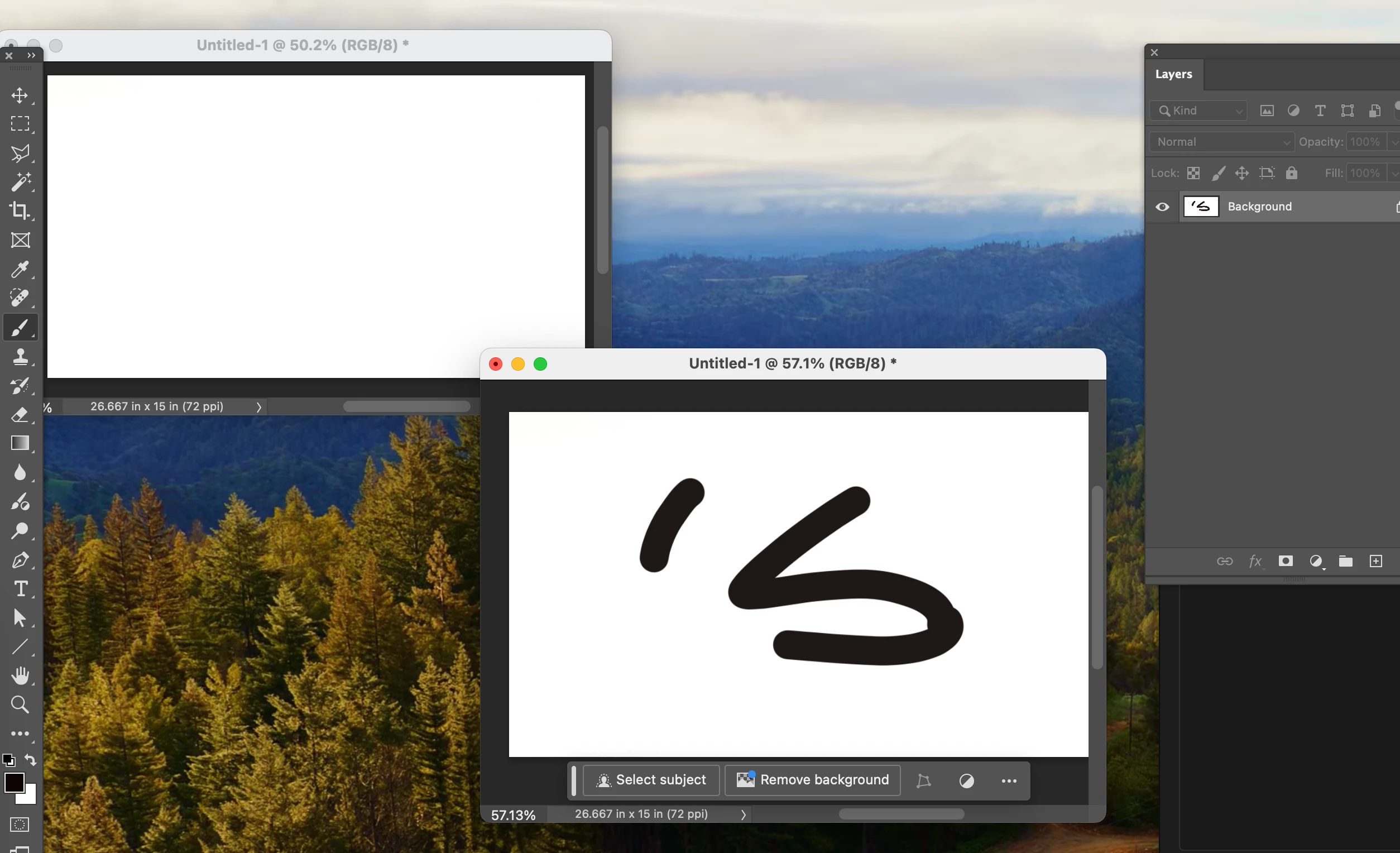

Aug 5, 2024 2:02 PM UTC
Hi, when you activiate a new window in the workspace (so their are two windows of the same document) the brush stroke does not refresh after releasing the stroke (as it used to). All other tools refresh upon release (transform, move, fill tools etc) but brush stroke does not refresh until you use another tool or click into the second window and zoom and/or modify something on the new windows canvas. I have attached screenshots to illustrate:
Canvas not refreshing after release of brush stroke:
Canvas refreshes once a different tool is used other than brush: (in this case, marque/move)

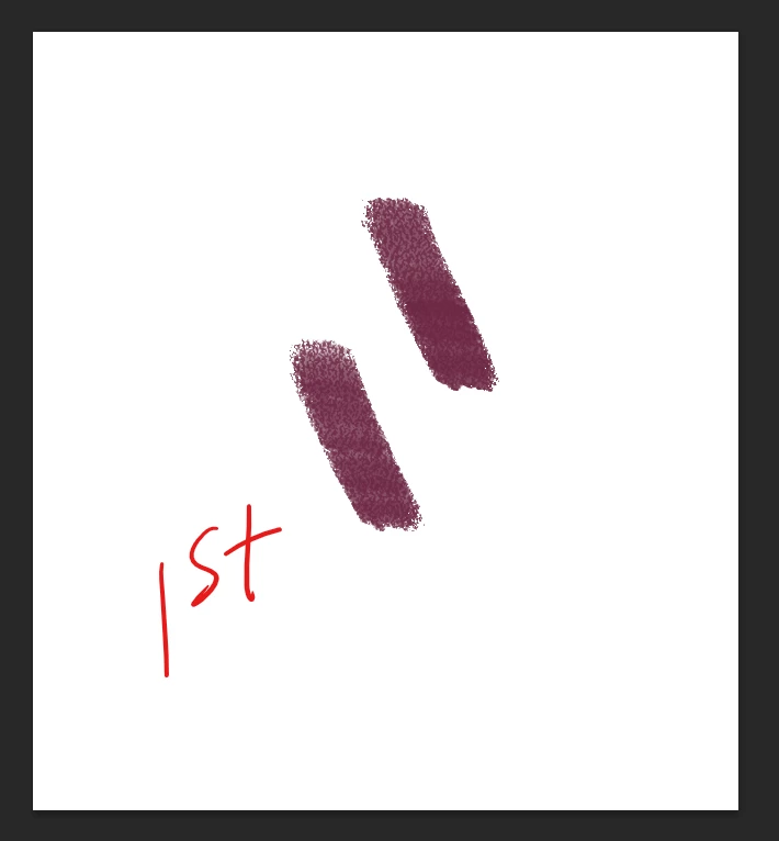

Aug 2, 2024 10:40 AM UTC
Hi, as you can see my second monitor is not responding properly to my first one.
Sometimes it responded after I made about 10-15 strokes, sometimes it did not respond at all (I will have to click on the 2nd window, then I would see all the changes made)
Is anyone having the same problem? Can this be fixed?
