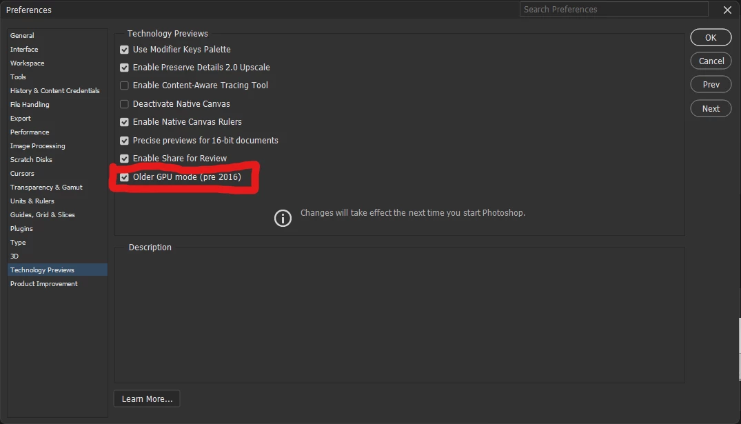

There are temporary fixes, which are 1) checking the box as shown below, in Preferences of latets version, —or 2) you can install the previous version of PsCC, 24.0.1 (what I did), and wait until the next release, which I assume will have 'stamped out' this annoying bug.

Engineering is looking into this issue.
As workaround, go to Preferences > Technology Previews... and enable "Older GPU mode (pre 2016)" - Restart Photoshop.
Jan 12, 2023 12:55 PM UTC
Thank you. Checking "older GPU mode" finally fixed the issue for me.

Jan 12, 2023 12:00 PM UTC
unable this this will fix the problem it fixed for me
