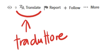

You can read my messages in italian with the tranlator included in this forum (bottom of my message)

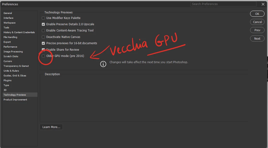

Helma0D45
Mar 6, 2023 2:51 PM UTC
Hi.
Thanks for your quick reply!
Yes!!! I've found it and it works right now!
PacoD
Mar 6, 2023 2:33 PM UTC
@Helma0D45
I am assuming you are looking for "Older GPU mode (2016)" checkbox.
The 'Technology Previews' is the 2nd to last option, from the bottom of the list on the left side of the Preferences panel.
