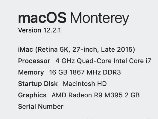

Hi Jeffrey, is this a known issue? Unfortunately, I have the same problem on the latest version of mac. When I worked with a tech-support person they told me that I should update my driver and contact Apple. This didn't make sense because my driver update is included in my latest System update. I'll tried this again, this time I removed the preferences as other people have done and it worked for them, unfortunately even with the default preferences I still have a problem. I downgraded but I'd really love to know what's happening . I have course rather not just spin my wheels with tech-support for hours. Maybe you could pass this on to the engineers.   These are my specs: thanks!
