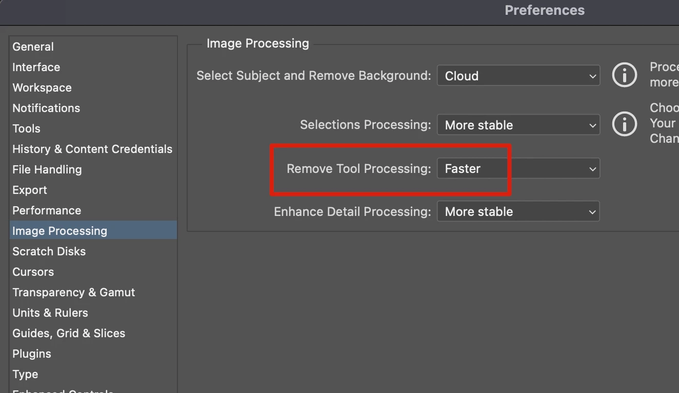

I confirmed that “Use Graphics Processor” is enabled in Photoshop.
I checked the Remove Tool / Image Processing preferences.
I confirmed that the Remove Tool setting is set to “Faster”.
I also checked the “more stable / safer” setting path and switched back as needed.
I restarted Photoshop after changing the setting.

    m3 max with 64gb of ram with 16 cores and remove on device won't run on my machine, why?  done all the usual added all the add ons and still greyed out

    do this:
    June 1, 2026
    the standard things where all tested.
    please take a look in my system prefrences.
    nearly all affected users has rested their adobe preferences to avoid a wrong preferences option.

    Hey, ​@Matthias.G.ermany. Thanks for adding the system info. I’ve copied it over from Photoshop Beta. The Device drivers aren’t read by Photoshop correctly.
     Driver date:                  UNKNOWN
          Driver age:                   UNKNOWN
          Driver version:               UNKNOWN
    Could you try these steps:
    1. Set up the default GPU for Photoshop: https://community.adobe.com/t5/photoshop-ecosystem-discussions/set-up-gpu-for-high-performance-in-photoshop-quick-tips/td-p/13504734
    2. Ensure there are no stale preferences in your Photoshop. Go to the location of the preference folder below and rename it to backup.
    • Windows 10/11: Users/[user name]/AppData/Roaming/Adobe/Adobe Photoshop [version]/Adobe Photoshop [version] Settings
    • You can press Press the Windows key > Enter 'Run' > Enter %APPDATA%\Adobe
    • Rename the Adobe Photoshop folder by adding a .old at the end. (Adobe Photoshop 2026 > Rename > Adobe Photoshop 2026. old), You can restore these preferences later if needed.(https://adobe.ly/4860qM9)
    • Restart the computer.
    These changes will provide a fresh start to Photoshop, much like a new installation.
    Let me know how it goes.
    Thanks!
    Sameer K
    (Type '@' and type my name to mention me when you reply)
    May 26, 2026
    today i switch from the game ready driver 596.49 to the newest studio driver 61.47.
    doesn't help. i delete the appdata roaming folder more then two times last week. and now after driver new! installation, no effect. sniffer says everthing is fine.
    my user folder name “matth” without any blank or special letters like ö,ä, ü.
    windows is in german
    chatgpt means the sniffer entries show the issue:
    I have attached the full Sniffer output for my system (Windows 11, RTX 5080, Photoshop 27.7). The GPU is fully detected and works correctly for standard Photoshop acceleration.
    However, the Sniffer shows inconsistent GPU classification in the AI/Device qualification layer:
    • Direct3D layer: Power Envelope = UNKNOWN, Attachment = UNKNOWN
    • OpenCL layer: Power Envelope = DISCRETE, Attachment = UNKNOWN
    • Photoshop System Info reports the GPU as “NVIDIA GeForce RTX 5080 UNKNOWN”
    Despite correct detection, VRAM (~16 GB), and full GPU acceleration being enabled, the On-Device Remove Tool remains unavailable (Device option greyed out).
    This suggests a GPU classification/qualification issue in the AI inference device layer for RTX 50-series (Blackwell), rather than a local configuration problem.
