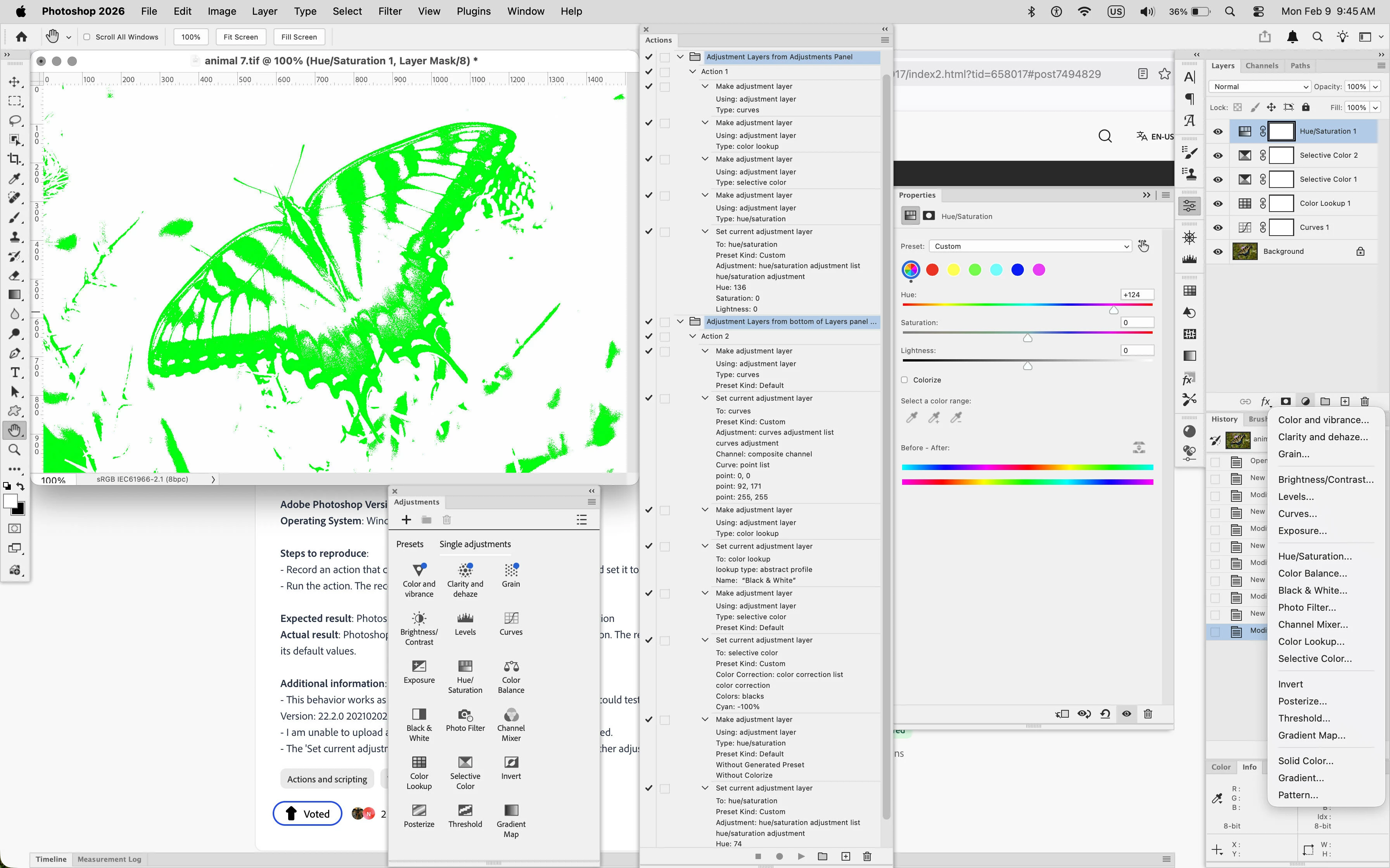

Jeff Arola
February 9, 2026
bellevue scott,
From which source are you using the Adjustments Layers to record your actions?
Is it Window>Adjustments, Layer>New Adjustment Layer or the fly-out menu from the bottom of the Layers panel?
Using the Adjustments Panel must be the missing piece and why i couldn’t replicate the issue?
I was using the Layers Panel and the Layer>New Adjustment Layer menu.
If i use the Window>Adjustments then i can easily replicate the issue, however if i use either Layer>New Adjustment Layer or the Adjustments Layer menu at the bottom of the Layers panel all the steps are recorded.
In my test screenshot below the top set of actions were recorded using Window>Adjustments
and the outcome was as davescm got, however, the second action set recored from the bottom of the Layers menu seemed to record all the adjustments.
