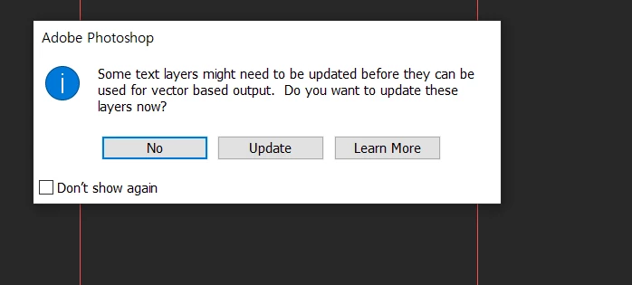

I have identified a bug. I noticed that a new feature was when you use the text tool and type
1. text
2. text
3. text
this triggers auto numbering.
Well it took me four hours to figure out this is what was currupting my files and it is very repeatable
When you try to reopen the file, it says a problem wont allow it.
The auto numbering in text tool had been working ok without file corruption until very recently.
If I paste a list in text tool with numbers alread in place, it corrupts the file
if I start inserting numbers before a list in the text tool, it corrupts
my work around is this:
I type or paste this:
text
text
text
to create a numbered list i do this:
t1. ext
t2. ext
t3. ext
than i backspace to remove the first letter to create my desire:
1. text
2. text
3. test
the auto numbering feature either needs to be removed or fixed
under any circumstance, this feature if fixed, needs to be able to turned off, as it often interfers with work flow
to fixe the corrupted file that was unworkable, i had to open the file on another computer, and delete all text layers that showed a triangle with an exclaimation mark inside. once that was done, i could save and reopen the file. but if I added numbered lists with the text tool, it looked fine until I closed and tried reopening the file, then disaster. it was unworkable.

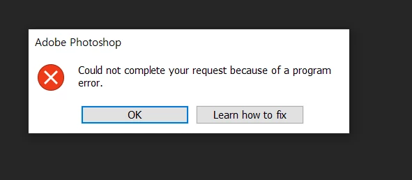

Hello
I have a problem with my Photoshop app. Everytime I open a file containing images and texts, a pop up appears saying: "This action cannot be performed because of a program error". The same happens when I manage to open copies of this file, but they tell me that I have to update the text layers, which I proceed to do but some layers don't update themselves and when I try to update them manually, the same pop up appears with: "This action cannot be performed because of a program error". I have tried the fixes suggested by Adobe, but none of them unfortunately fix the problem. Do you know of any other way I could try to fix this issue? It only applies to files with texts and images but this has never happened before.
Thank you for your help!

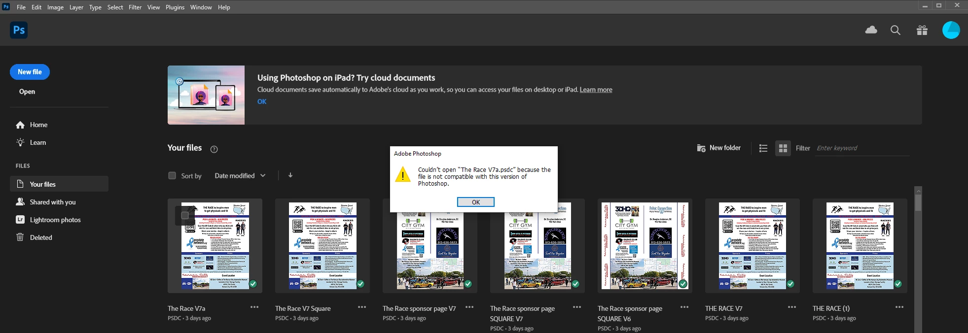

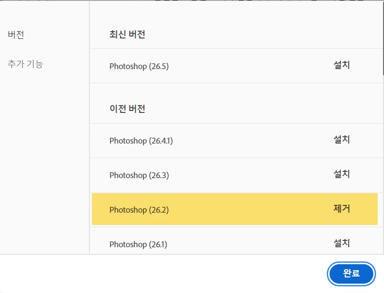

April 1, 2025
After today's photoshop update, the photoshop file I worked on yesterday will not open from today. (Problem file: file combining illustration and text) (Photoshop update 26.5 version)
Lowering the version opens files that were not opened without problems.
(Photooshop 26.2 version down)
The same error occurs when I open Photoshop after updating it again.
Is there a way to solve it?

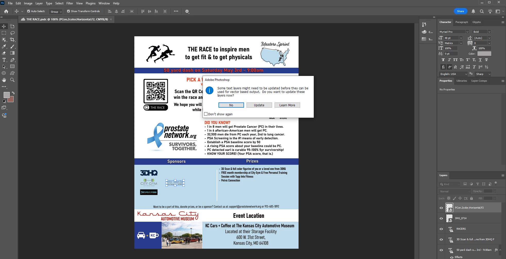

March 31, 2025
This is happening to me right now and I'm saving it on the cloud. I save it and then almost immediatly it does not open back up. Also the files I am able to open says I need to update the text layers and I do but then when I click on any of the text that that had issues, the program freezes and shuts down completely.   Why is this happening and how can it be fixed?
mglush
March 31, 2025
Hi!
We are so sorry to hear you are having this problem. What version of Photoshop are you using? And do you know what version of Photoshop the files were built in? Do you have any Postscript Type 1 fonts in your document? If it is a version of Photoshop 2023 or newer, Photoshop will not play nice with Type 1 fonts and they will need to be changed to OpenType or TrueType.
Let us know what version of Photoshop you are running?
Michelle

TEMP SOLUTION: if you have a corrupted file. just open it. update layers. then look in your layers. delete any layers that have a caution triangle. save as a new file name, so as not to destroy the original
