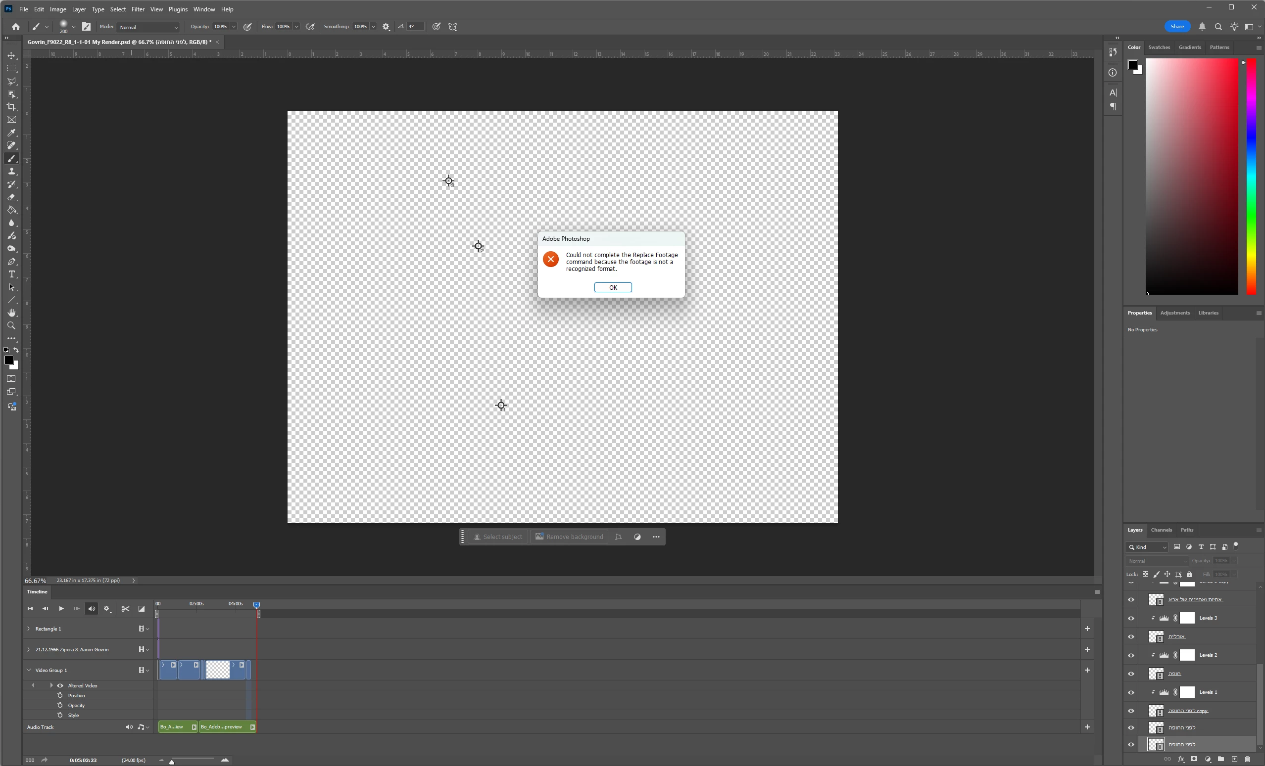

AmnonGAuthor
Jan 18, 2025 6:49 PM UTC
Do I need to do this for every piece of the video? Note all video layers are actually the same video file, just a different piece.
It would be far better if Photoshop noted it can't find the video and ask for it rather than load the file silently. Furthermore, if it recognized multiple video layers are pieces of the same file (the path is the same) and ask once.
Regardless, when I pick one of the video layers and go to Layer > Video Layers > Replace Footage, then pick the file (the same file I sent you) I get the following error. I am attaching the entire Photoshop window so you can see I have a video layer selected in addition to the error message in the middle.
