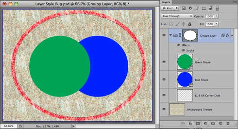

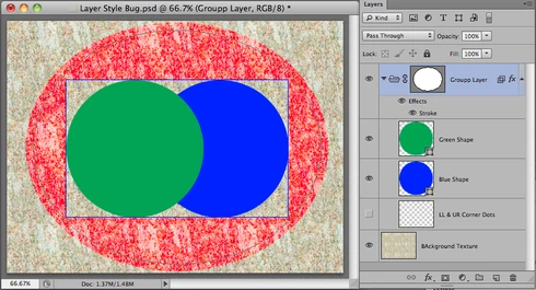

Here is a simple example with Transparency Shapes Layer unchecked using Stroke-Outside Layer Style Option (Note: Light blue rectangle is from the View > Show > Layer Edges begin enabled)
Layer Style Expected
Layer Style Showing Bug
Observed Bug Conditions to have Layer Style generated incorrectly
1) Group Layer has Transparency Shapes Layer unchecked
2) Group Layer/Vector Mask is used to define the Group Layer Shape (bug also occurs when there is no Group Layer/Vector Mask as well)
3) The Group Layer Edges (as determined by the contained Layers in the Group) fall within the Group Layer/Vector Mask area.
In the above example, in the top image, the Group Layer Edges are the same as the document edges as set by the "LL & UR Corner Dots" Layer.
In the lower image the Group Layer Edges are being determined by the boundaries of the Blue and Green Circles (corner dots Layer turned off).

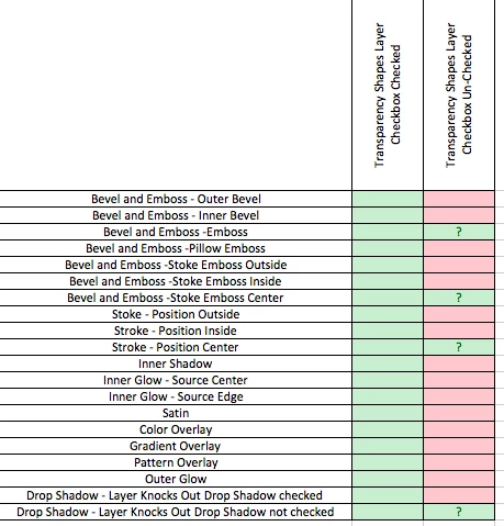

Here is a table indicating where I have been able to create incorrect formation of Layer Styles (marked by Red) so far.
From a more detailed examination it appears that when Transparency Shapes Layer is turned off, that the Shapes in the contained Layers in the Group are still influencing the Group Layer Shape and specifically, it is being influenced by the the rectangular Group Layer Edges.
