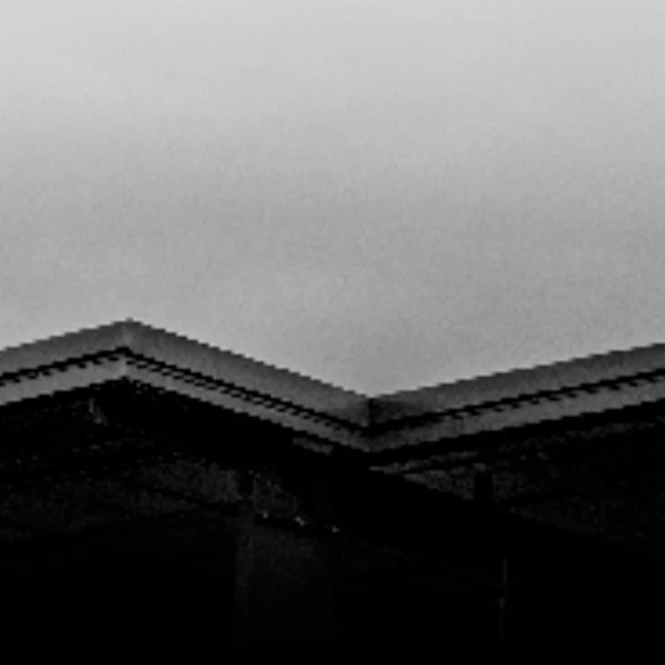

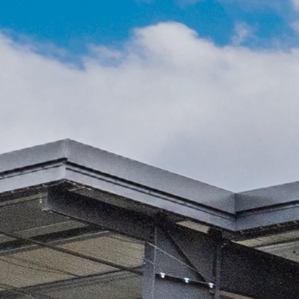

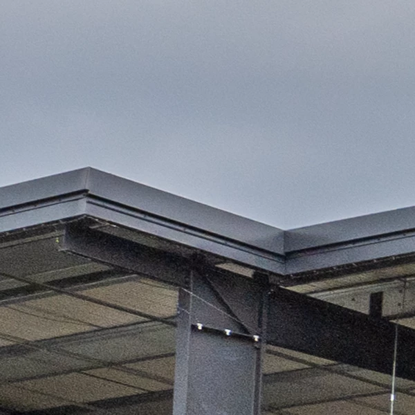

I'm getting consistent masks with jagged edges with Sky Replacement.  See attachments.  I've tried various kinds of photos and getting the same results (not just images with angled edges).  The photos are approx 8000x5000, RGB files.
PSD 23.2.2
Mac OS Monterey

Thanks for the reply, Jeffrey.  I didn't realize that the extreme stairstepping in a mask's hard edges is actually a result of the Fade Edge setting at its default of 100.  Even at 50, there is still quite a bit.  So, for any kind of architectual shoot, I will definitely be using a Fade Edge setting of ZERO.  😉
Thanks again for looking in!
