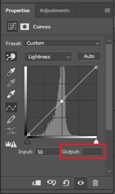

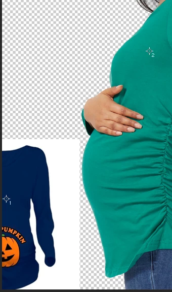

I am using LAB and curves to do some color matching with images and have run into a strange problem. It should be noted that I have been working on a ton of images over the last few days using the same method and haven't had this problem before. This is the first time I have tried to do this since updating Photoshop this morning. I'm also using the most recent version.

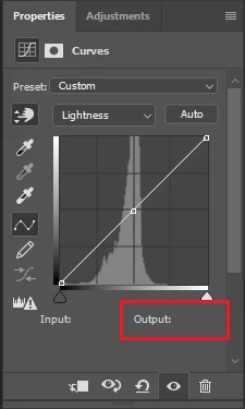

I make my selection that I wish to alter and create a curves adjustment layer. Shift+Ctrl click on the second color selection. With that color point selected in the curves dialogue box, I click on output to change the number but the box disappears. I then click that point again to select it, the box appears again, and when I click the box to type in a number the box disappears again.

I had the same problem, unable to enter output value. Going to post my fix here in case others come here looking for solution as I did (and not wanting to reset everything)... so it appears to be bug from the properties tab being of a certain size and/or location. Move it about, first try placing properties back into the right side bar. If that doesn't work make it separate again and make the window really large. After doing that I have it back pretty much where it was originally and output still available.

What I'm seeing is the hit area is touchy. If the i-bar is visible but near the top or bottom of it's hit area it will dismiss the edit field.
