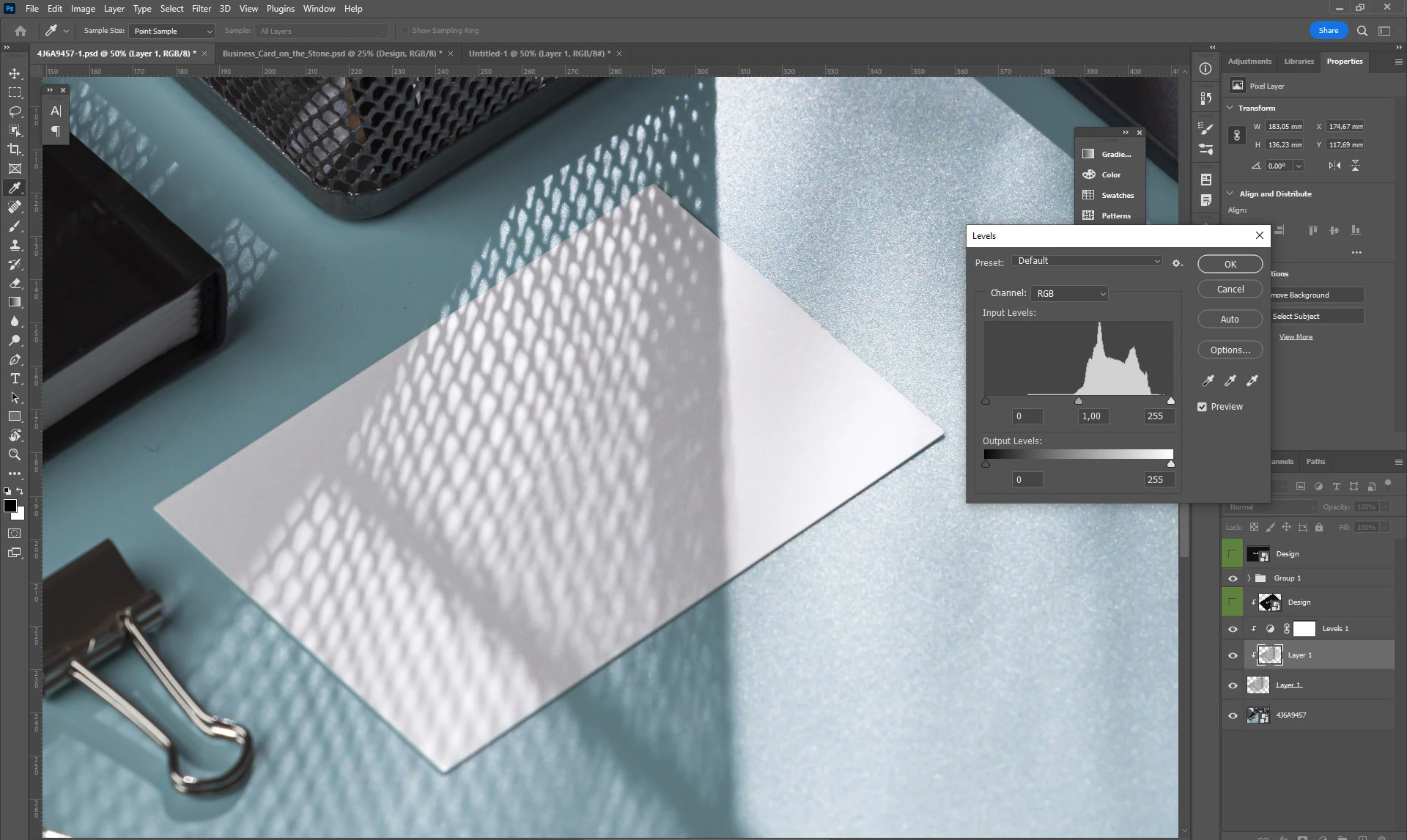

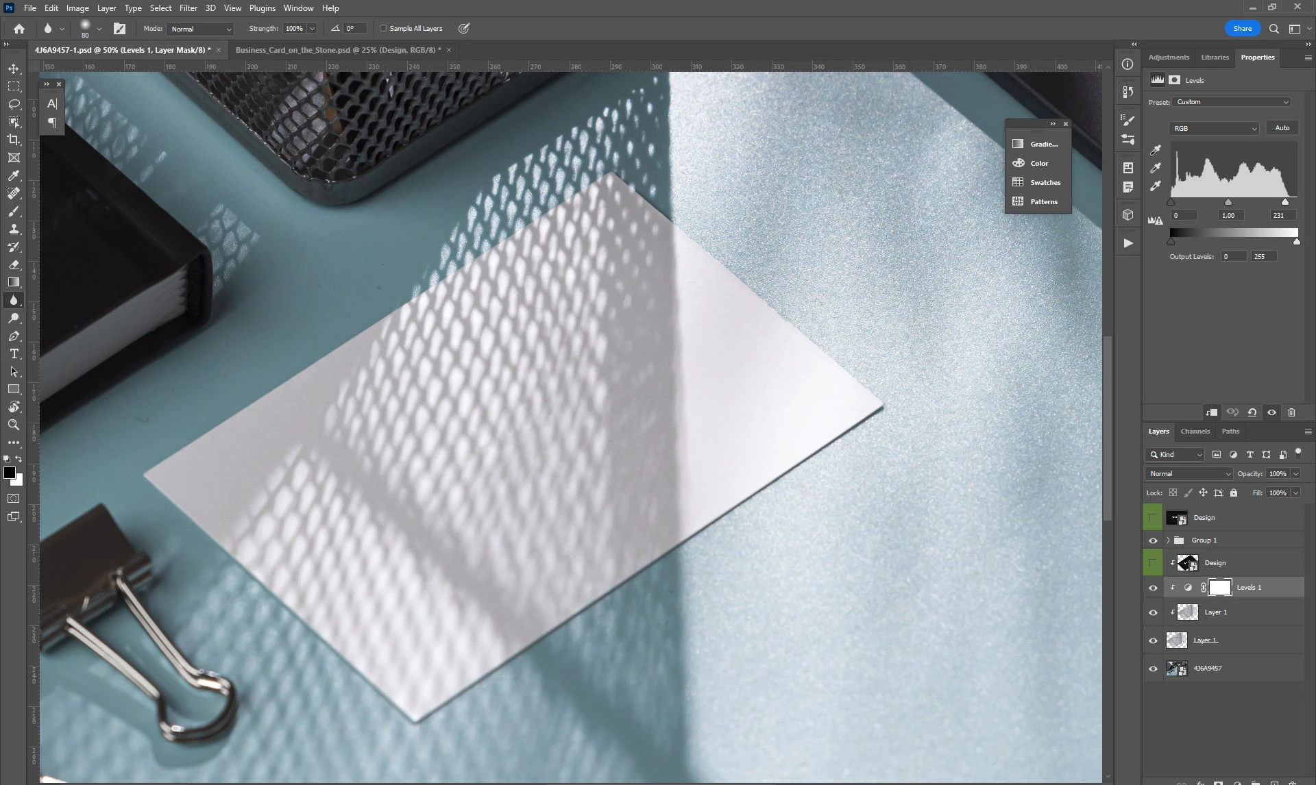

Below is an image with Levels Ajdustment Layer that is clipped inside a layer. As you can see, the histogram for this adjustment layer is for entire image.

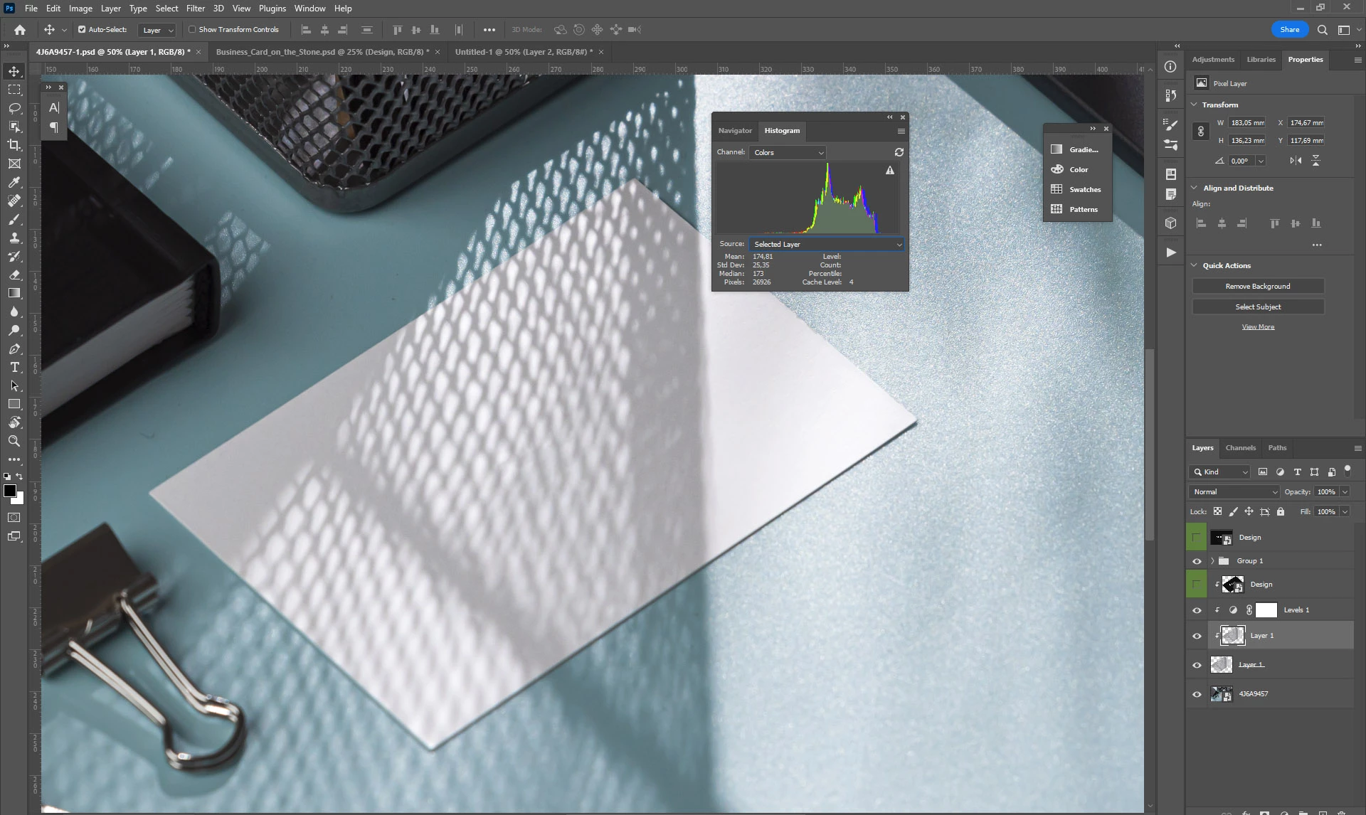

When I select a layer below and use levels on it, the histogram is correct because it only applies to that layer. As in the picture below.
It looks as if someone from Adobe developers has switched the histogram display mode for clipped mask adjustment layers from Selected Layer (in the image below) to Entire Image.
I don't know, maybe there is a deeper sense to it. But I know that whenever I use Level or Curves Adjustment Layers, it's actually really hard to use them because I don't have a preview of the correct histogram. Oddly enough, in Photoshope CS 6 everything was and still is OK 🙂
