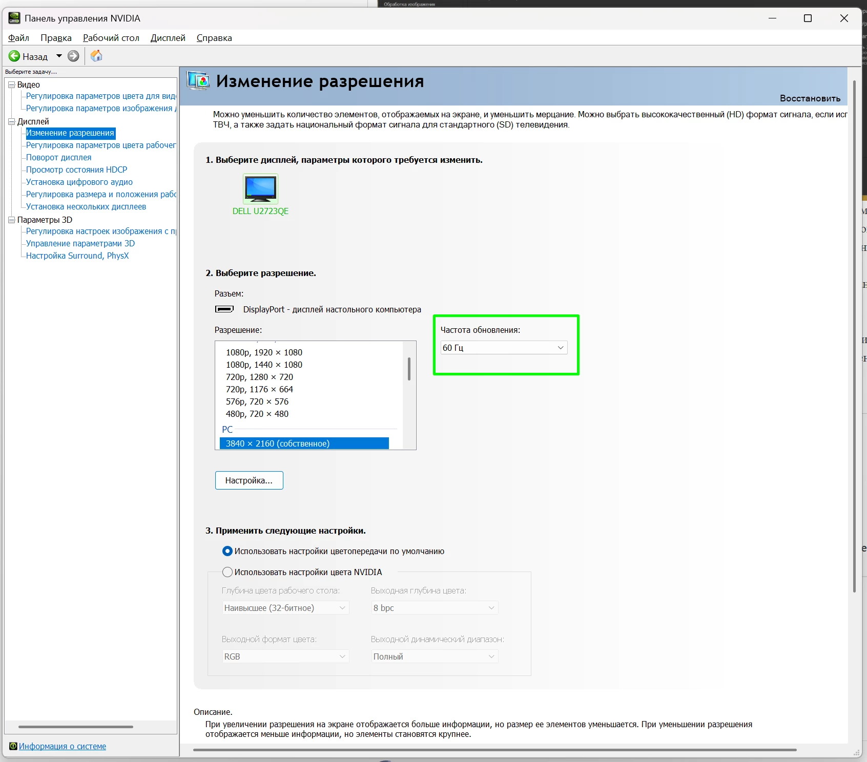

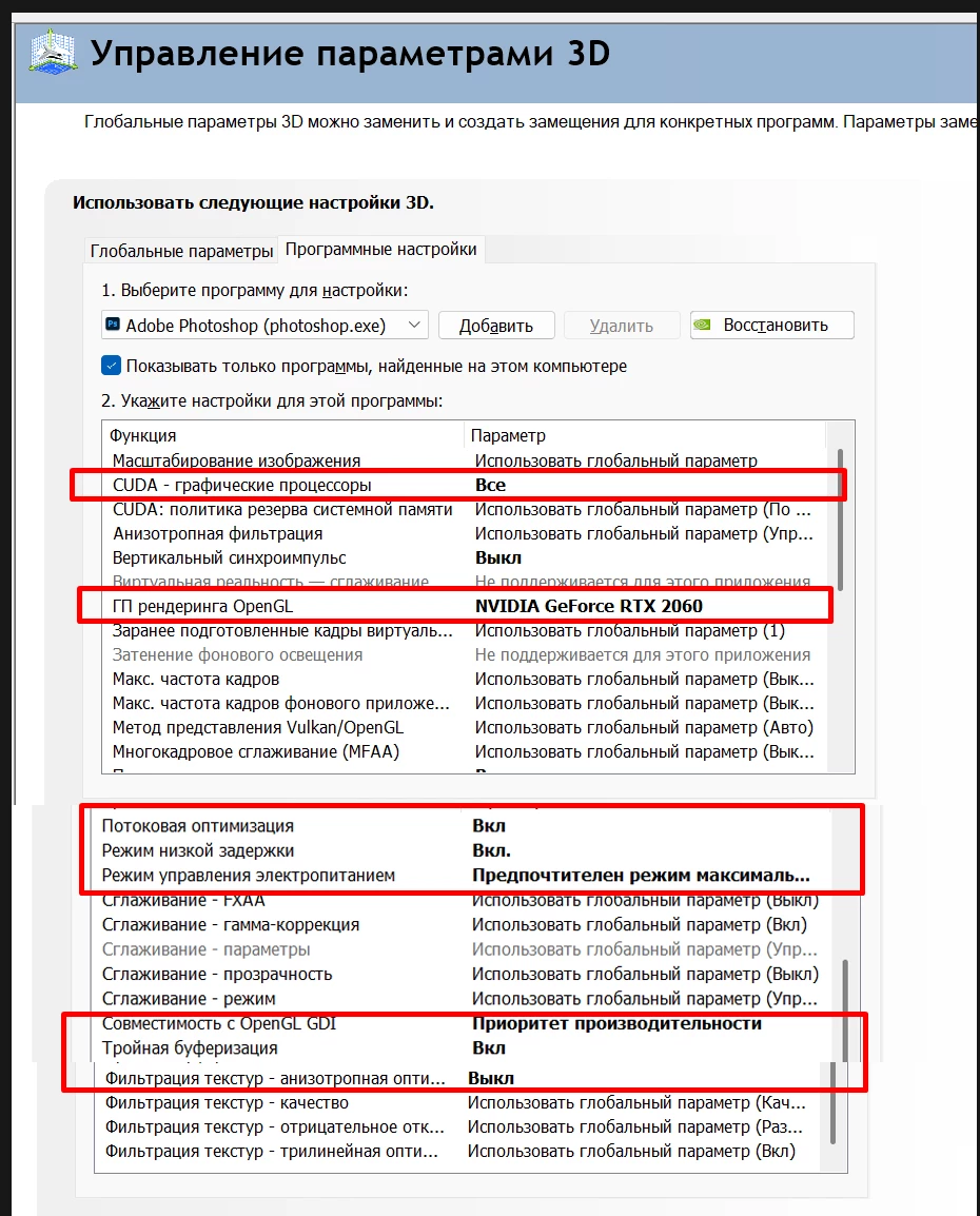

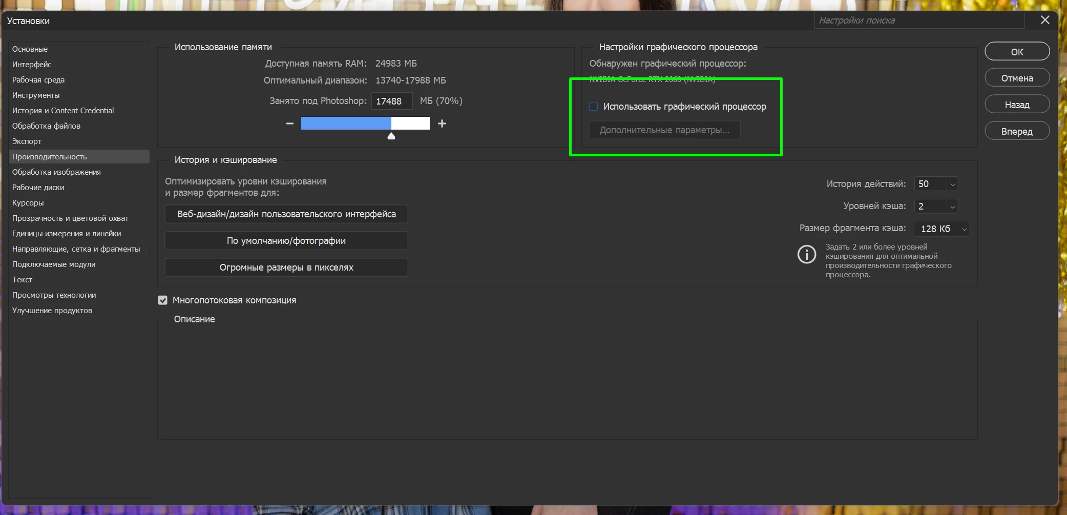

Hi. I have solved the problem of brush “freezing” in the Liquify filter. Maybe this will help someone.
I have Windows 11, computer i5-13600K + 32 GB RAM + RTX 2060 + Dell U2723QE monitor.
1. In the performance settings, you should have “Use GPU” active
2. The maximum refresh rate of the screen is set. I have it set to 60Hz.
3. In NVIDIA control settings under “Manage 3D settings” corrected the program settings for the Photoshop program.

I made similar settings in the NVIDIA control panel for Lightroom.

Привет. Для себя решил проблему "зависания" кисти в фильтре Liquify. Возможно это поможет кому-то.
У меня Windows 11, компьютер i5-13600K + 32 GB RAM + RTX 2060 + монитор Dell U2723QE.
1. В настройках производительности должна быть активна функция "Использовать графический процессор"
2. Установлена максимальная частота обновления экрана. У меня это 60Гц.
3. В настройках управления NVIDIA в пункте "Управления параметрами 3D" произведена коррекция программных настроек для программы Photoshop.

Аналогичные настройки в панели управления NVIDIA я сделал и для Lightroom.

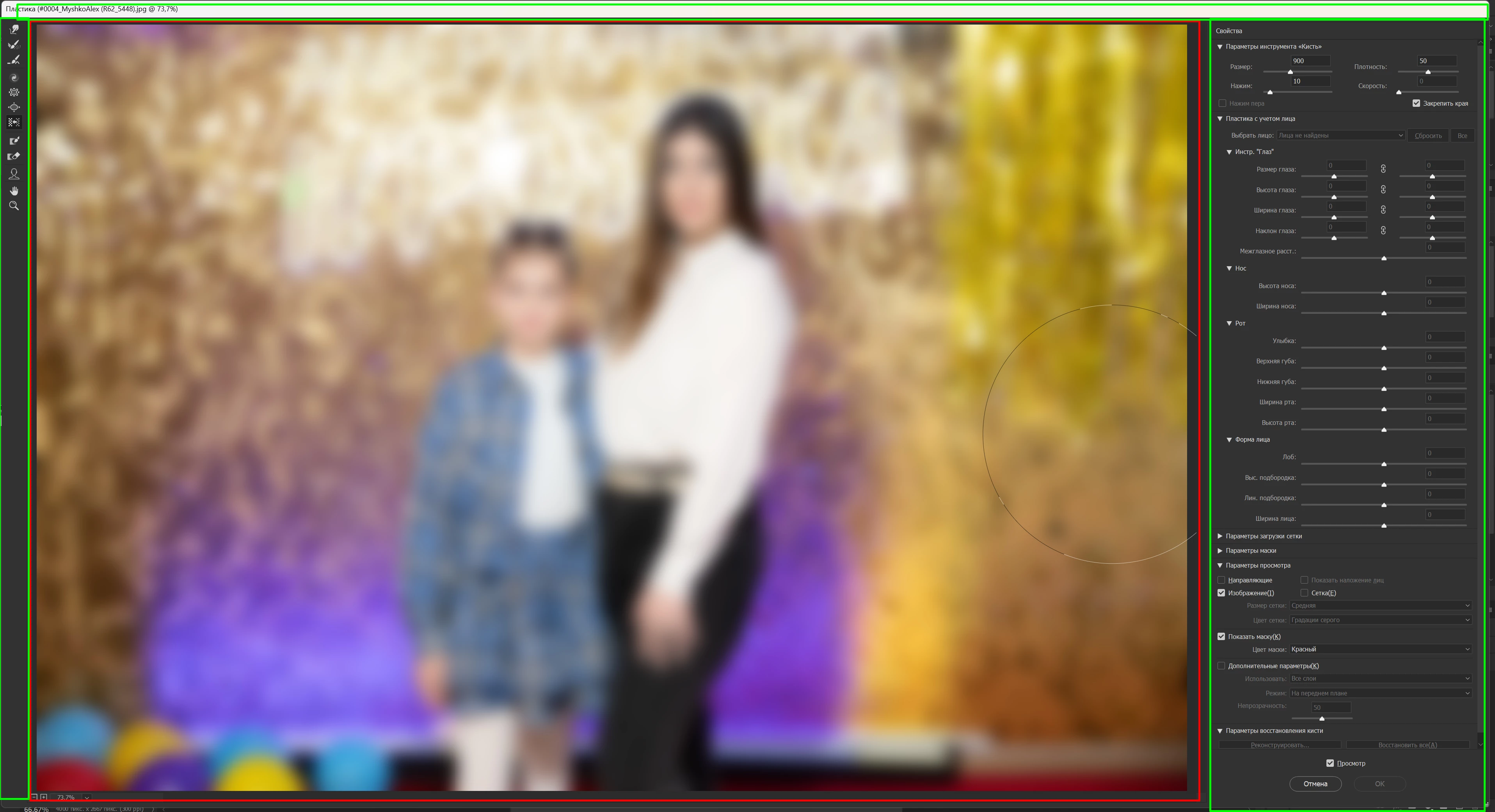

April 6, 2025
---ENG
Hi. It's 2025 and the problem is still there and not solved. I have Windows 11 and a pretty good computer. i5-13600K + 32 GB RAM + RTX 2060.
When working with the Plastic filter (Liquify) the brush slows down. The brush slows down and “twitches” both when moving the brush across the image (the area is marked with a red rectangle) and when zooming in/out on the brush.
When you move the brush over the settings panel (the area marked with a green rectangle), the brush moves at normal speed, smoothly and without “jerks”. If you select the Face, Hand, or Scale tool, the brush also moves normally across the entire workspace. If you select the adjustment tools, the brush “slows down”.
Adobe, when will you solve this problem?
I have reinstalled all drivers and tried several options.
The problem is most likely related to the use of the video card.
If you disable video card support, the brush in the Plastic filter starts working normally in all modes. But in this case a number of other problems and inconveniences appear when working with Photoshop. Among other things, the image appears “jerkily” and in parts in the Plastic filter, and the image “jerks” when zooming in.
The described solution for Mac owners did not help me personally. Moving the cursor to the top of the Photoshop screen and pressing the “shift+ctrl+x” shortcut keys did not work for me. The brush is still “twitching”.
The only thing that helped was changing the refresh rate in the NVIDIA control panel. This action did not solve the problem completely, but at least now you can work. I had the refresh rate set to 30Hz, I changed it to 60Hz (which is my maximum refresh rate). The monitor is a Dell U2723QE.
Translated with DeepL.com
----RUS
Привет. Уже 2025 год и проблема по прежнему актуальна и не решена. У меня Виндовс 11 и достаточно хороший компьютер. i5-13600K + 32 Гб ОЗУ + RTX 2060.
При работе с фильтром Пластика (Liquify) тормозит кисть. Кисть тормозит и "дергается" как при перемещении по изображению (область обозначена красным прямоугольником), так и при увеличении/уменьшеии кисти.
При перемещении кисти по панелям настроек (область обозначена зеленым прямоугольником), кисть движется с нормальной скоростью, плавно и без "рывков". Если выбрать инструмент "Лицо", "Рука" или "Масштаб", кисть также движется нормально по всему рабочему полю. При выборе корректирующих инструментов, кисть "тормозит".
Адобе, когда вы решите эту проблему?
Все драйвера переустанавливал и перепробовал несколько вариантов.
Проблема скорее всего связана с использованием видеокарты.
При отключении поддержки видеокарты, кисть в фильтре Пластика начинает работать нормально во всех режимах. Но в этом случае появляется ряд других проблем и неудобств при работе с Фотошоп. В том числе, в фильтре Пластика изображение появляется "рывками" и частями, при увеличении изображение "дергается".
Описанное решение для владельцев Mac мне лично не помогло. Перевод курсора вверх экрана Фотошоп и нажатие быстрых клавиш "shift+ctrl+x" у меня не сработало. Кисть по факту "тормозит".
Единственное что помогло, это изменение частоты обновления экрана в панели управления NVIDIA. Это действие не решило проблему полностью, но хотя бы теперь можно работать. У меня была установлена частота 30Гц, изменил частоту на 60Гц (у меня это максимальная частота). Монитор Dell U2723QE.
Возможно это кому-то поможет.
