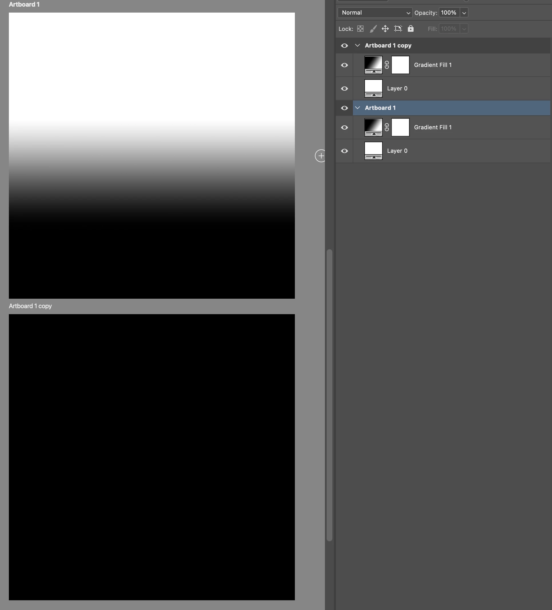

Thank you for your reply, but the Artboard issues have been around for years, and they still make Photoshop frustrating to work with. Are we expected to wait another 2–3 years before Photoshop finally catches up with the competition, where this works smoothly?
I'm aware of the temporary workaround, but it also slows down my workflow and isn't a 100% reliable solution.
Regarding gradients, you should try copying an artboard that contains a gradient and then moving it. The gradient becomes completely distorted. I've attached a screenshot showing the issue.
gradients

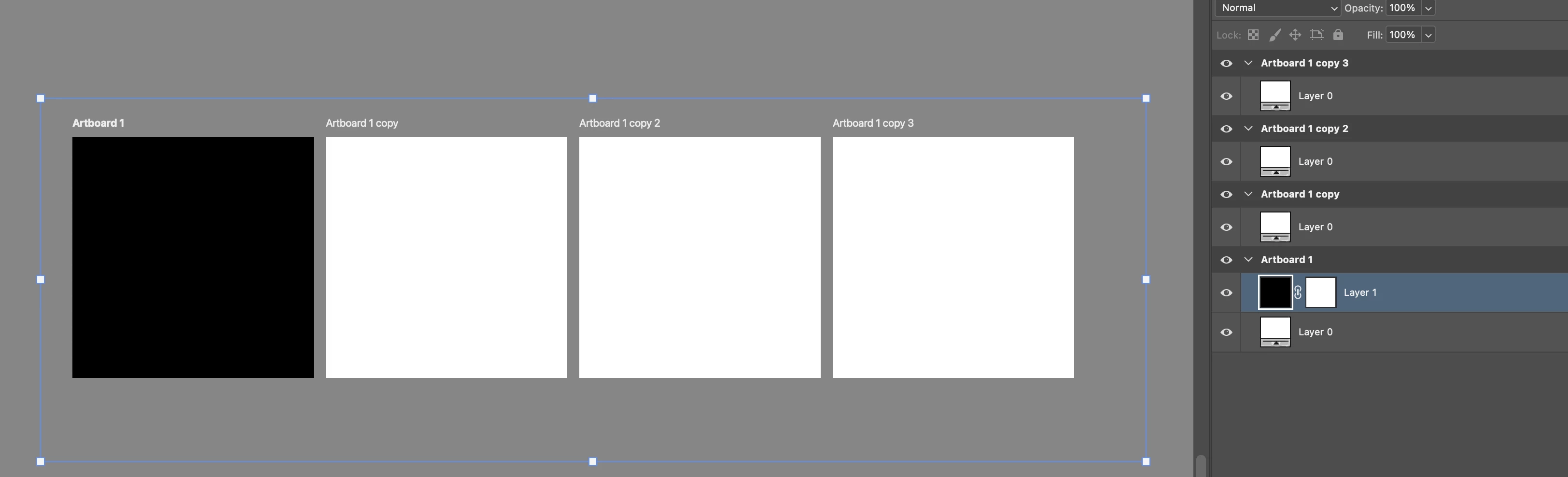

Regarding clipping masks, if you fill the background of an artboard, the fill is not limited to that specific artboard. Instead, it extends across all artboards, including the clipping mask.
