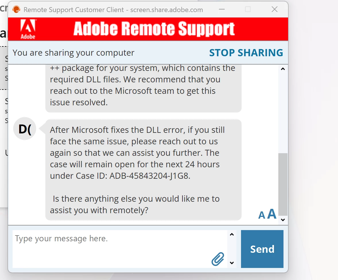

    I can only disable if any app opens
    (was working last week, This happened first on my desktop with an nVidia card … fixed after multiple restarts / reinstalls) … now on my laptop but only working version now there is a 1 major version number lower)
    The laptop is a Samsung Book 6 Ultra with a intel CoreUltra X7 (358H onboard B390GPU), 32 GB ram
    Refer screenshot to what Adobe has to say
    ALSO (from 26.11.6)
    Pass:    DirectX available Pass:    DirectX feature level 12.2 available, feature level 12.0 required Pass:    Above required VRAM (19320 MB of 1500 MB required) GPU Detected: Intel(R) Arc(TM) B390 GPU (INTEL)
