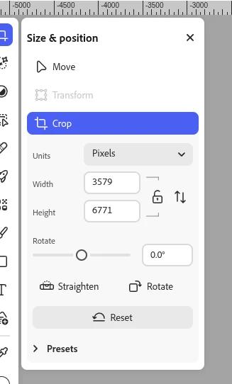

Thanks - I can't see that option - I'm using the web version of PS
Srishti_Bali
Jan 19, 2026 6:43 PM UTC
Hi @simon_8034
Thanks for reaching out. Please click on Presets, and you will see all the options.

The crop tool will do that. Go to the box at the top left of the options bar and you can select Ratio or W x H x Resolution. Resolution can be in ppi or ppcm.
Dave
Jan 17, 2026 7:37 PM UTC
Thank you - I undestand the concept of PPI;  however there is no PPI value in the crop tool - it just shows an arbitrary number of centimetres.  I understand it is using a PPI to calculate the size in CM but what value is it using?  It's not the value used in the Image Size menu item (which would make sense to me).
I can work out how much to crop in pixels by taking the dimensions in CM from image size and the PPCM, using a calculator to work out the crop in pixels, going back to the crop tool and using pixels (not the random CM number) and then doing the crop.
It would be far simpler if the crop tool had an explicit PPI/PPCM value - using a different number that the user can't see looks like a bug to me.
