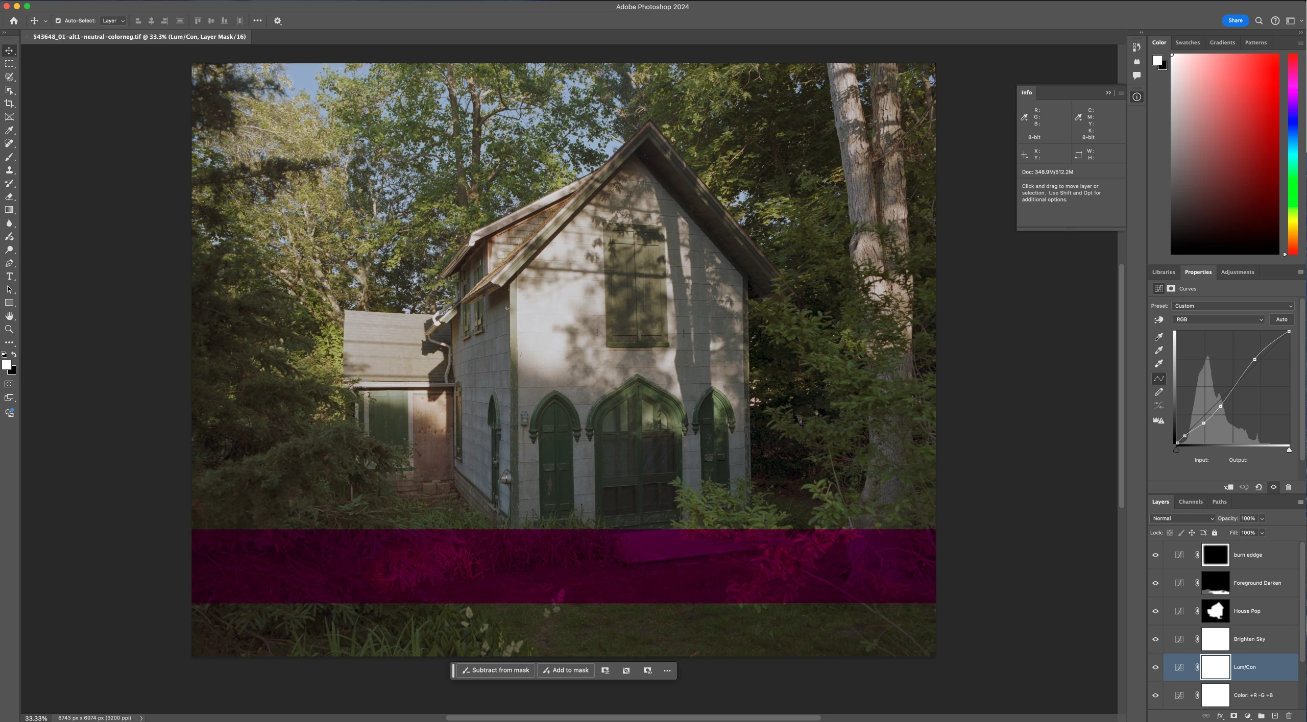

Purple band suddenly appearing on layered TIFF files
While working on a scanned photograph as a layered TIFF in Photoshop, a large purple band suddenly appeared on the file. Hiding/showing layers does nothing to remove it--only when I hide the Camera Raw Filter layer does it change, but the band just becomes larger. Is this a file corruption or something else? Incredibly frustrating as I've been working on this image for a while, and I can't find a way to remove it.
Using Photoshop 2024 in Sonoma 14.6.1.

Aug 26, 2024 1:19 PM UTC
The big problem with external drives is connection stability. External drives get kicked around, and cables and connectors inevitably get worn and increasingly loose-fitting. It only takes a nanosecond broken connection to corrupt a file.
In addition you have an extra layer of USB drivers and protocols, making the save process much slower and vulnerable to random errors.
https://helpx.adobe.com/photoshop/kb/networks-removable-media-photoshop.html?x-product=Helpx%2F1.0.0&x-product-location=Search%3AForums%3Alink%2F3.4.0
Generally, when using external drives, handle with care. Don't touch it while data transfer is in progress. Replace cables regularly.
Kevin Stohlmeyer
Aug 26, 2024 1:10 PM UTC
@defaultyfk3qa3z1x64 too late in hindsight but its recommended to never save directly to an external source - drive, server, cloud service etc. Always save local and drag over to store. Sorry.
Aug 26, 2024 12:49 PM UTC
Agh, bummer. I'm saving directly to an external drive. Perhaps I should work on the file locally?
Not the worst news, as I can copy over my layers to the original scan (unless there's any corruption connection there).
D Fosse
Aug 26, 2024 4:53 AM UTC
That looks like file corruption, which is always caused by failing hardware.
Are you saving directly to an external drive, or over a network connection?
